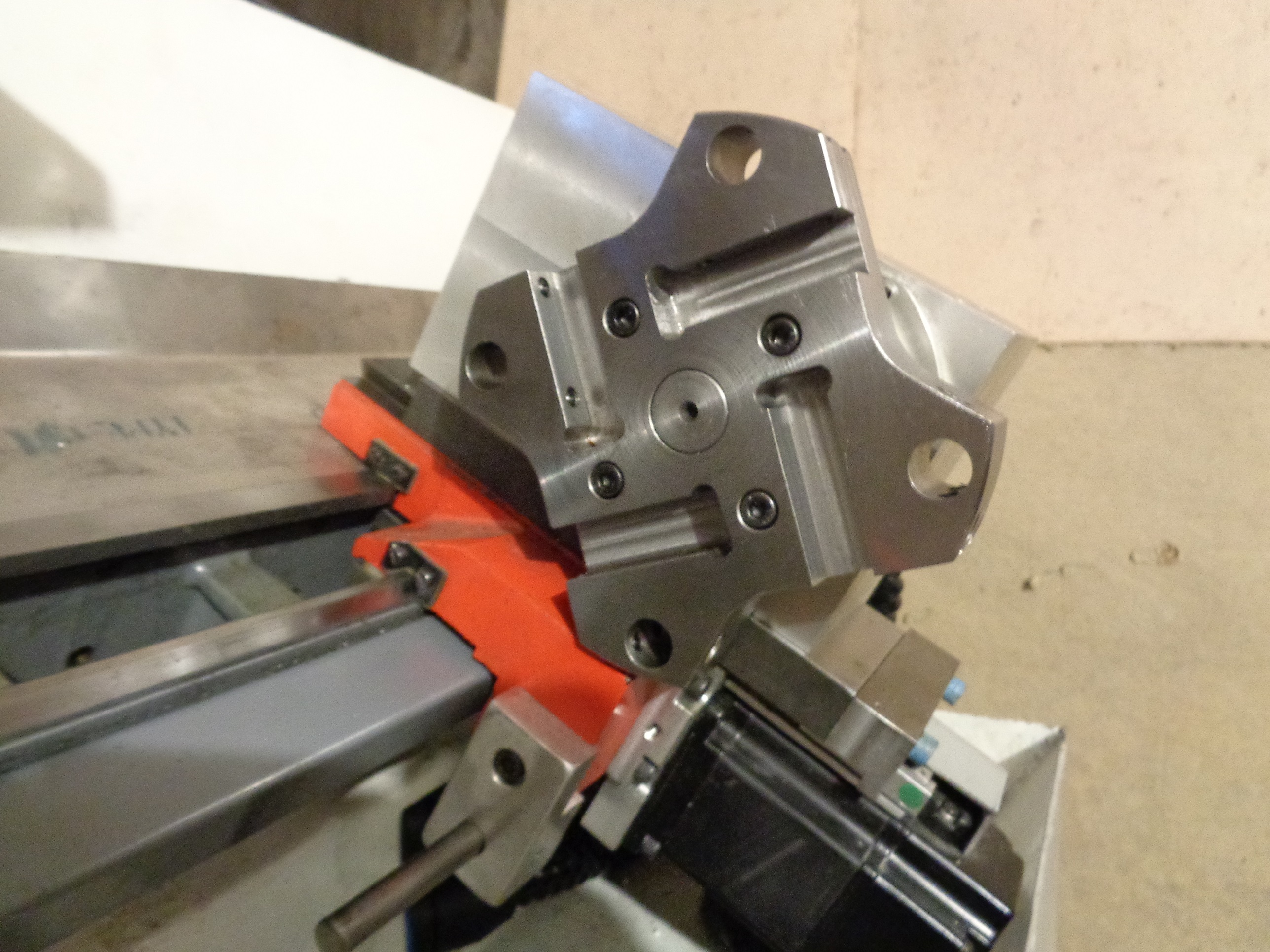

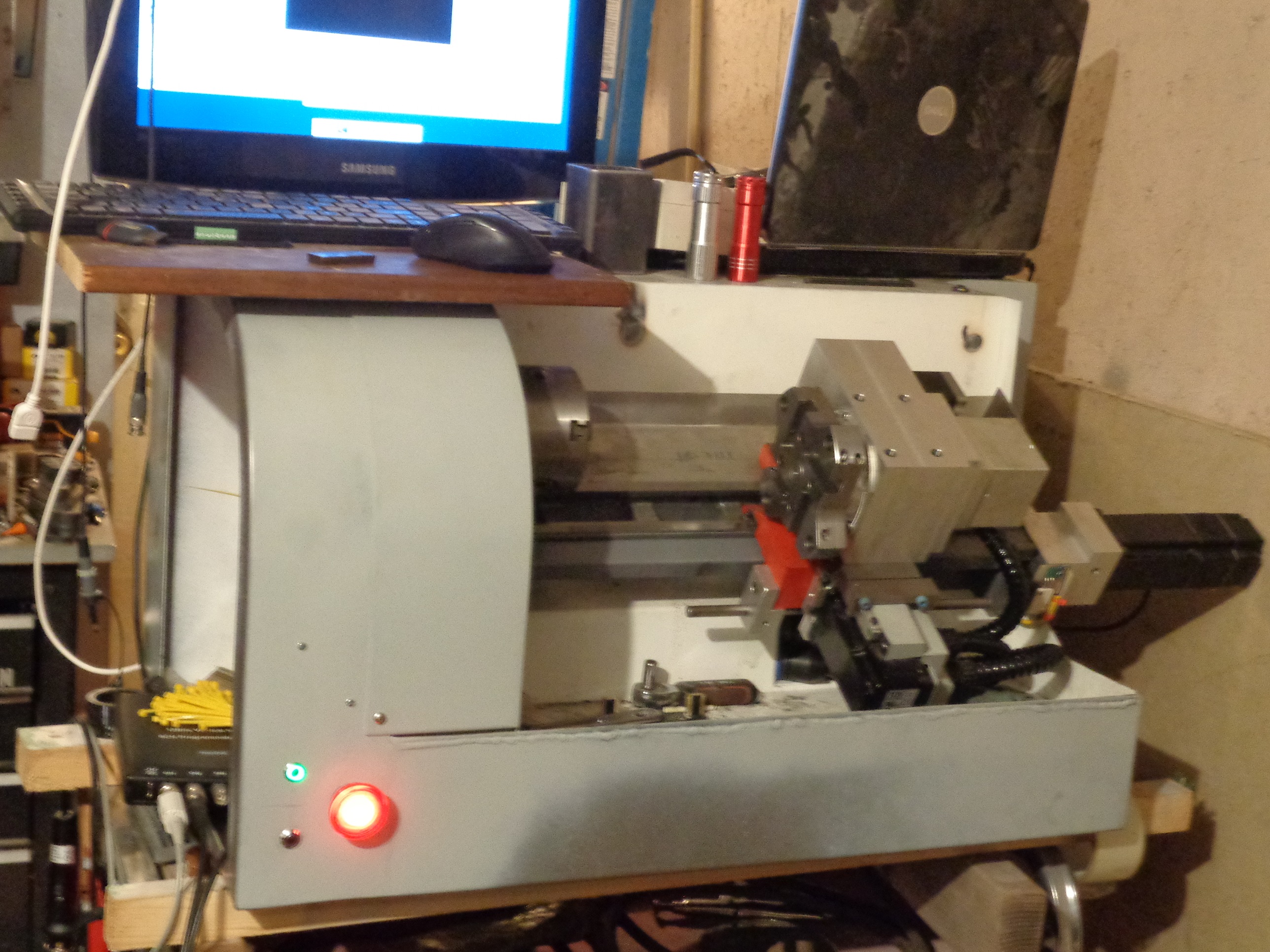

I am finally finishing the modifications to a EMCO compact5 lathe. The software was updated to 2.7.15 which updated without any problems. My problem is that I do not understand the touch off to fixture and subsequent touch off to work to set G54. I need tool 2 to be the master for the offsets as tool 1 is a spotting drill and tool 2 will be turn/face.
Can I do this?
MarkD

Nice Turret WHY not 8 pockets as of 45DEG

There is no room for 4 more pockets.
