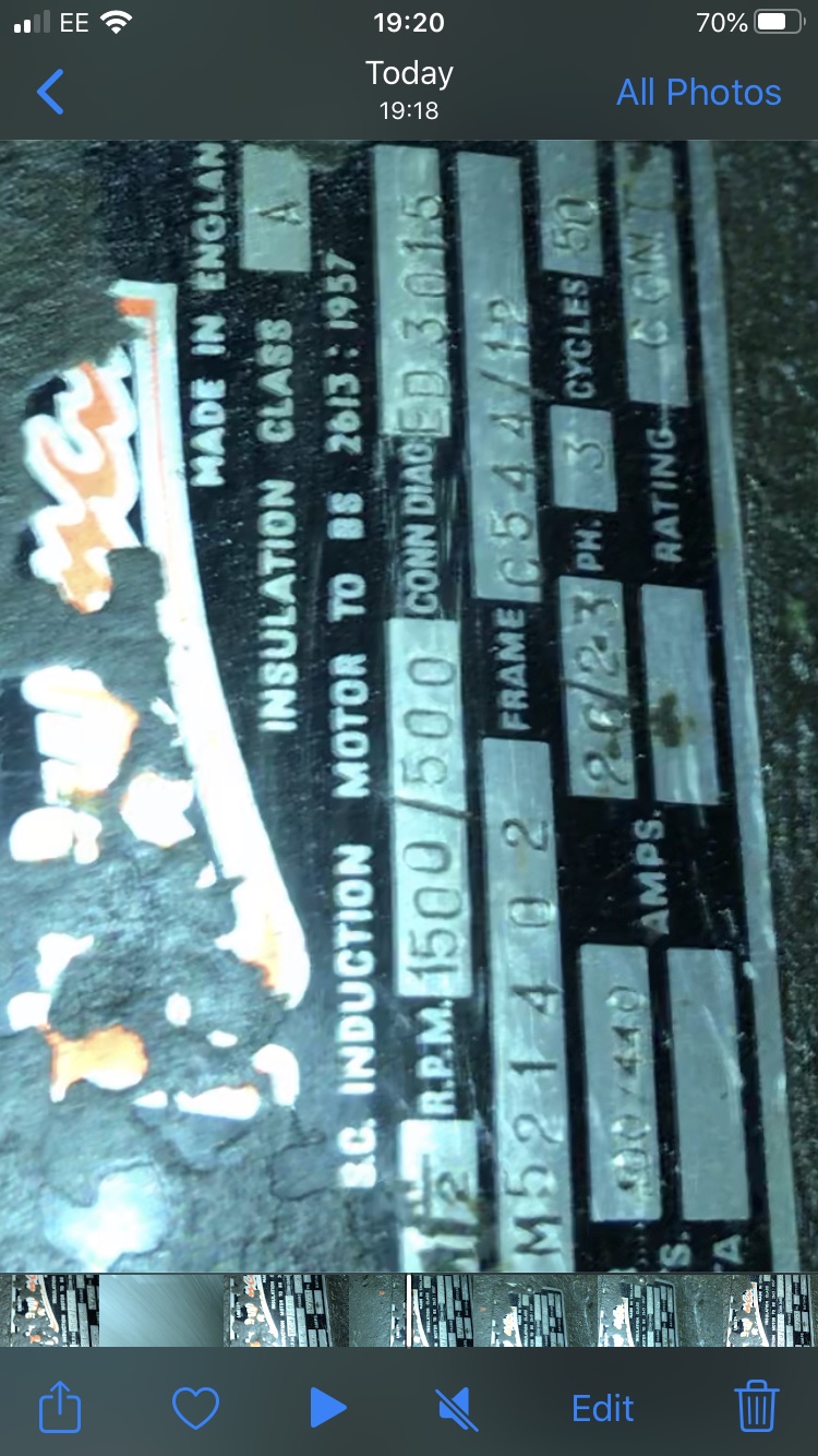

- jools
- Posts: 161
- Thank you received: 15
30 Mar 2020 11:14 #162098
by jools
Replied by jools on topic Hardinge HLV motor and speed control question
Motor plate attached.
inverterdrive.com/howto/240V-Supply-to-a-400V-AC-Motor/ is the link that said about running 440v motors at lower voltage.
Jools
Jools
- Posts: 7368
- Thank you received: 2181
30 Mar 2020 11:31 #162100
Replied by cmorley on topic Hardinge HLV motor and speed control question
By the name plate it seems to be a single voltage motor - if you open the motor wiring box on it if it has 6 or 9 wires then it surely can be wire for different voltage.
(but I'm not an electrician either)
Interesting read in the link - but it does make sense.
setting the frequency ifs basically what a vfd does.
According to that link you'll lose some power at full rpm -not a big deal for at home.
let the post sit for a bit and see if other guys with other experience chime in.

30 Mar 2020 22:54 #162178
Replied by andypugh on topic Hardinge HLV motor and speed control question
Is there a speed-change switch too? That motor plate seems to suggest 1500/500 rpm. ie it might be a Dahlander wound two-speed motor.
The advantage of the variable speed thingy is that you get increased output torque at lower speeds. Whereas with a VFD speed control you get lower torque at lower speeds.
If it's a Dahlander motor then rewiring for 240V is difficult, and it won't run nicely off of a VFD. Given that it is a 1.5hp motor and those aren't expensive I would be tempted to swap the motor for one that will run off 240V, but probably a three-phase with a VFD as three phase is just better. Then you could run at two different frequencies and keep the speed range using both VFD and variable speed unit.
