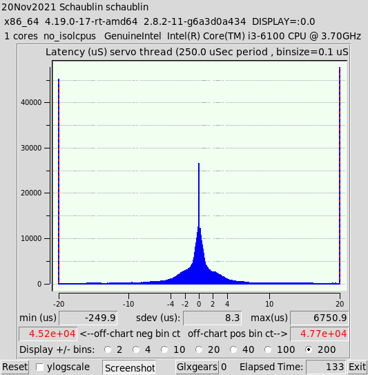

When I run the "start" I get hm2/hm2_7i92.0: watchhdog has bit! (set the .has-bit to False to resume)
But hm2_7i92.0.watchdog.has-bit is set to false when I show pins.
When I run the command
setp hm2_7i92.0.watchhdog.has_bit false
it returns
hm2/hm2_7i92.0:error recovery successful!
and the watchdog led stays lit.
Next I tried creating a config with PNFConf, and then deleted everything but the set up, (see attached HAL). This loads, but then I get the "watchdog has bit" as a Gmoccapy pop up meesage straight away.
it returns

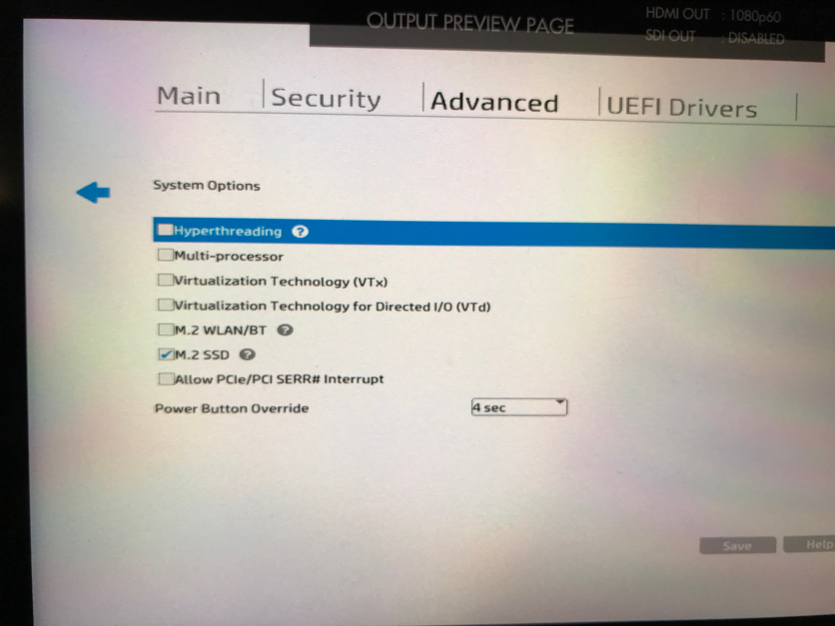

Replied by tommylight on topic Schaublin 125-CNC retrofit.
Looks that it is a latency issue, horrible does not do justice to explain that result!
Does it have hyperthreading?

20 Nov 2021 13:20 #227080
Replied by andypugh on topic Schaublin 125-CNC retrofit.
It looks like you have 6ms of latency.
The hostmot2 manpage says:
(u32 read/write) timeout_ns
Watchdog timeout, in nanoseconds. This is initialized to 5,000,000 (5 milliseconds) at module load time. If more than this amount of time passes between calls to the hm2 write() function, the watchdog will bite.
So that all fits.
For experimenting on the bench you could set timeout_ns higher, until the watchdog stops biting, but when it comes to running the machine it needs to be sorted out.
So that all fits.
