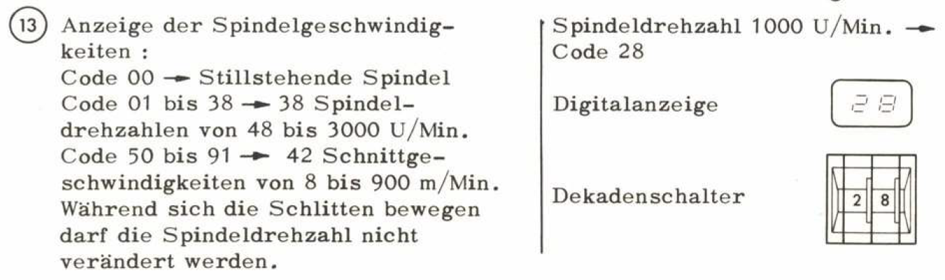

29 Mar 2022 07:37 #238575
by RotarySMP
Replied by RotarySMP on topic Schaublin 125-CNC retrofit.
Keep the inputs coming. This really helps with focusing the options.
I just checked the manual.
What it says is that there are 38 discrete speed settings, or 42 surface speed settings with the note that no speed changes can be made while the axis are moving. So what I thought was CSS is probably just a surface speed selection which is then interpreted as a constant RPM for that cut.
One thing I have no "feel" is how often you can drive that variator, before you chew up the contactors? Andy, when you talk of bang bang control of the variator, with a wide dead band, what would that mean in practice? It cant be a rpm range, as 20RPM down at lowest (36) is lots, but 20rpm at 3500 is nothing. Especialy with the none linearity of the variator. I guess it would need to be dead band as a percentage of current speed? Something like +/-20% adjust on VFD, beyond make a variator move first? Does this mean on a CSS cut, you buffer the start RPM, move the Variator that +20% in one go, then stop commanding it and at the same time let the VFD compensate to set -20% under speed to 20% over that buffered value? I cant picture how that can work, as the VFD is preventing the variator change from showing up on the encoder.
I am not really convinced that a feedback of Variator position is necessary yet. What do you guy feel about that? Also not sure whether dumping the contactors for a variator VFD be a good idea?
There seems to be two paths here:
- rough speed setting. Use the variator for 4 or 5 roughly fixed ratios, or,
- fine speed control. Control the variator infinitely.
Given the broad control range of the VFD It would seem to me that the first option offers the advantage of a software only solution, no risk of contactor early demise, with no practical disadvatage, assuming that dead reckoning of two or three intermediate variator positions can get roughly the repeatable ratios.
