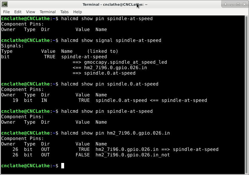

So I now understand why it needs to be in a postgui hal file. I tried your pin but got a failure message on startup. I have updated the postgui hal file and gmoccapy now starts which is progress. The spindle feedback bar doesn't work and the spindle at speed led is lit permanently (incorrect). This is backed up in halshow.
I have attached the relevant ini and hal files. Also a screenshot showing the pins in case someone can see an issue i can't.
- Posts: 18104
- Thank you received: 5328
22 Jun 2021 20:29 #212698
Replied by PCW on topic Another spindle encoder question Orac/7i96
net spindle-speed-fb <= gmoccapy.spindle_feedback_bar
The signal spindle-speed-fb is not connected to anything
As a start , I would connect it to the 7i96 encoder velocity (in RPM)
pin.
net spindle-at-speed <= gmoccapy.spindle_at_speed_led
This would normally be driven by a "near" component (not a GPIO bit)
with one input being the commanded spindle speed and the other,
the actual (feedback) spindle speed
pin.

It worked!! well mostly.
I ran the following command "halcmd net spindle-speed-fb hm2_7i96.0.encoder.00.velocity-rpm" and the feedback began working. I've updated the custom_postgui.hal file and now it works on startup. Thank you for that.
With regards to the led, it makes sense to me why it would be driven by a "near" component but I am not sure how that would look from a hal pin point of view? Could you give an example and I'll try to follow the signal through and insert the missing pin. Thanks again for your patience - I appreciate these are very much newbie problems.
