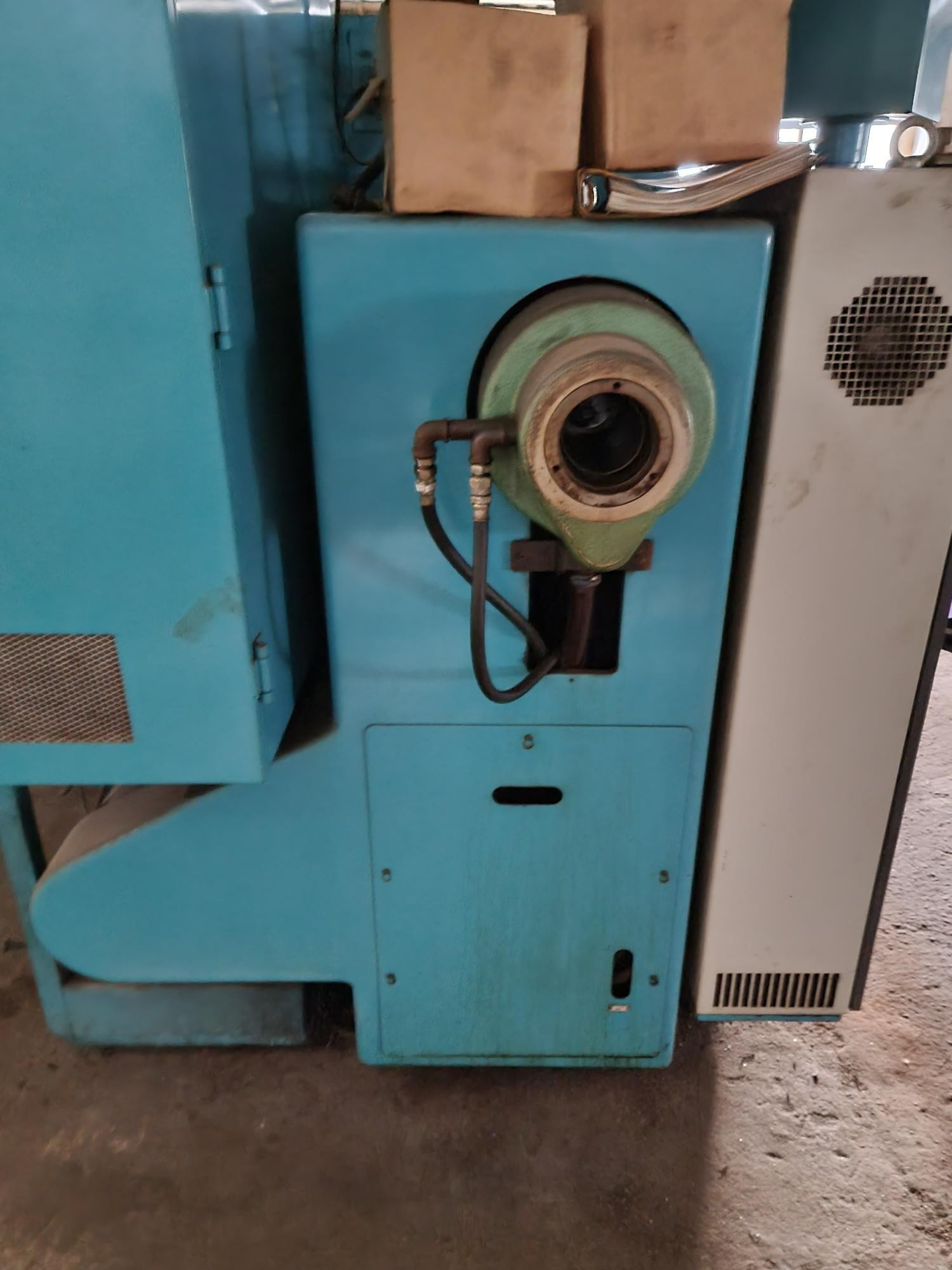

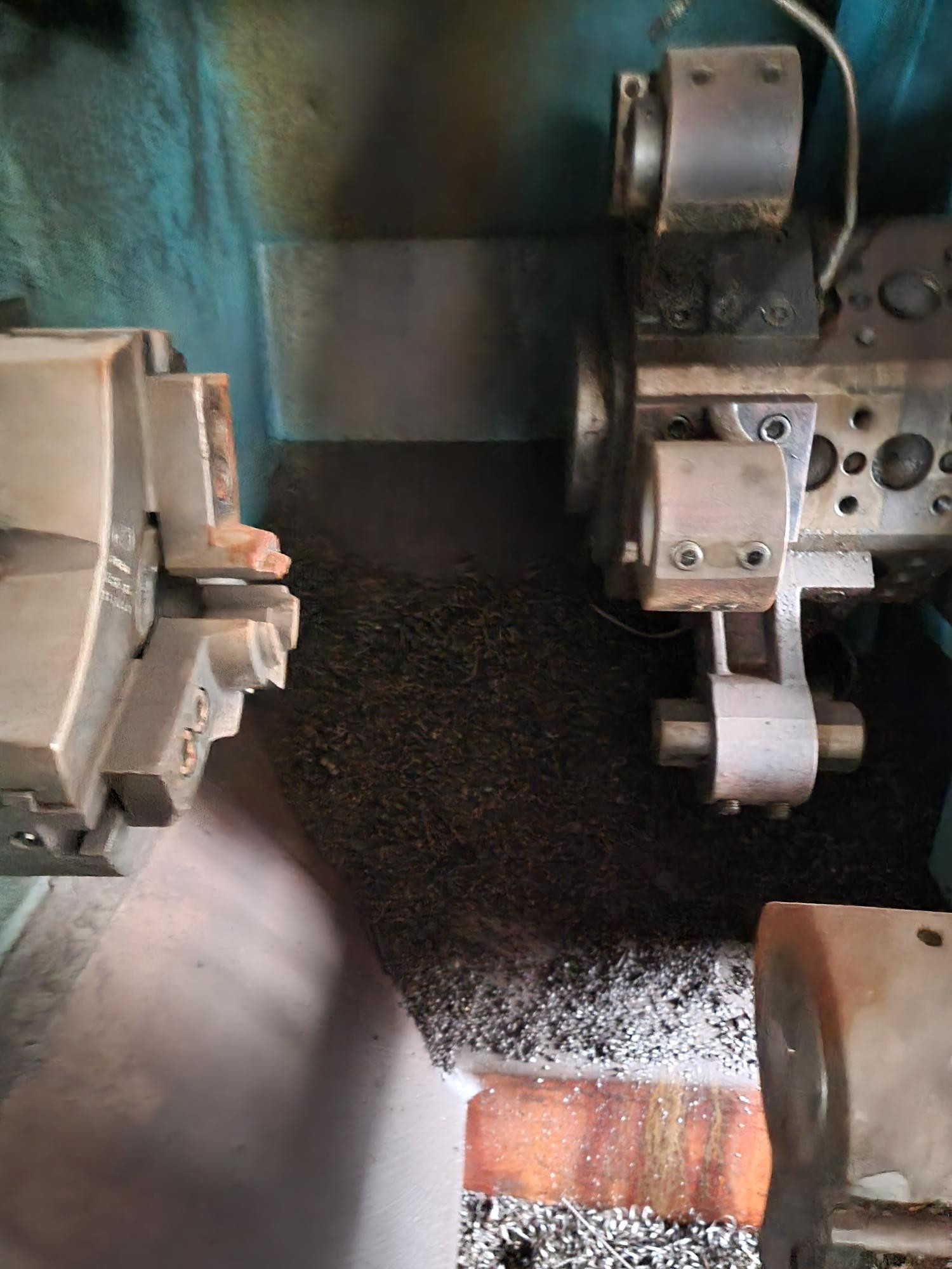

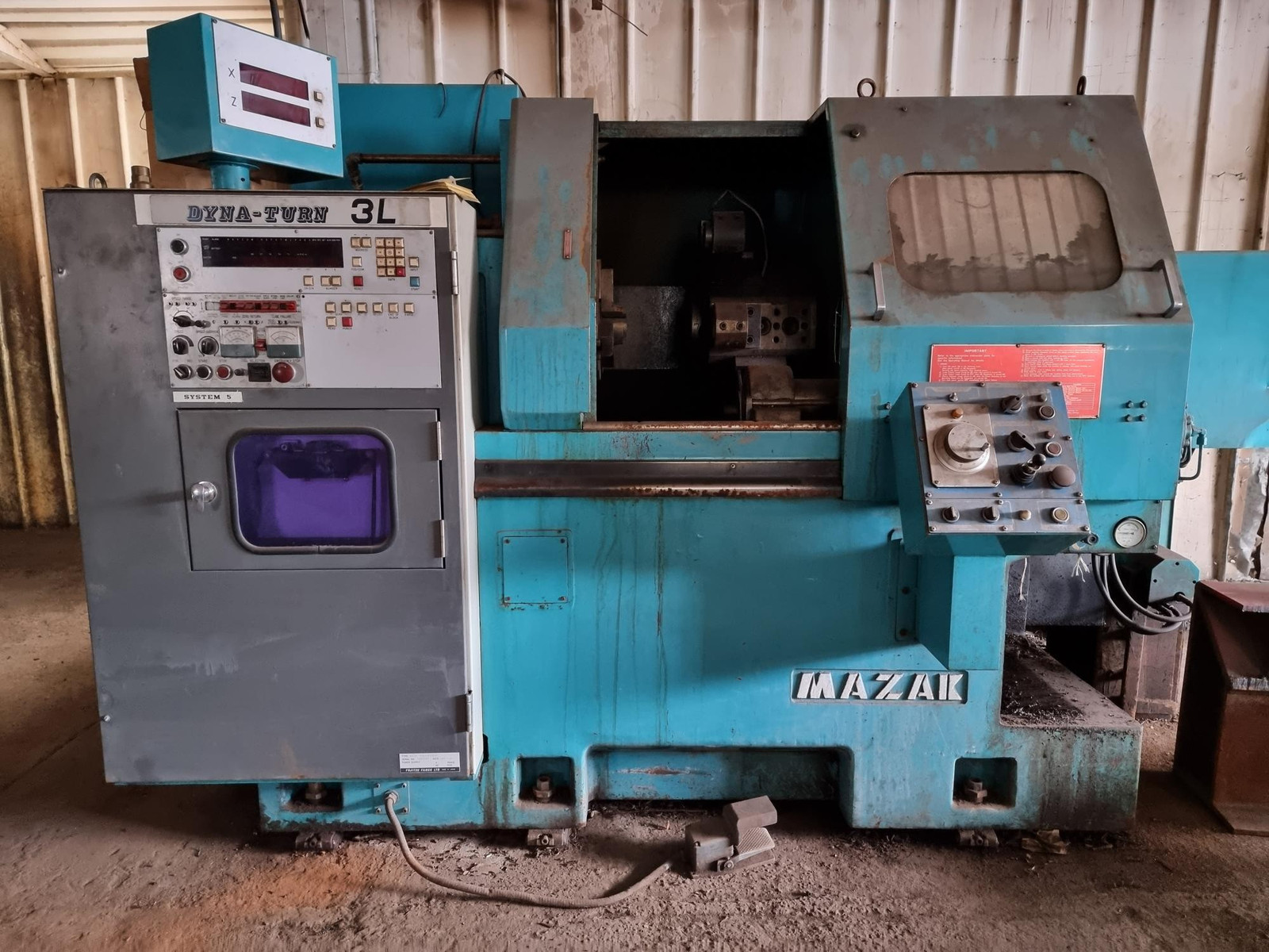

Howdy folks!
I'm new here and all in all pretty fresh to the space besides dabbling with steppers, PLC's, VFD's ect ect.

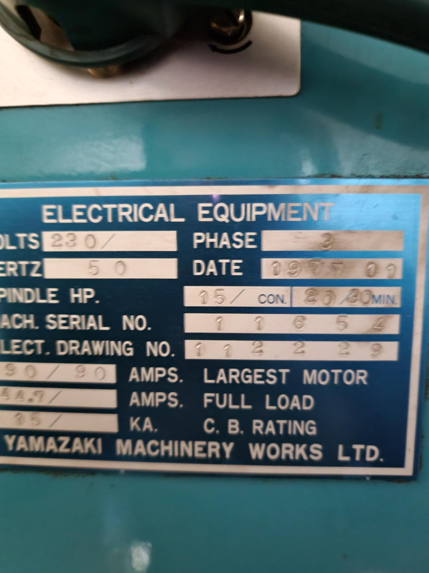

Shook hands on an 77' Mazak Dyna-Turn 3L that had been taken out of service back in 85' and left hanging ever since.
This was probably a bad idea.
Regardless I'm gonna arrange delivery of this 5 ton beast and try to get it situated where i can disassemble said beast and see if it is worth giving the insane ammounts of TLC this thing will surely need.
My thinking is that if the guides, ways, screws ect are not pitted out, they should have only moderate wear on em seing as this thing probably saw less than 6 years of production. it has some kind of hydraulic stock feed machanism and a rotary 8 slot tool holder, which may or may not be interesting to keep, but it will all depend on condition.
I've come to some very soft intial paths forward that probably involves a mesa 6I35 PCI-E board and whatever extras i will end up needing.
My intial thought was to try building basic functions on something like a siemens S7 1214, but why reinvent the wheel if Linux CNC does what it says on the box!
Been dabling with PC's and PC hardware for the past 20 years but never really became comfortable with coding, terminal interfaces or linux. I'm guessing thats gonna need to change for this all to work, so progress wont be fast. Looking forward to share the madness with you all, and lurk around for insight and inspiration.

I had the same Fanuc 5t Control on my 1979 Takisawa CNX Lathe....
One thing you should know is, that these old Fanuc DC Motors are only equiped with an incremental encoder, but the Fanuc servo drives needs an tacho signal for velocity feedback. So Fanuc generated an 0 - +-10V Tacho Signal from the encoder on the CNC Mainboard with an discrete circuit.
To use the existing drives you will have to emulate the tacho signal with an very fast task. I have done this with ethercat, but i think this could also be implemented in an Mesa FPGA Board.
Finally I have ended up with mounting new Beckhoff Motors, because the Z Fanuc Motor had insulation errors amount an specific speed.....
