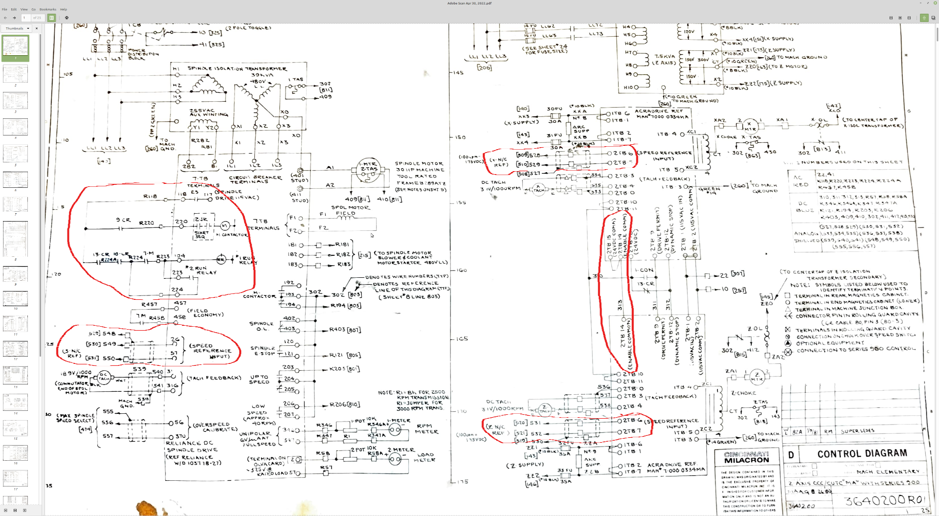

25 Jun 2022 18:33 #245873

25 Jun 2022 22:56 #245888
Replied by tommylight on topic 1980 Cinturn 1212u Cincinnati Milacron refit
Ouch, that is a loooong and heavy document, my mouse is still dizzy from scrolling through it!
I did find the spindle block diagram, but i can hardly read anything in it on a 28" screen.
The schematic you uploaded earlier, did you check if they are similar to your machine?
We need "close enough", does not have to be exact, but as a starting point:
0-can you power on the machine?
1-can you enable the drives as they are now?
2-if you can, find the "speed reference" wires/connector for any drive or spindle, preferably spindle as it will not break anything if it goes full blast while testing.
3-take a small 1.5V battery and connect the "speed reference" wires to it, try both polarities and see if the spindle direction changes.
4-if you can not enable them, find the enable, for the spindle it is a bit murky, for the drives it seems they should be tied to ground, but do use a resistor of at least 100 Ohm while testing it.
Attached, marked parts/pins to find on the actual machine.
Basically, that is all you need for a retrofit as a starting point.

26 Jun 2022 12:35 - 26 Jun 2022 12:36 #245914

by lookin at the schematics and what's on the drives themselves, the circuits do not actually match up.
Lets look at the slide drives X and Z
we have 120vac on terminals 1 & 2 check
tach on terminals 3&4 check
we have our velocity commands on terminals 6 & 7
No here's where things get really fucking stupid
10 and 11 are motion enable per the drive labeling on the housing, those are wired to constantly be enabled btw, I am not sure this was a good design choice on the part of cincinatti if the following things are true
things are about to get VERY DUMB
terminal 13 is essentially the emergency braking function, is is controlled by a coil relay which is illustrated as being normally closed, if you bring the 24v of NC voltage to terminal 13, the drives go full power and the braking resistor takes a bunch of heat. I suspect that this is either part of Estop OR the controls were using this to decelerate the machine. not really sure why the hell you would do this with a normally close relay however. Seems like you would risk destroying the drives if the wire for the power supply got loose. ohhh, but that wire from the 13-cr doesn't go directly through the relay, it goes to other contactor relays, yay, not documented
even dumbers
terminal 9 is most definitely not a drive permit afaict, and when it gets power then the contactor close for 1-con, if I bring power to terminal 9 the motor hum, and show voltage. that power being 24v from closing the contactor to enable power to the RCS
it was at this point, one of the RCS in the Z drive failed, despite me verifying the voltages are the tach input were correct and the inputs were at 0v. I have a spare RCS so I can repair it
the problem is that whoever designed this machine, was either a genius, or the most incompetent electrical engineer in history. I lean towards the ladder. This thing has no less then 100 points of estop connections. First off, if you actually need the Estop, shits already in too late mode, secondly, the correct way is to watch for deviation from commanded motion. third the estop circuit should turn off the contactors and enable any braking in the machine, the spindle and the X have brakes, it didn't need to be the type of circuit it is, a simple relay to shut off the contactors and turn on the brakes would have been more than sufficient. it would have also been safer and more reliable to build the Estop this way. Very much has a design by committee look to it where legal was obsessing over imaginary safety concerns or the engineering team was exceptionally paranoid and there was poor leadership. I suspect a mix of both.
Lastly and most importantly, it looks like whoever did the engineering work, basically tried to design a analog switch gear driven CNC machine, and this thing had a very powerful for it's time intel based computer with a gui and a monitor. It wasn't lacking for computing power.
This machine was definitely in the class of what I would call electrically /functionally fragile. Meaning it had far to many places where failures even benign ones would cause the machine to be inop or cause it to have catastrophic malfunctions
I gutted ALL of the controls wiring last night, time to start over. I think I can get the spindle drive to work, maybe, it is a reliance drive, the documentation is kinda sketchy, I will attach that PDF which is again, not exactly related to my drive but it is all I have. I am going to just rebuild the entire enable circut and put a 500 ohm 10 resistor across the drive outputs, that should get the RCS transformer to balance and show voltage so I can test it without damaging the machine.
Push comes to shove, I am all about replacing these drives, the motor look very robust however. but if I can't get these drives working soon, I will be looking to replace the drives and if that proves undoable, AC servos it will be.
