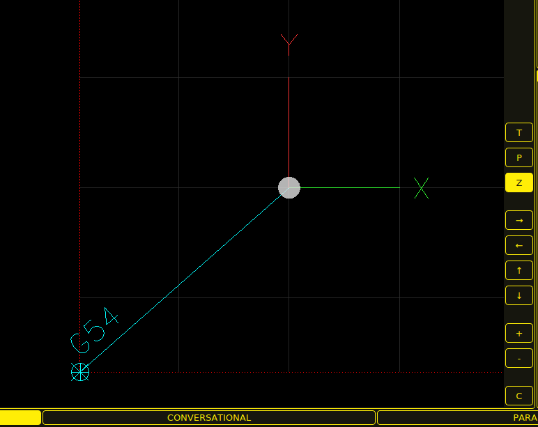

Looking at Axis' implementation of this makes MUCH more sense to me. They also can show a label next to the small origin to show the currently active offset (G54, etc.).
The GUIs I spend most of my time in (QtPlasmaC, and PathPilot) don't allow machine vs relative, and don't use the offset label next to the small origin... so it never made any sense to me.

Tommy,
Chris made me aware that showing the current offset label with the small origin is a stylesheet settable option in qtvcp, and as such, you can turn it on in QtPlasmaC if you'd like:
To set it in QtPlasmac:
1. create a file in the <machine_name> config folder called "qtplasmac_custom.qss"
2: open the file, enter the following, save and close:
Also if anyone dislikes the small origin on a qtvcp screen, it can be hidden via stylesheets now too:
#gcodegraphics {
qproperty-_offsets:True
}Also if anyone dislikes the small origin on a qtvcp screen, it can be hidden via stylesheets now too:
#gcodegraphics {
qproperty-_small_origin:False
}Attachments:
