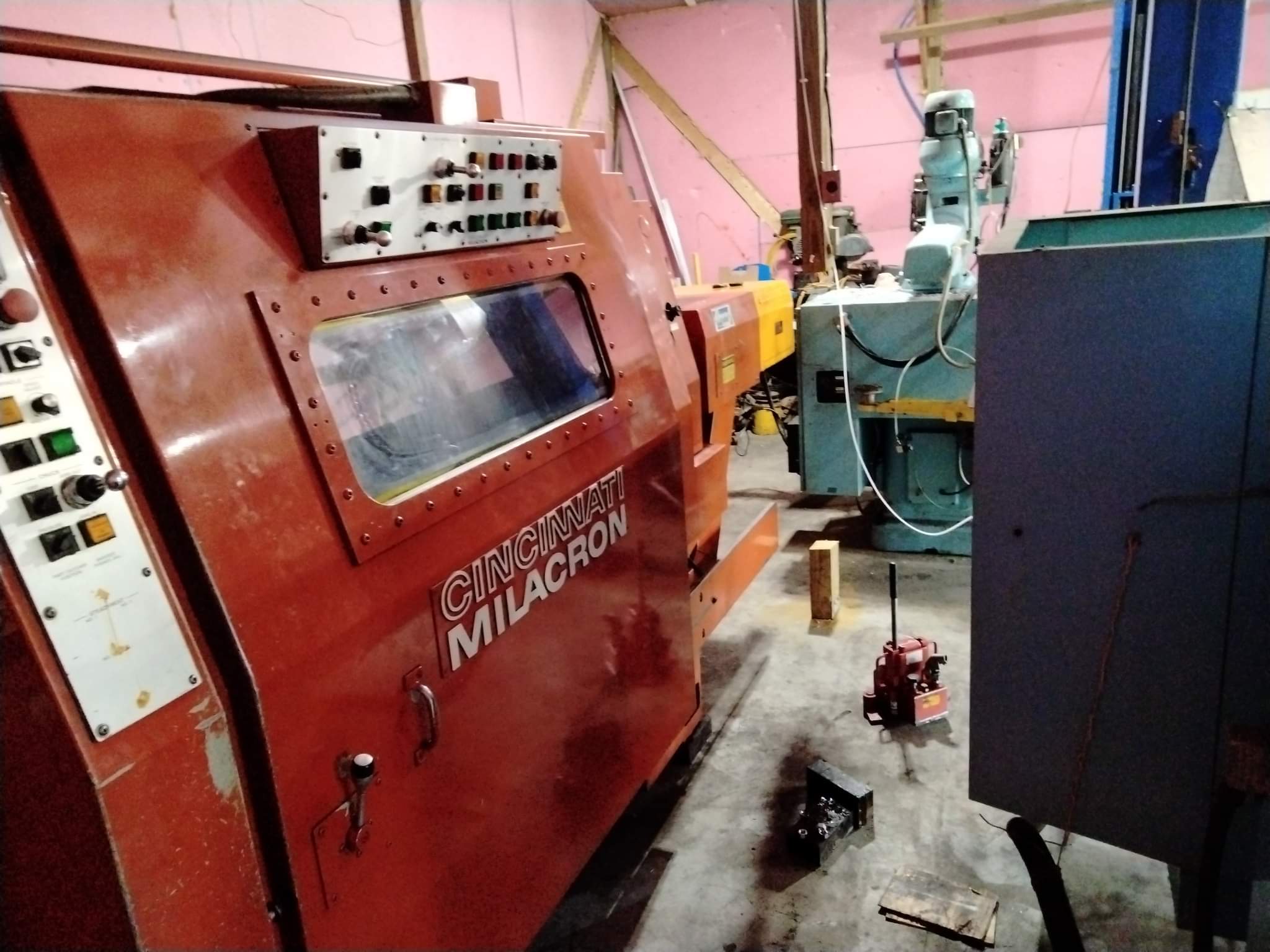

08 Jul 2022 03:44 #246852
by smc.collins
Replied by smc.collins on topic sizing servos for a cnc lathe

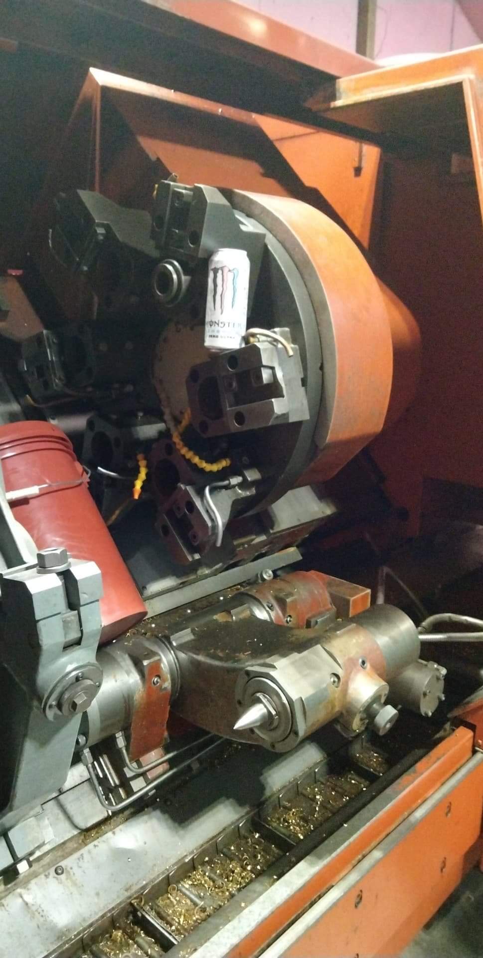

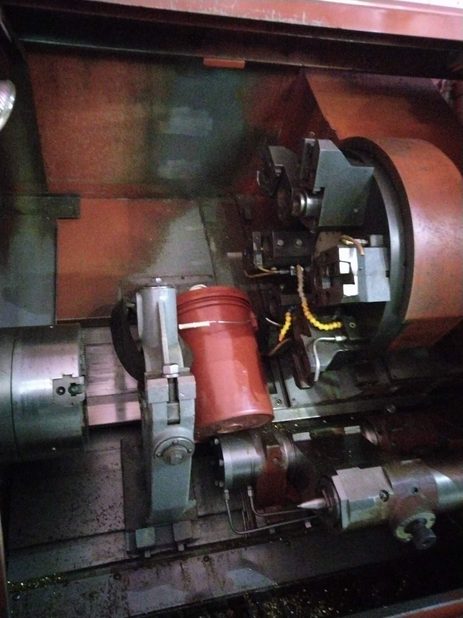

This thread lacks photos. Please post photos of the lathe. Everyone likes photos of lathe.
This is too much focus on rated power in the selection of the motors. That tends to be a pretty unimport secondary parameter, in that once you have sized the motor for the inertial loads, and necessary torque, the resulting motor will have some rated power (typically way way more powerful than you would expect).
I did a course on this at the TU, and summarised the process they teach here:
The expectation of a manufacturer would be for a very rigid, highly dynamic drive system. For your purpose, you are prepared to compromise in the machine dynamic performance, and also the cutting power, but when you run through the inertial calculations, you may find you need a pretty beefy AC motor, to get it to work at all, especially if it has a long, large diameter Z ball screw, direct driven. On a lathe, the inertial load of the Z ball screw and motion of the saddle can be significant, with the sort of light cuts you are willing to accept maybe buried in uncertainty of those loads.

I'd love to see photos of that beast.

08 Jul 2022 21:23 - 08 Jul 2022 21:35 #246913
by smc.collins

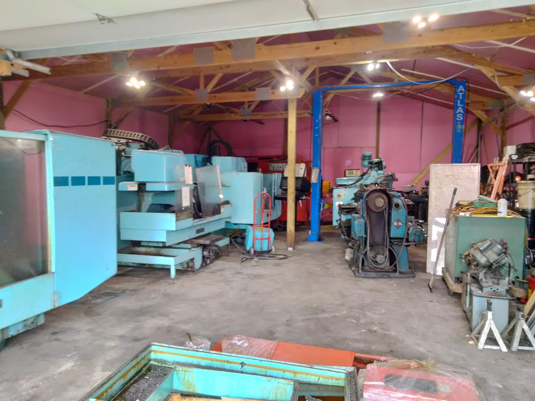

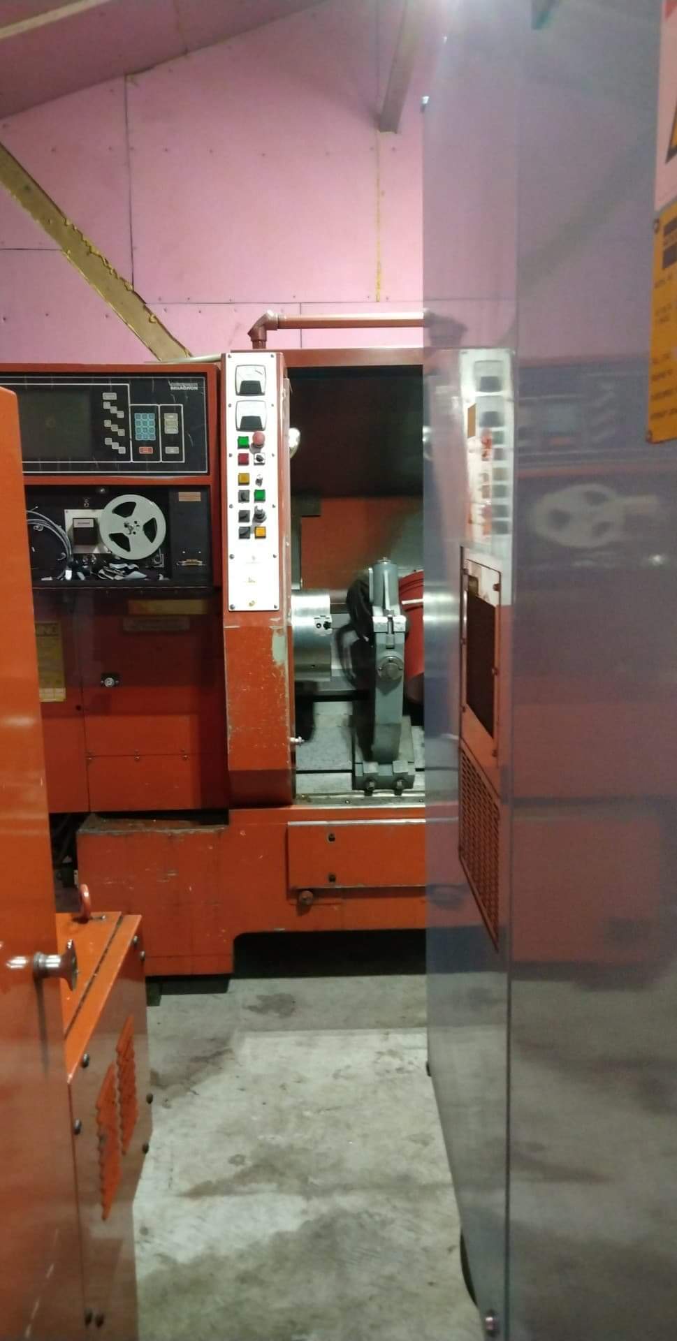

I'll post more later, forum attachment size limits require compression
I've got a lot of machines in this slace, will be moving 2 of the mills in the future once the new garage goes up.
That's a 5 gallon bucket btw for scale
Last edit: 08 Jul 2022 21:35 by smc.collins.
The following user(s) said Thank You: RotarySMP, tommylight
- Thank you received: 4654
13 Jul 2022 23:10 #247266
Replied by andypugh on topic sizing servos for a cnc lathe
The swing-up tailstock is pretty wild.
- smc.collins
- Posts: 723
- Thank you received: 139
13 Jul 2022 23:19 - 13 Jul 2022 23:20 #247268
by smc.collins
it is ain't it, It is 100% hydraulic and I got to be honest, I am thinking about converting it to servo. Apparently if you run the tailstock pressure to high, it'll break itself. Talked to prior owner. comning with that massive steady rest was pretty sweet though.
Even wilder, the machine had just under 1000 hrs on it.
Last edit: 13 Jul 2022 23:20 by smc.collins.
