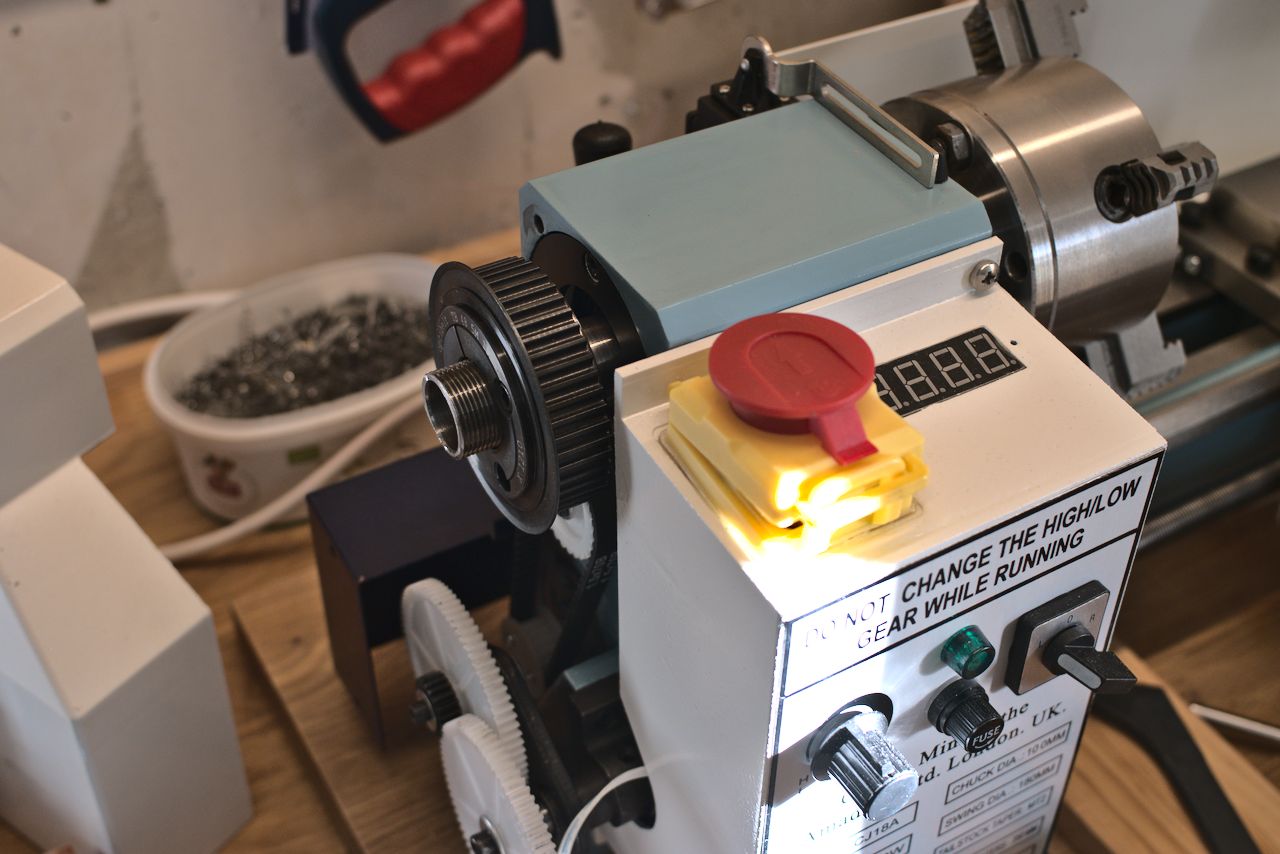

It's just loosely fitted for measuring in the image: some steel rings/sleeves will be needed to preload the spindle bearings through the bushing.
As a waypoint on the road to full CNC I plan to drive the original Z leadscrew with a servo slaved to the spindle to start with. (Kind of an advanced electronic leadscrew if you will.)
You've seen RotarySMP:s CNC conversion? He's a member here and made a very nice conversion of a CJ18A: www.youtube.com/playlist?list=PLHRtJd1bD...-A-CPBwys-tTM3wKMOGW
Replied by arvidb on topic Amadeal CJ18A Mini Lathe CNC Conversion
I have pretty much the same idea. I'm going to try using a HTD pulley with a 28 mm taperlock bushing to drive the spindle:Due to the noise it makes I would like to remove all the different gears and be able to index the spindle, have better speed control and still be able to cut threads so was thinking about either changing the motor to a servo motor or a closed loop stepper motor, but I have really no clue on this. Is this even possible?

I didn't bother, I just preloaded the spindle before final tightening of the taperlock and it worked fine for years.
As long as contact on both sides is only with the taperlock and not with the pulley you can treat the taperlock bush as a solid sleeve.

That's what I'm planning to do as well. Nice to hear that it works! But surely you needed some kind of sleeve to take up the axial distance between the bearing race and the taperlock bushing? The bearing race is about 10 mm below/inside the surface of the headstock, at least on my machine...

It's been a while, but probably. I have a vague memory that perhaps I replaced a bit of plastic pipe (Mine was _not_ a quality lathe from the factory)

Haha, yeah, mine had the plastic tube too. The quality of the Amadeal CJ18A really is awful, but the size (and the price) is right! Biggest issue with mine was that the paint was literally falling off of it - it hadn't been cleaned/prepped before painting so lots of oily grinding dust under the paint. That took some effort to sort out.
I replaced the plastic tube with a steel one a while ago to be able to properly preload the spindle bearings (which I had changed earlier to angular contact ones so they really needed the preload), but a shorter tube will be needed to accomodate the taperlock bushing.
