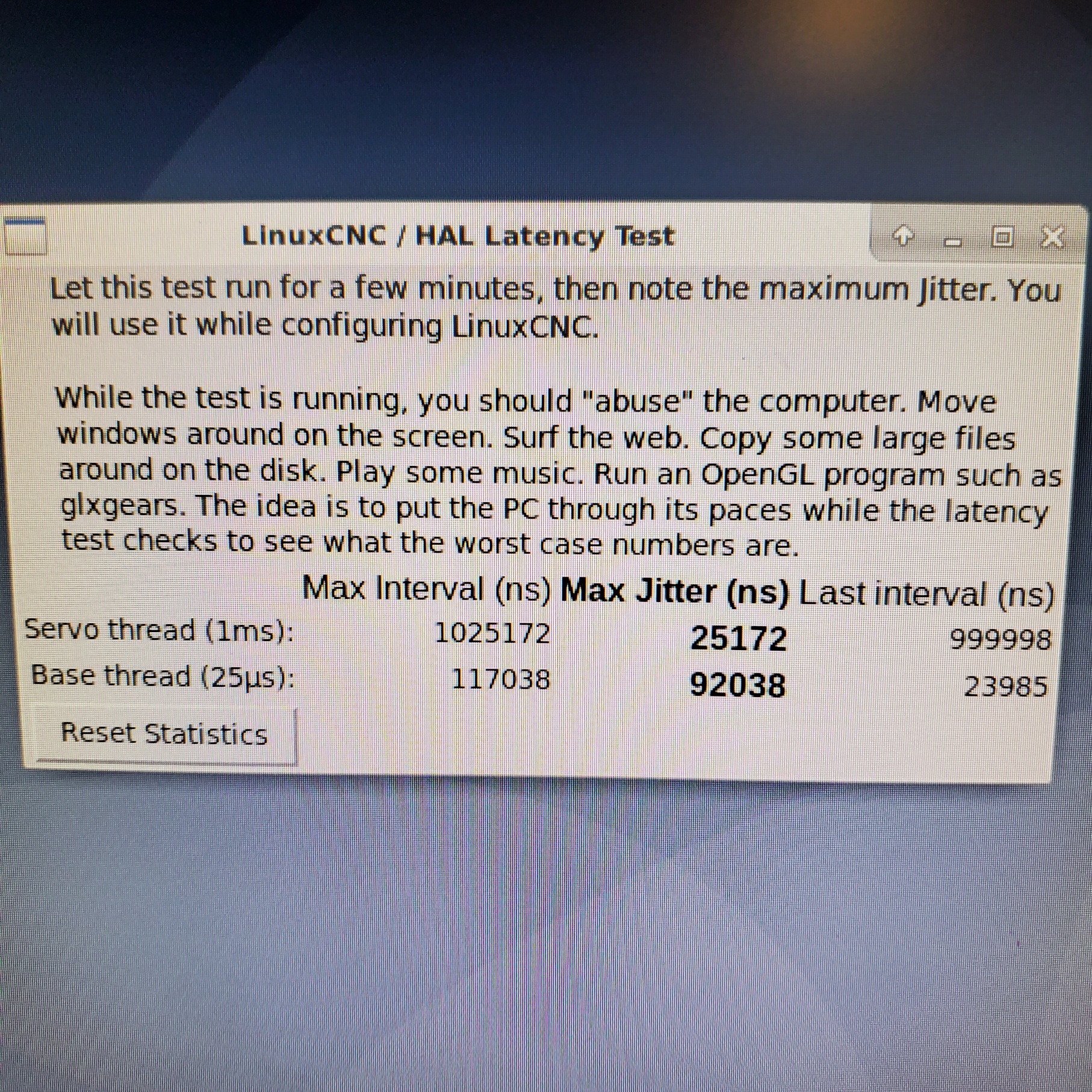

14 Dec 2022 13:16 #259459
Replied by tommylight on topic Huyndai hit 15s retrofit
Looks ok so far, test with
latency-histogram --nobase --sbinsize 1000 --show
If you do not need software stepping/parallel port, and watch youtube and copy some files around while that is running.

17 Dec 2022 17:10 #259741
by Mr.
Replied by Mr. on topic Huyndai hit 15s retrofit
Will do that this weekend, been busy doing other things. Plenty of work to do lol

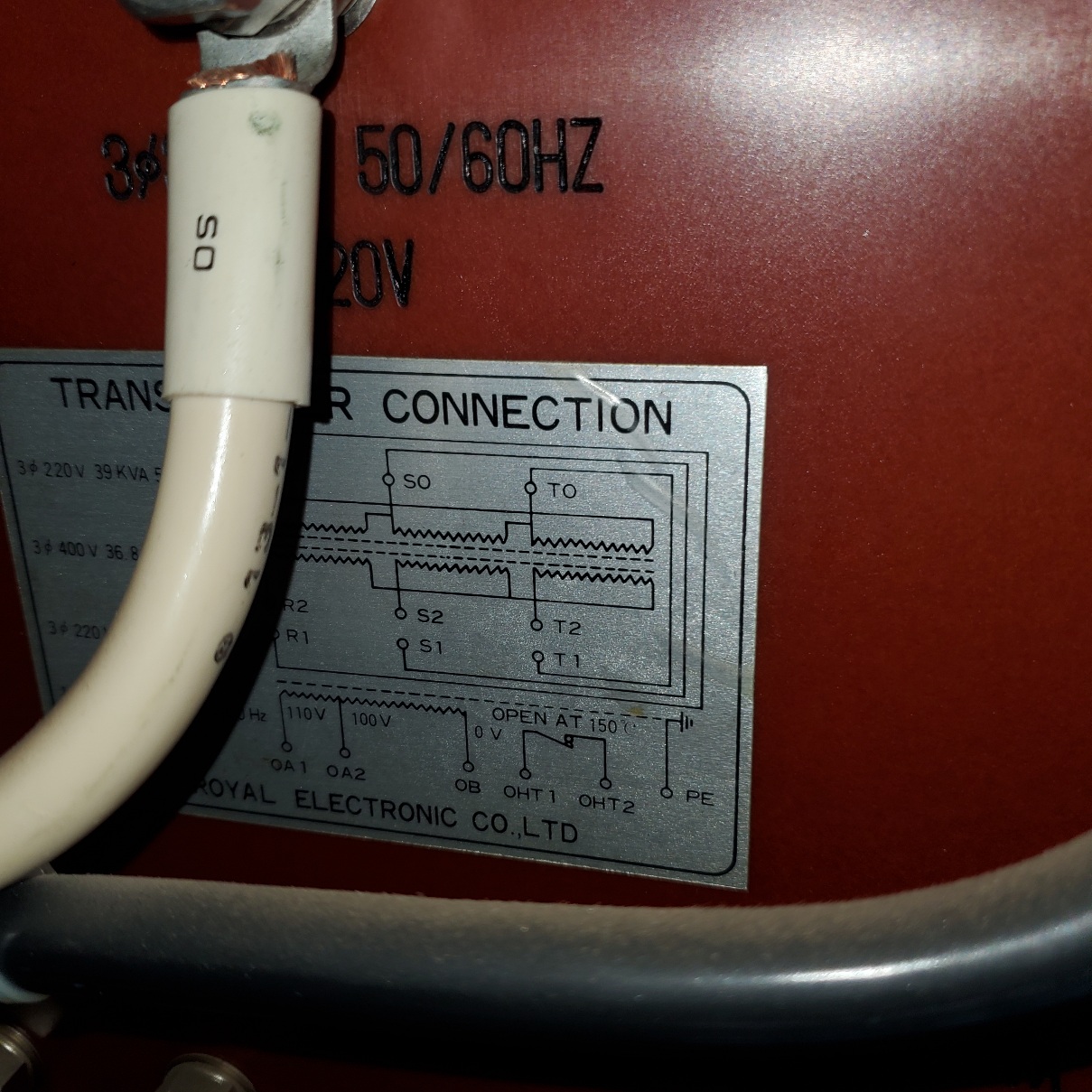

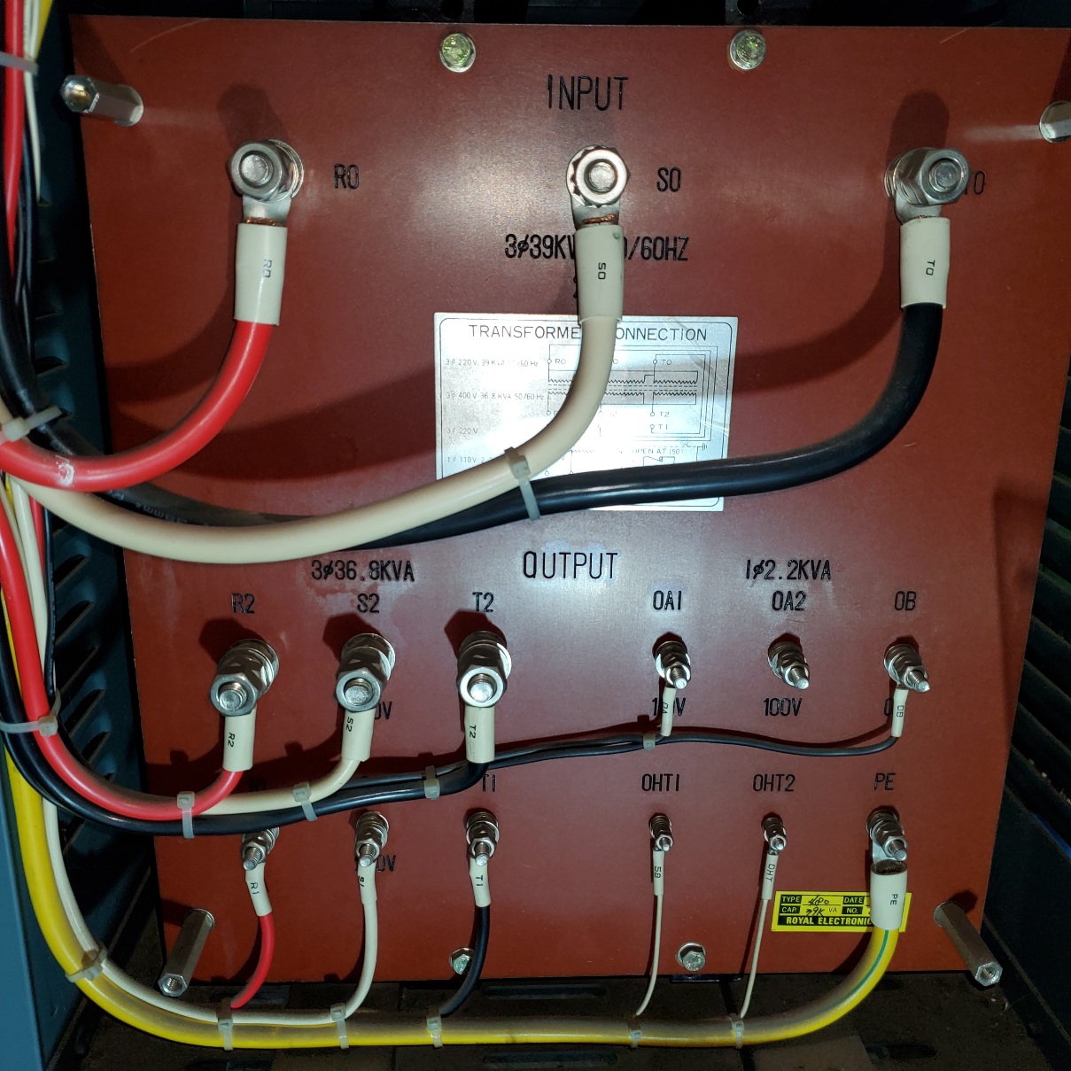

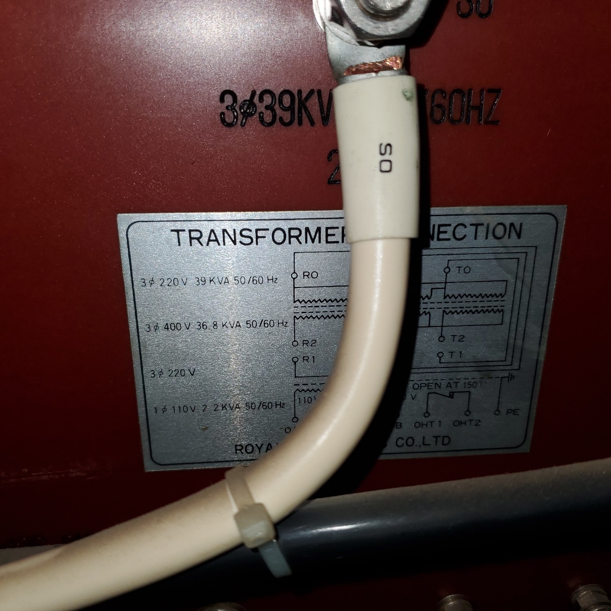

- Posts: 19899
22 Dec 2022 00:26 #260054
Replied by andypugh on topic Huyndai hit 15s retrofit
Might be worth looking at whether it can run off single phase. The servo drives convert to DC internally (and then back to AC) so they don't care.
It might take a bit of analysis to work out what the input stages are, but you might find a separate 3-phase input transformer and rectifier stage that will just work happily on single phase.
