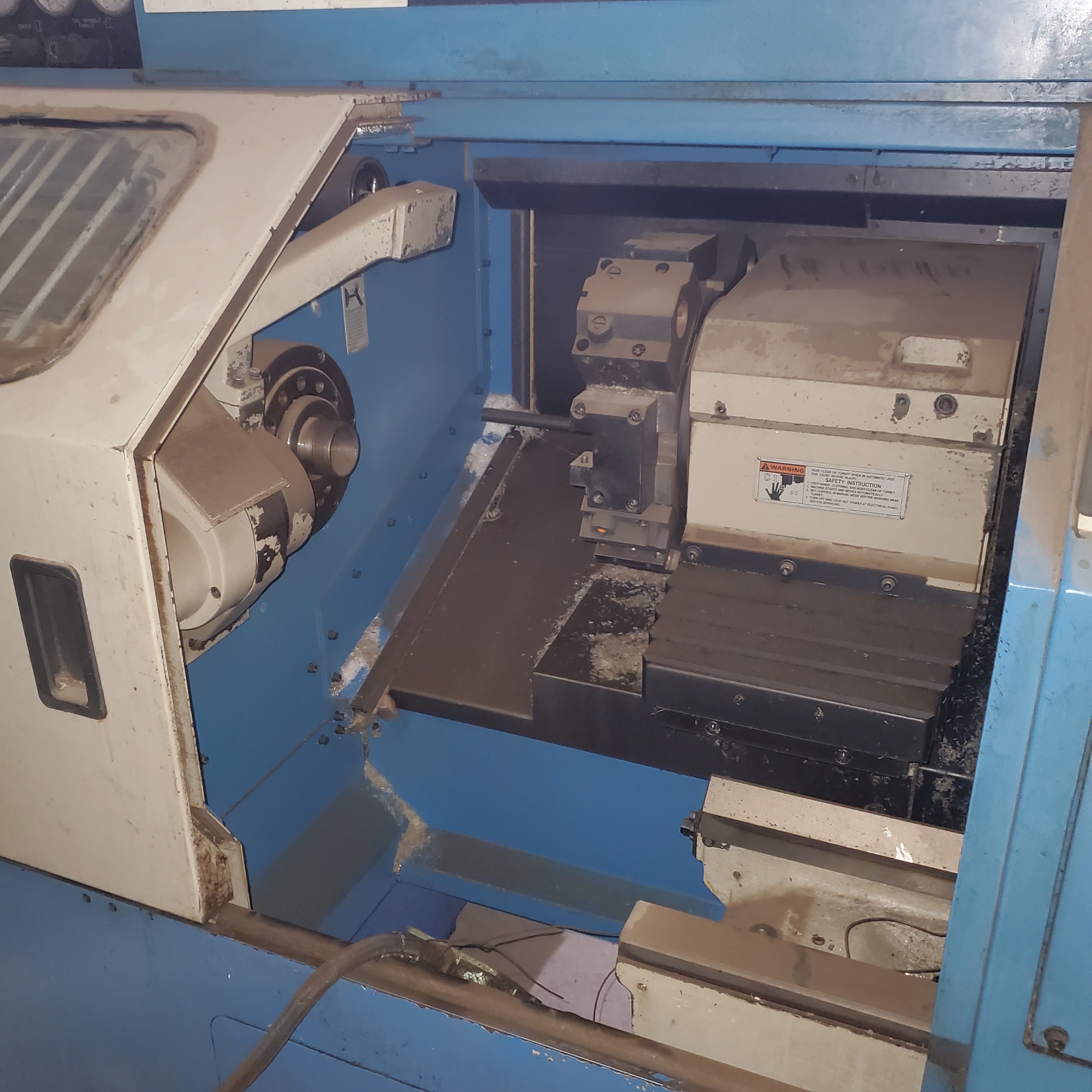

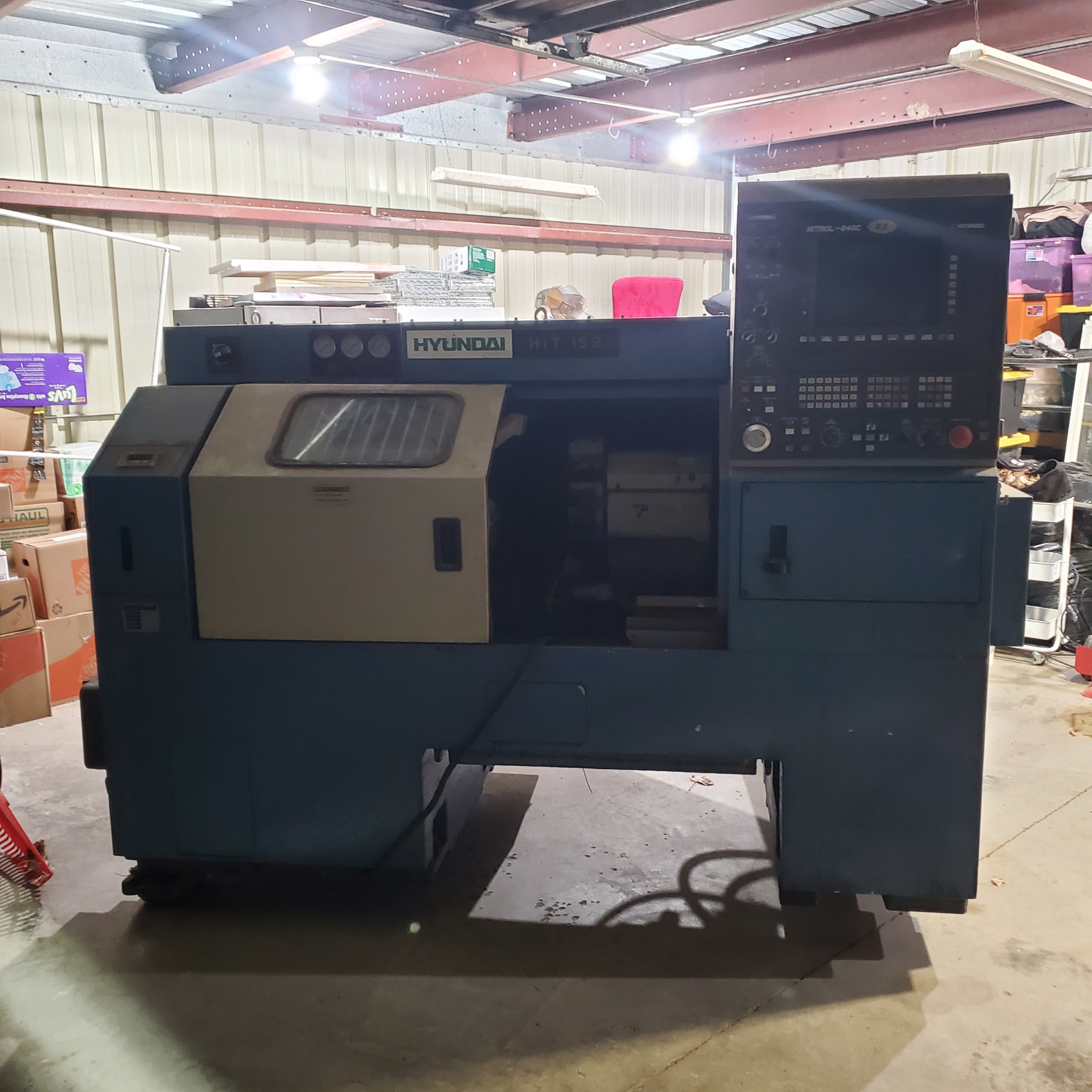

Hey guys. Bought a machine at an online auction and was told it powered up but had a controller card issue. So i figured mabe 1k worth of parts and id have a running machine......
well i was in a hurry to load it up and get it home to find they were pretty dishonest(even talked to the seller) seems they parted the keyboard interface, io stuff, and some other stuff pretty sad but i was working on getting it back togather...
then i found they took the dam hard drive, there goes that idea lol
Well out with the old hitrol in with the new lunixcnc
Im assuming its gunna be slow going so i can figure this all out, ive done a g0704 mill awhile back with mach3 and i know sumin fully functional is gunna be alot more difficult but im willing to learn, hopefully in my yrs my brain hasnt smoothed out completly lol
heres the plan
Lunixcnc
mesa board
Simodrive 611 drives (as long as there still good)
Current siemens servos

Machine is a 96ish 840c with seimens 611, from what ive been researching theres a good chance they could be, but your right never assume. Ill do some more digging
