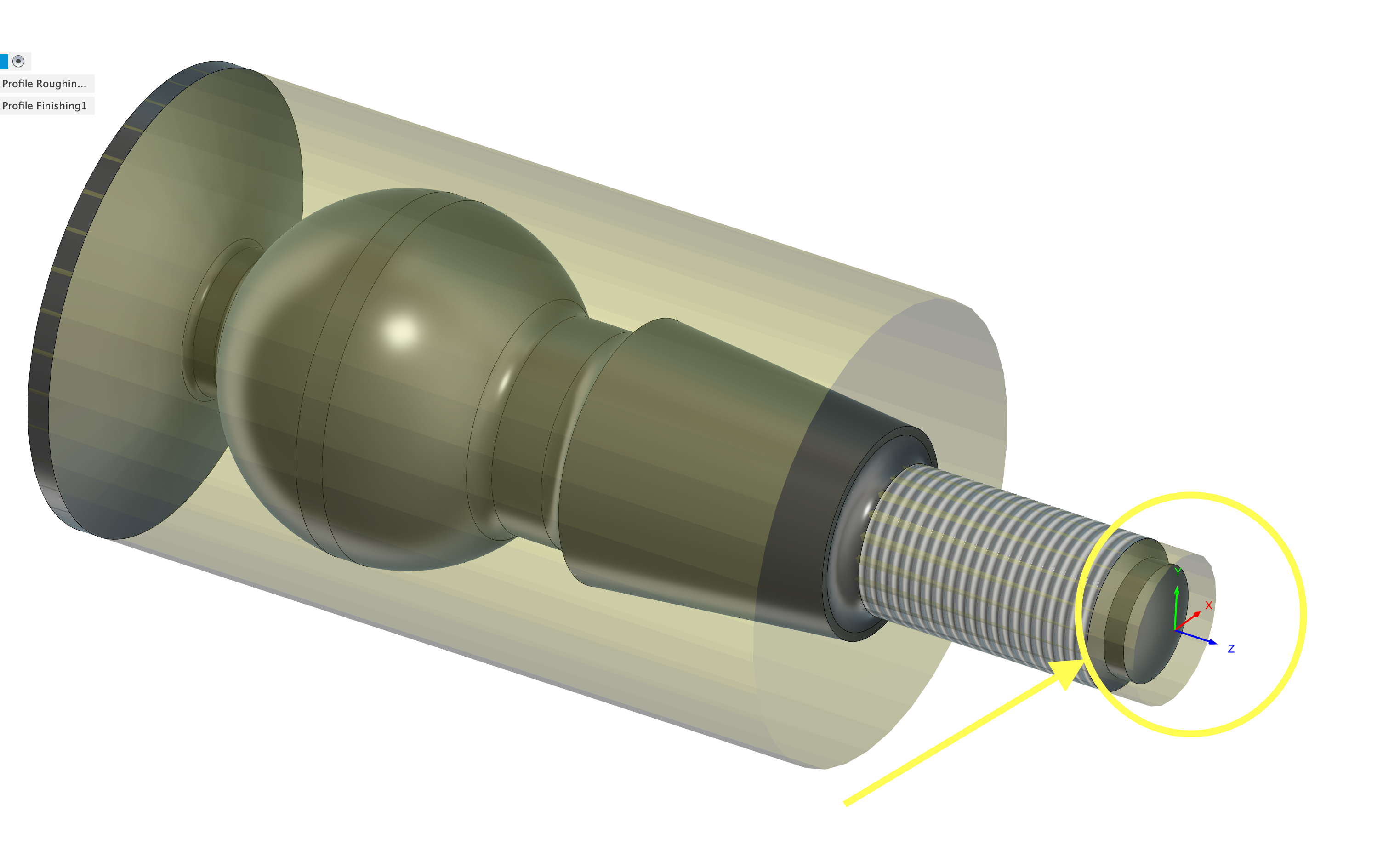

Hello,
when i generate a cnc file with fusion360 and the linuxcnc turning post processor, the result is also not matching my work piece, It looks like its taking the diameter instead of the radios somehow, in all case when i touch off my work piece in this way(perhaps here the problem is situated):
going to the start of the work piece outer right side and outside corner and set x and z to zero, when i start now the file, its always starting around the radius towards me in the air in stead of the work pieces surface.

- Posts: 19899
23 Aug 2023 20:29 #278823
Replied by andypugh on topic how to correct generate cnc files with Fusion 360
- geostein8888
- Posts: 29
23 Aug 2023 21:30 #278827
by geostein8888
Replied by geostein8888 on topic how to correct generate cnc files with Fusion 360
do you mean to the diameter of the work piece or the resulting diameter of the finished part?
