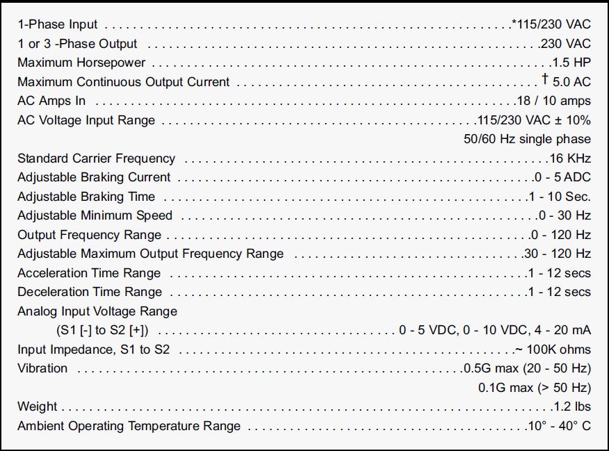

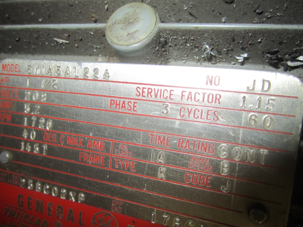

Not really a LinuxCNC question but I figure it's as good a place to ask anyway.I've got a Standard-Modern Series 2000 11" lathe running LinuxCNC and the VFD has been starting to kick out when the spindle is starting. Looks like it's an over-current situation even when I remove the drive belt and it's just the motor. If I increase the soft-start adjustment to close to it's maximum the motor will start ok but it's a really slow start now.Anyway, I figure it's time to look into a newer motor so I'm looking for any suggestionsCurrent motor is 1.5HP 3PH, data-plate image is attached
The Control is a minarik VFD05-D230-PCM (full specs attached as well)
- 1-Phase Input . . . . . . . . . . . . . . . . . . . . . . . . . . . . . . . . . . . . . . . . . . . . . . . . . . . . . . . . . .*115/230 VAC
- 1 or 3 -Phase Output . . . . . . . . . . . . . . . . . . . . . . . . . . . . . . . . . . . . . . . . . . . . . . . . . . . . . . . .230 VAC
- Maximum Horsepower . . . . . . . . . . . . . . . . . . . . . . . . . . . . . . . . . . . . . . . . . . . . . . . . . . . . . . . . .1.5 HP
- Maximum Continuous Output Current . . . . . . . . . . . . . . . . . . . . . . . . . . . . . . . . . . . . . . . . . . . † 5.0 AC
- AC Amps In . . . . . . . . . . . . . . . . . . . . . . . . . . . . . . . . . . . . . . . . . . . . . . . . . . . . . . . . . . . .18 / 10 amps
- AC Voltage Input Range . . . . . . . . . . . . . . . . . . . . . . . . . . . . . . . . . . . . . . . . . . . . .115/230 VAC ± 10%
- 50/60 Hz single phase

Does the motor spin freely with the belt off? It's just about possible
that the bearings have gone. (and bearings on a 3-phase motor are
easy)

Seems to.
Looked at some of the new inverter-duty motors and they are out of my budget for the time being so I was going to pull this one and give it the "once over" which really is just bearings and maybe a cleaning. Not much else in there.
The motor has been in there since the first conversion back in 2009 and the latest version in 2019 but it's a hobby machine with the odd small production run so total hours = not much. I have no idea what it's life before me was though.
The control is from my Tormach 1100 mill and it seems to use the same error light for both an over-current and an under-voltage state so although I don't think there's a voltage problem (can't test it that fast) during startup it's possible I guess. There is an auto-reset jumper for the voltage so I might switch that over just to see if it resets or not.
Just a pain since it of course happens when I need to do some dinky little job and it might be ok all day and then start acting up or it might act up first thing. I was thinking it was when it hadn't run in awhile so I'd get it running in a really slow speed and just let the spindle run for several minutes before actually doing anything and that seems to prevent it (or it wasn't going to happen anyway)
This last time it was after running for an hour or so and I just needed to polish the OD on a couple of pins and it wouldn't go. I quit for the night thinking maybe everything was hot from drilling 4" deep 1/2" dia holes in steel pins but it wouldn't get going in the morning either. Eventually had to play with that soft start but it's on max setting now.
ANYWAY, I'll try the voltage setting and if it still happens I'll pull the motor apart and replace the bearings.

Checked the current on all 3 phases and while running (no load, just the gears and chuck spinning) they are all around 3.3-3.5 or so. but during starting they each pop above 5.2 - 5.4 for a second or two and that must be where it's tripping the vfd.
It's rated at 5amp continuous so I thought it would take the initial startup overload a little better but it doesn't seem to anymore....
Still going to check the bearings cause well... why not
