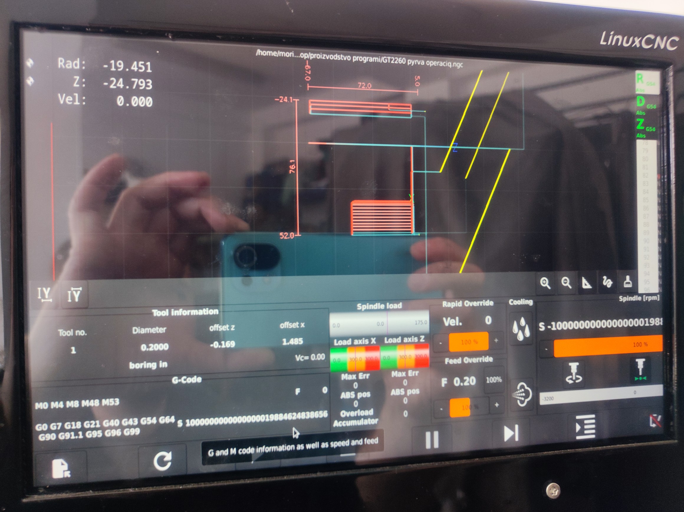

22 Apr 2025 05:32 #326878
by besriworld
Replied by besriworld on topic OLD Lathe conversion to a CNC
Today I reproduced the problem again. When running code with(constant surface speed), if I stop the spindle and then start it again, the spindle runs at 40–60% lower RPM than expected.If I resume the program at that point, the cutting feed does not adjust to the reduced spindle speed, which can be dangerous. After that, I stop the program, and Gmoccapy looks like it does in the attached screenshot.
Then, if I reload the program and start it from the beginning, the machine suddenly runs at a crazy high speed, and the graphical interface also shows the actual (high) speed.
G96Then, if I reload the program and start it from the beginning, the machine suddenly runs at a crazy high speed, and the graphical interface also shows the actual (high) speed.
- Posts: 19904
22 Apr 2025 09:03 #326889
Replied by andypugh on topic OLD Lathe conversion to a CNC
This looks very odd. It looks like a gmoccapy glitch, but can you try the same sequence in:
1) The gmoccapy lathe sim config
2) The axis lathe sim config
And see if you see the same behaviour?
- besriworld
- Posts: 327
- Thank you received: 92
22 Apr 2025 11:29 #326900
by besriworld
I guess there is a problem with the hall configuration. Today I broke 2 carbide inserts. After 10 made parts the axis started to move with a larger feed. But not too much, maybe 20-30% more. I tried in simulation but I don't know how to load my configuration into the simulation. There is no problem with the sample configurations.
- Posts: 18118
- Thank you received: 5336
22 Apr 2025 16:52 #326923
Replied by PCW on topic OLD Lathe conversion to a CNC
Not sure if it's related, but here is a similar issue, also using gmoccapy:
forum.linuxcnc.org/20-g-code/44739-g96-issue
- besriworld
- Posts: 327
23 Apr 2025 01:22 #326934
by besriworld
It seems that the two problems are related. I just have to try another gui
