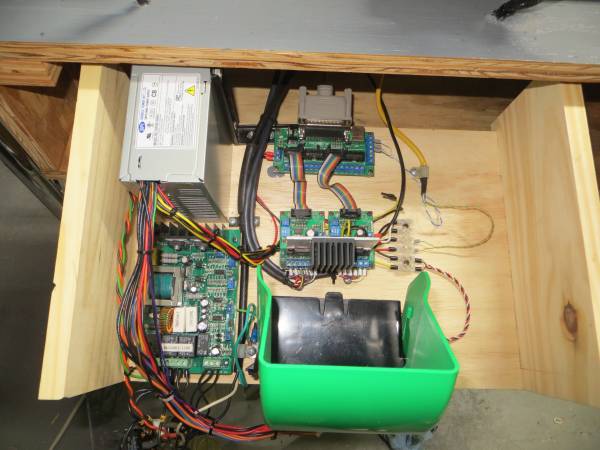

Greetings linux forum members,
I bought this cnc machine that I was told was running off of Linux. Does any of the members recognize this machine? Any help with getting it running would be apreciated. I was going to run it on an Older Acer computer with the usb prot adapter since it dosent have a seriel port. The Acer computer has 4 gb of ram storage.

That looks like a parallel port operated step/dir machine
so probably the simplest option is to use a PC with a parallel
port to control it.
General purpose USB --> parallel port adapters will not work
with LinuxCNC.

The attached picture shows a usb to serielport plug with the capabilites to connect diferent pins together. Will this plug comunicate with the linux cnc program to run the cnc lathe to make a cutting path for wood turning?

USB to Serial isn't relevant here. I think that plug is intended for transferring G-code to the controller, not for machine control.
USB to parallel won't work either.
Do you have a PC with a physical parallel port? (some have one as headers on the motherboard, but don't connect it to the rear panel)
You could also consider using a Raspberry Pi 4 (not 5 at the moment) but there isn't a config wizard for the Pi GPIO pins.
