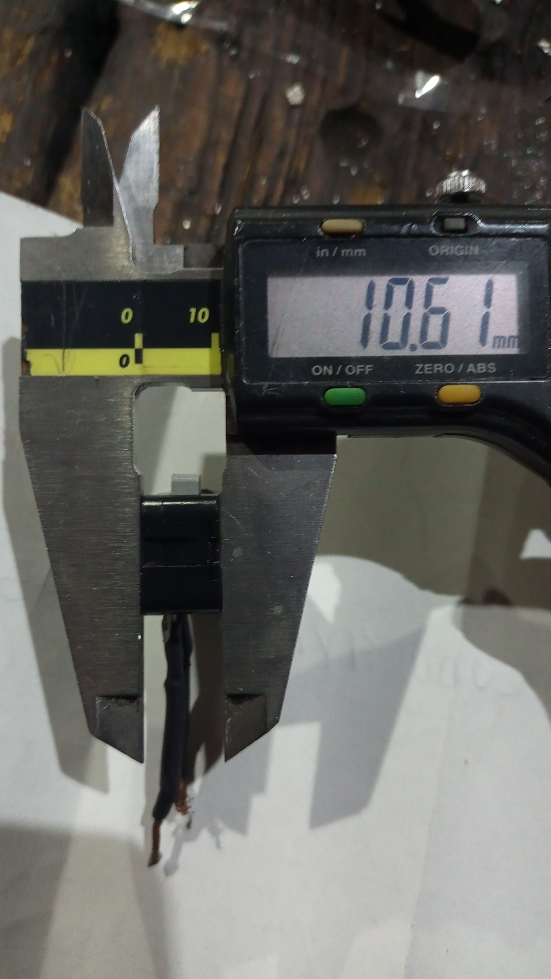

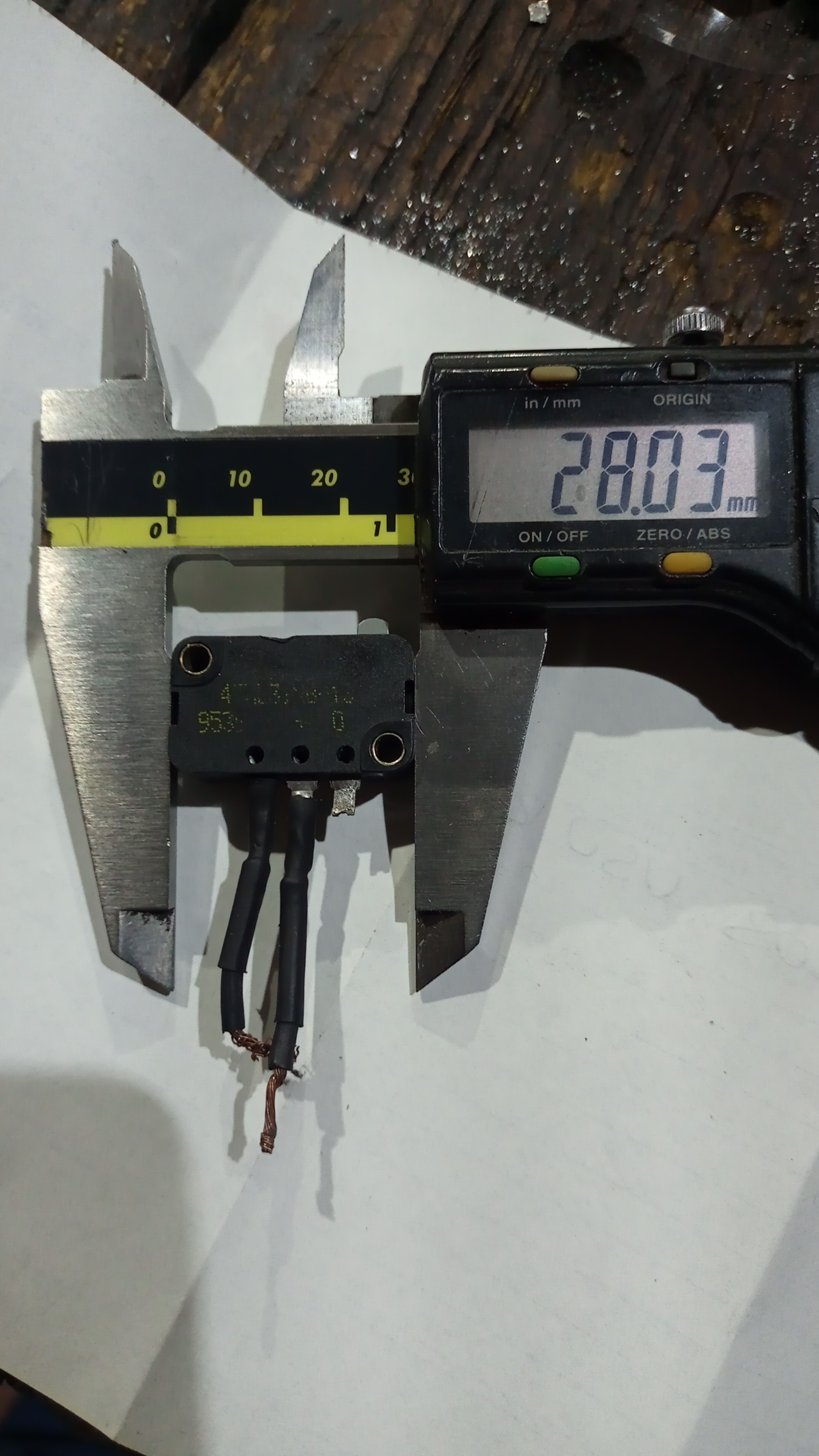

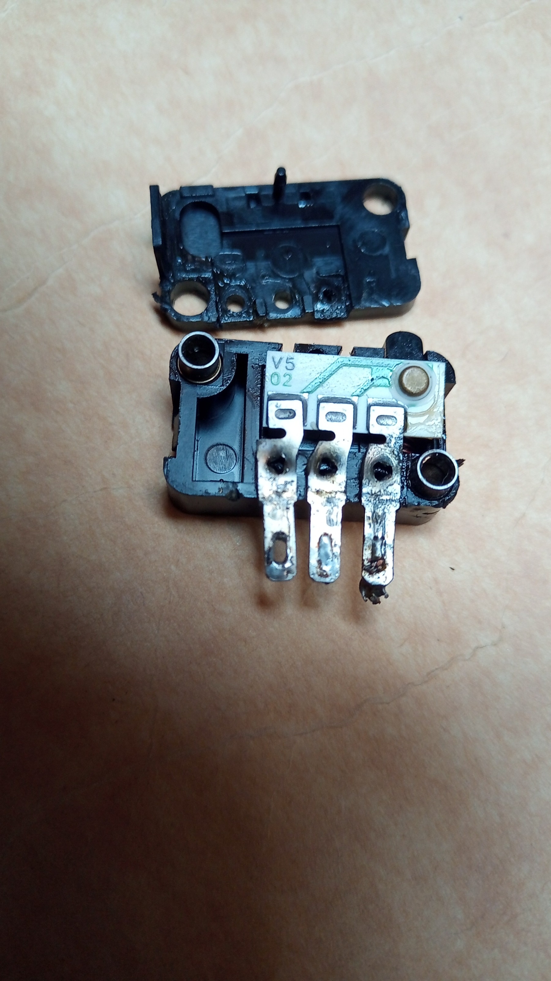

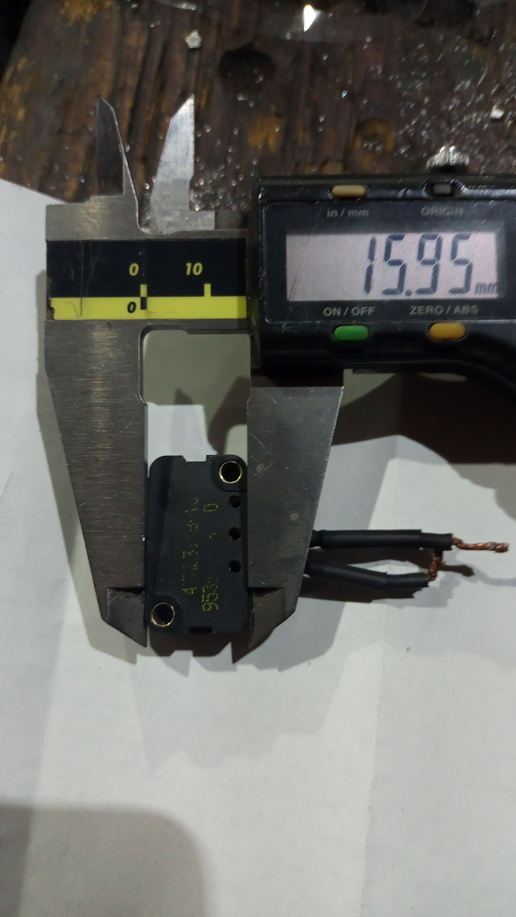

Buenas tardes. Busco micros de límite para hardinge chnc ll 3 piezas que no encuentro, son importantes las dimensiones y los orificios, ya que son guía para su instalación. gracias

Looks like normal microswitches
www.mouser.co.uk/new/honeywell/honeywell-v15-switch/
Try to find Honeywell or Omron or something like that, high quality ones, although the cheap ones work OK but tend to fail easily.
Notice the 3 pins, do not get the ones with 2 pins as the machine might need all 3 pins to work.
