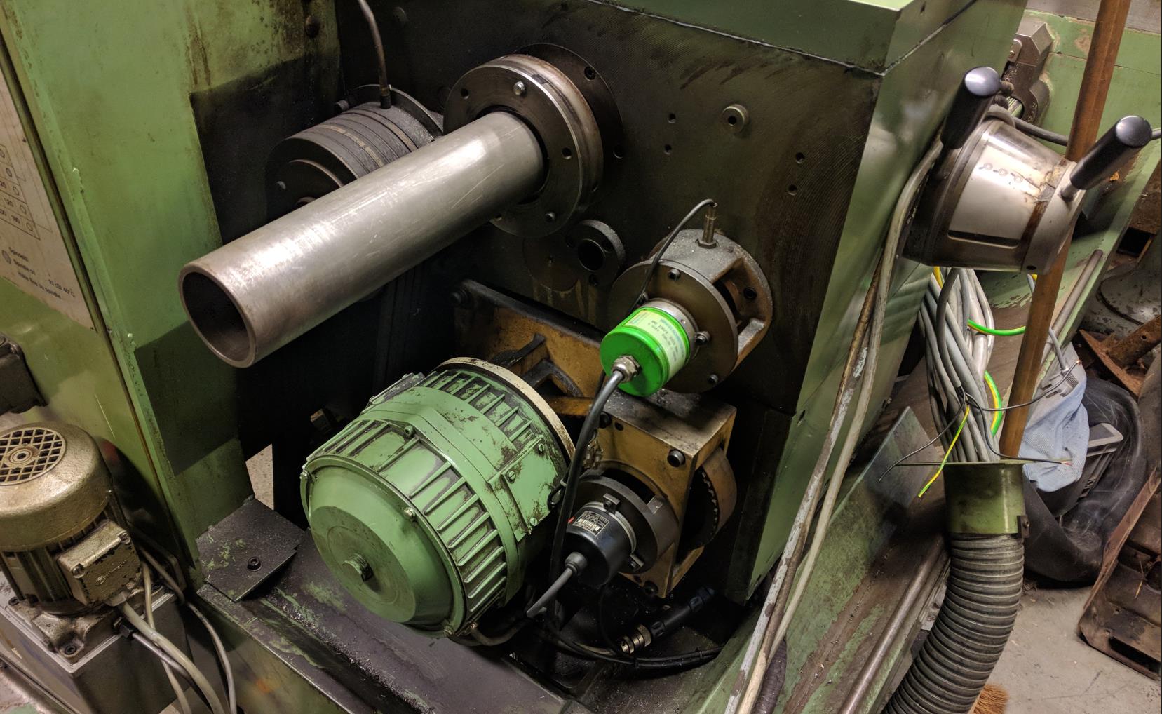

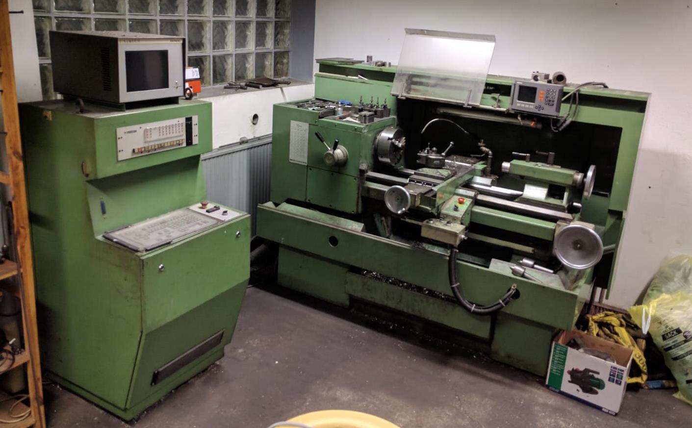

Hi all, I've acuired an old Weiler Commodor 80NC lathe a few years back. The old controller already broke while in operation at the previous owner. They then used some hacks to get the servos working, installed a DRO and used it as a manual lathe.
I would like to get the lathe back to working order using linuxcnc but the lathe has an unusial gearbox. There is dahlander motor coupled with a two speed dual clutch gearbox driving the spindle. Inside the spindle housing there is an additional manual gearbox.

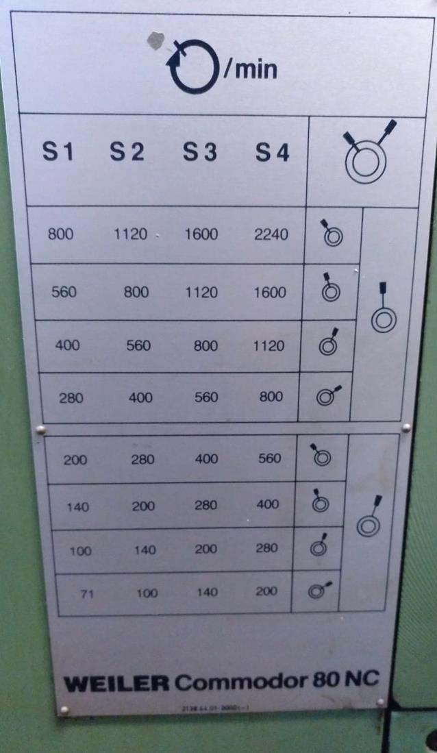

The original cnc-control used the commands S1, S2, S3 and S4 in the cnc-program to control the 4 different speeds of the dahlander motor + gearbox combination. The spindle speed itself is then determined by the setting of the gearbox in the spindle housing. So the gearbox determines a range of speeds that can be programmed in the cnc program.
There is only a rotary encoder + proximity switch connected to a seperate gearbox shaft, so i guess there is no way to just check the gearbox position without adding additional sensors.
Does anyone have a suggestion on how to control this spindle in linuxcnc?

There are several Maho mills with gearboxes that have been retrofitted with LinuxCNC on this forum, might have a look at those for ideas.
The easy way would be to use a VFD and change gears manually, but that defeats the purpose of having a CNC.
Take some pictures of the gearbox, inside, and post them here, there are plenty of really smart members here that might just get a push in the right direction.
