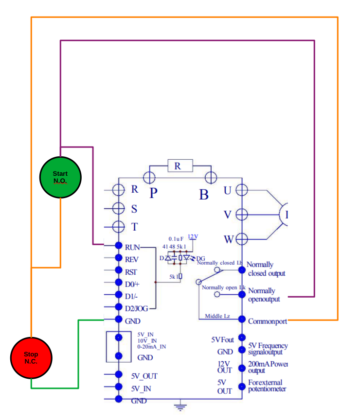

Hello, I've bought my first VFD, a Vevor A2 8015 1.5kW model, for a 0.75kW, 1000rpm motor for my mini lathe. I've configured the most basic options and added an external potentiometer and a 3-position switch for forward and reverse.
I'd like to add two momentary switches, one for start and one for stop. Is that possible with my VFD? Can anyone help me with this?
I've attached the manual.

- NWE
- Posts: 273
- Thank you received: 86
12 Dec 2025 22:50 #340036
by NWE
Replied by NWE on topic VFD configuration help
If you use a normally open start button and a normally closed stop button, it appears it could work to set parameter 28 = 2 to make its signal relay operate when the inverter starts. Then it should be possible to wire it similar to a contactor with an aux. contact.
The following user(s) said Thank You: tommylight, Ismacr63

13 Dec 2025 10:05 - 13 Dec 2025 13:45 #340056
by Ismacr63
Replied by Ismacr63 on topic VFD configuration help
Thanks for your reply. That works fine, except I can't use the three-position switch for forward and reverse.
I've also noticed that when I press the stop button, I have to hold it down until the motor stops completely. If I release it before the motor stops, it doesn't stop and the RPMs increase again.
