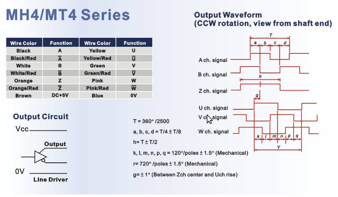

21 Jun 2011 15:32 #10704 by machete
PCW wrote:
Your calculations look correct (for TTL) but I would again strongly suggest that you use differential encoders...
ÎÊ!
What you can say about this encoder: MH4-25LN65CA8
www.delta.com.tw/product/em/motion/motio...ROE_catalouge_en.pdf
Features
ROE-M Series is a commutation encoder which is designed for servo motor. It can not only output the signals of A,B, Z phase but also can detect the U, V, W signals of servo motor for commutation. There are 4, 6, 8, and 10 pairs of magnetic poles for user’s selection.
MH&#65288;Hollow Shaft&#65289;MT&#65288;Through Hole Shaft&#65289;
Specifications
&#8231;MH Series: Outer Diameter of Hollow Shaft: 38.7mm
&#8231;MT Series: Outer Diameter of Through Hole Shaft: 38.7mm
&#8231;Resolution: 2500ppr
&#8231;Output Form: Line Driver
&#8231;Power Voltage Range: 5-12V
&#8231;Responsiveness: 300kHz max
"Output Form: Line Driver" - means differential encoder?
And what is "U, V, W signals" - do i need it?
21 Jun 2011 15:39 #10705 by andypugh
They would be the three signals, normally from Hall sensors, that allow you to commutate brushless motors.
For some applications I can see that being extremely useful.
21 Jun 2011 15:45 #10706 by machete
andypugh wrote:
But i have brush motors - so, can i just ignore this wires?
21 Jun 2011 16:21 #10710 by andypugh
machete wrote:
[quoteBut i have brush motors - so, can i just ignore this wires?[/quote]
Yes, or get an encoder without them.
I think that this encoder might have differential outputs, and is cheap:
www.slidesandballscrews.com/hkt300635301...-p-494.html?cPath=88
The data sheet uses an "E" as the last code letter to identify voltage output, so perhaps "L" is line driver?
Note that in that encoder model the 1000 and 1024 line versions do not have an index (Z) line.
