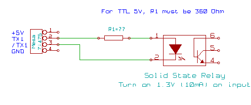

As well, how can i connect 7i47S outputs to "solid state relays", like this, for controlling solenoids:

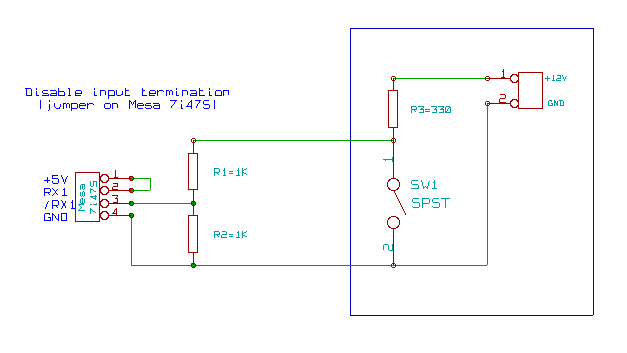

OK is that correct?
(blue box is my sensor)
Last edit: 22 Jun 2011 11:45 by machete.

Like this?

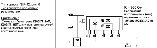

And should i leave R1=360 Ohm, like in case with TTL +5V logic?

On the inputs, yes its OK though I would probably use 3.3K for R2 so the threshold is closer to 6V (with the current 1K,1K, and the added 330 series resistor, the threshold is a bit too high
On the outputs, that will work fine except you will reverse drive the SSRs LED when off. If the SSR has a reverse input protection diode, this is fine. If not you can use just one of the TX outputs and ground to drive the SSR

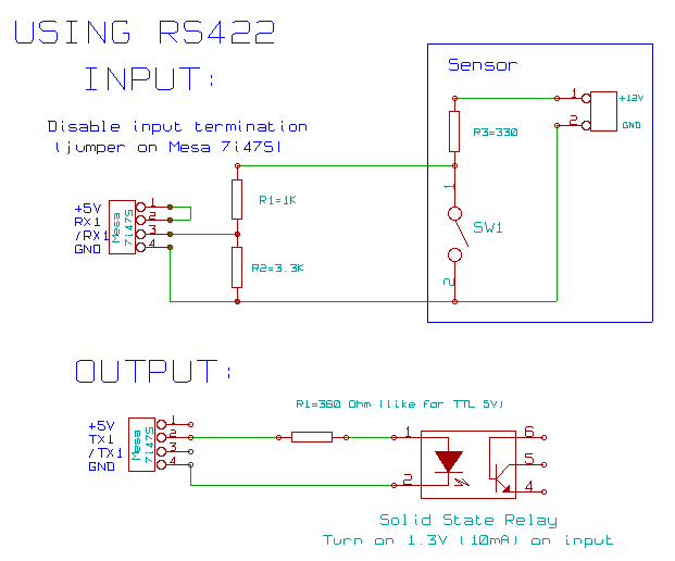

22 Jun 2011 15:15 #10770 by machete
So, this version must be perfect?
22 Jun 2011 15:57 #10775 by PCW
yes, looks right to me
