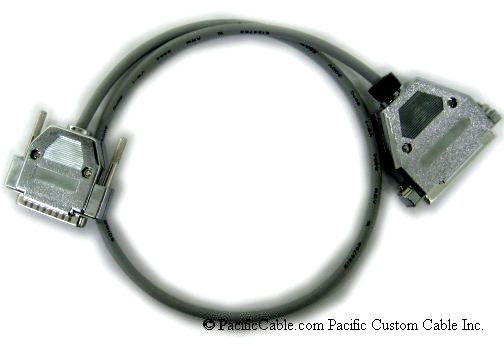

I am trying to find some info on how to get my EMC2 software to comunicate through a cio dio 24h board.
As I understand it I have to write or modify a driver for Ubuntu and even then It will not work properly with HAL.
I found an adapter cable online that wil fit the db37 port on my servo board and will connect directly to my db25 parallel port on the back of my computer.
My question is
Has anyone tried one of these Adapter cables? And if so did they have any luck?

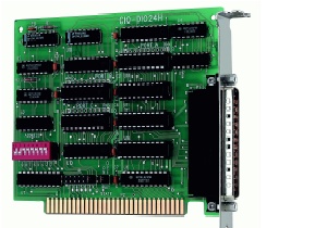

Is this the board? If so, it looks like an ISA card from the picture.
www.piclist.com/techref/microchip/debouncebeeptoggleK8HL.htm

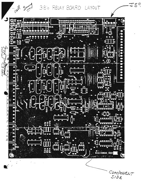

Here is a link to the DIO CIO 24H Board I am hoping to by pass.
mccdaq.bentech-taiwan.com/mcc/manual/cio-dio24h.pdf
It is connected to the "386 RELAY BOARD" via a DB37 cable
below is a diagram of the "386 Relay Board"
I haven't been able to find anything on this Relay Board online. YET!
I am still looking.
I am still looking.
- patburden
- Posts: 11
11 Aug 2011 02:13 #12397
by patburden
Replied by patburden on topic Re:issues with cio dio24h board
- btvpimill
- Posts: 213
- Thank you received: 3
11 Aug 2011 02:57 #12398
by btvpimill
Replied by btvpimill on topic Re:issues with cio dio24h board
Not wanting to be the bearer of bad news, but I think you have some pretty significent hardware to be able to omit the interface card. I hope to be wrong and corrected, but here goes.
first issue is this: from the parallel port you can only get 12 outputs when using it without any interface card attached. so you will need to decide which of the other 12 functions on your relay board you are not going to use.
next problem, the signals from the port are only TTL (I think) at best. So you will need to be VERY sure the load needed to drive the stuff on the card you are connecting it to.
third issue: seeing as there is poewr connections in the cable listed in the manual, I am guessing the card you want to use gets power from the interface card you want to bypass. The parallel port has no power connections.
Having said all this, if you can live with the first issue, and the second issue is a non-issue. assuming you can provide the power to the card, this can be very easy from EMC's point of view. Just set it up with a HAL config file to define the output pins as you need them.
