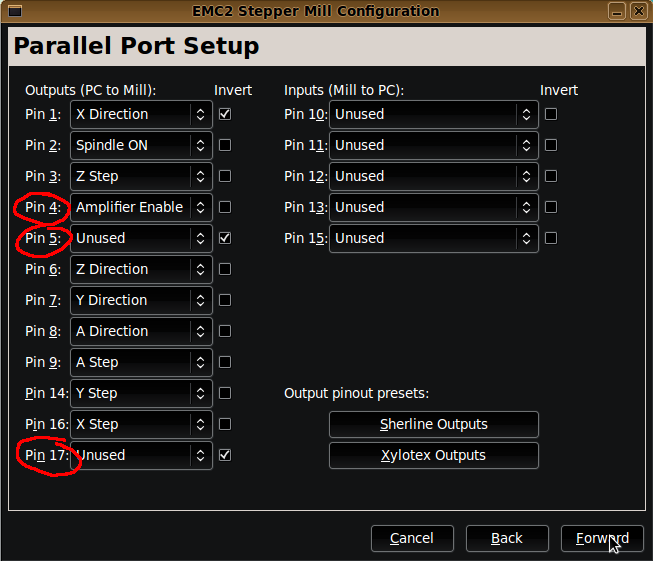

Hi!
I try to setup popular and cheap one of "TB6560 CNC Stepper Motor Driver Controller Board" in EMC2.
This boards widely available and looks that all have similar schematic and pinout. They can be standalone, or can have LED display and keypad. These boards, unlike others, have three different enable signals (both 3- and 4-axis has three). When i try to setup it in Stepconf Wizard, i tie 'Amplifier Enable' output signal to all three pins, but it outputs correctly only on one pin (first by nubmer). Can it be fixed?
Partial solution is mark this pins as Unused and Inverted, but this work only during configuration wizard, and pins don't drive continuous '1' in EMC2.
For reference i post working pinout configuration, but it work only if i drive Enable signals manually. It is not good idea due to idle current draw. It is pins 4, 5 and 17.

Replied by jpka on topic Re:3-4 axis TB6560 controller: "enable" wire question
Thank you, it exactly what i need!
I modify .hal file manually and all 'enable' wires now work very good
BTW, pinout on my picture is for "blue" 4-axis board, i write this because i now see that cheap boards are very different in pinouts and it's not documented at all, while they looks very similar.

This is the solution i found for a 3 axis TB6560 board:
- create a basic configuration using stepconfig leaving enable pin out. (the stepper will still not run);
- Add the following three lines in custom.hal
net xenable => parport.0.pin-14-out
net yenable => parport.0.pin-02-out
net zenable => parport.0.pin-06-out
Now you can reopen stepconfig and work with the settings as now the stepper will run correctly.
