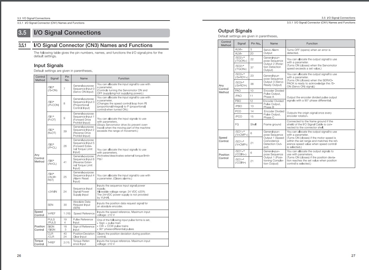

07 May 2020 02:06 #166924
by Becksvill
Replied by Becksvill on topic Re:Mesa 7i77 differencial encoder connection.
hey peter
just a quick question on this same issue this thread is the closest thing to what I want to know.
I have the same setup as above. I am using my servo drive to output the encoder outputs to the mesa 7i76 spindle encoder card.
as far as I understand the drive powers the encoders and the mesa card doesn't need 5v connected.
so here are the questions:
1 do I need to use a signal ground at all if using differential encoder signals?
2 I am currently powering the 7i76 5v logic power from 5i25 is that going to be a problem if connecting encoders?
I will attach a screen shot of the encoder stuff in the manual.

- Posts: 19902
09 May 2020 10:39 #167138
The input common-mode range for the encoder is -7 to +12 volts relative to signal ground. You night need a common gnd to ensure that this is not exceeded.
Measuring the gnd offsets with a multimeter might be worth doing initially.
Replied by andypugh on topic Re:Mesa 7i77 differencial encoder connection.

09 May 2020 23:26 #167188
by Becksvill
awesome! thanks andy
that is a very good piece of info to know
I just checked between the 24v io ground on the mesa card and the logic power ground and they are within 1.5 v
So I am good to go.
connecting up now.
regards
Andrew
