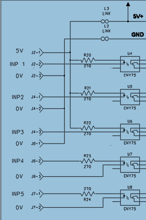

For pull down read pull up, then you find
www.linuxcnc.org/index.php/english/compo...tid=9&id=19622#19662
That is probably what you read, the last entry from Peter Wallace refers to it.
The crux of it is that the G540 appears to need an amperage to activate the charge pump that you are not going to get from a 3.3v parport
or possibly from a 5v one in other than EPP mode
There is no 'option' as such, you would need to wire it.
It was suggested that a separate 5v source and a 470 ohm pull up be used, presumably with the parport pin operating an opto-isolated switch.
Quite a lot of BoBs now allow you to source your own supply for several pins on the board in this way, rather than use the on-board 5v current limited supply.
An example is www.diycnc.co.uk/uniportV2.pdf
If you have just soldered direct into the parport cable, well you would have to change that.
Makes sense to use a BoB, for the outage protection it gives anyway.
