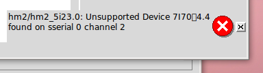

Im getting ready to fire up the new system
its a 5i23 running a 7i33 and a 7i44 (which has 2to 7i64s and a 7i70)
Is there a svss4_8 firmware for that setup?
Cory
Cory

clkeck1 wrote:
I have attached one of the many versions of svss8_8.bit that I have lying about on my PC (which I was using until deciding I needed one with a 7i39 pinout too).
Not in the default set. (I am not sure why).Is there a svss4_8 firmware for that setup?

Replied by PCW on topic Re:5i23 with 7i33 and smart serial firmware question
What version of LinuxCNC are you running?
Sounds like it may not be new enough
to support the generic sserial devices

- Posts: 23411
- Thank you received: 4975
04 Jul 2012 20:09 #21573
Replied by andypugh on topic Re:5i23 with 7i33 and smart serial firmware question
clkeck1 wrote:
That ought to work. Can you do the following:
Open two terminal windows.
Window1: halrun
Window1: loadrt hostmot2 debug_modules=1
Window2: sudo echo 5 > /proc/rtapi/debug
Window1: loadrt hm2_pci
Window1: exit
Window1: dmesg
And paste the dmesg output here ?
I used my old install CD and then updated to 2.5
Window1: halrun
Window1: exit
Window1: dmesg
if you run linuxcnc from the command line what version does it print?
I'm still running 2.5pre2 and it works fine here (just tried)

[ 24.309455] hm2/hm2_5i23.0: Smart Serial Firmware Version 23
[ 24.362353] hm2/hm2_5i23.0: Unsupported Device 7I704.4 found on sserial 0 channel 2

[ 90.993661] RTAI[sched]: Linux timer freq = 250 (Hz), TimeBase freq = 1800016000 hz.
[ 90.993666] RTAI[sched]: timer setup = 999 ns, resched latency = 2943 ns.
[ 90.993793] RTAI[usi]: enabled.
[ 91.084645] RTAI[math]: loaded.
[ 119.834484] hm2: loading Mesa HostMot2 driver version 0.15
[ 190.333080] hm2_pci: loading Mesa AnyIO HostMot2 driver version 0.7
[ 190.333090] HAL: initializing component 'hm2_pci'
[ 190.333096] RTAPI: initing module HAL_hm2_pci
[ 190.333102] RTAPI: module 'HAL_hm2_pci' loaded, ID: 5
[ 190.333110] HAL: component 'hm2_pci' initialized, ID = 05
[ 190.333167] hm2_pci 0000:05:00.0: PCI INT A -> GSI 20 (level, low) -> IRQ 20
[ 190.333174] hm2_pci: discovered 5i23 at 0000:05:00.0
[ 190.333248] hm2: no firmware specified in config modparam! the board had better have firmware configured already, or this won't work

- clkeck1
- Posts: 108
04 Jul 2012 20:35 - 04 Jul 2012 20:37 #21577
by clkeck1
Replied by clkeck1 on topic Re:5i23 with 7i33 and smart serial firmware question
version is 2.5.0
here is the config line in the hal file
loadrt hostmot2
loadrt hm2_pci config="firmware=hm2/5i23/SVSS8_8.BIT num_encoders=4 num_pwmgens=3 num_3pwmgens=0 num_stepgens=0 sserial_port_0=00000000 "
loadrt hostmot2
Last edit: 04 Jul 2012 20:37 by clkeck1.
- Posts: 18960
- Thank you received: 5236
04 Jul 2012 20:43 #21579
Oh thats a pretty ancient bitfile (sserial V23)
