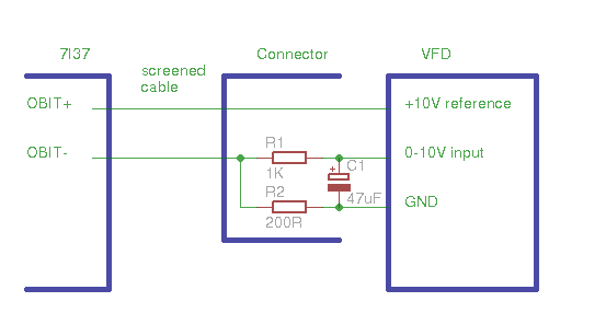

How to drive VFD (0-10V) with PWM signal from 7i37
- machete
- Posts: 64
03 Oct 2012 16:43 #24915
by machete
How to drive VFD (0-10V) with PWM signal from 7i37 was created by machete
- Posts: 19167
- Thank you received: 5302
03 Oct 2012 17:15 #24917
Replied by PCW on topic Re:How to drive VFD (0-10V) with PWM signal from 7i37
Yes the 7I37 outputs are like DC relays so your circuit will work except it needs one more component, a pulldown resistor (R2) to ground on the 7I37 output so you get a 10V pulsetrain.
so 7I37OBIT+ to +10V, 7I37OBIT0- to R1.1 and R2.1, R2.2 to ground R1.2 to capacitor
suggested values R2=200 Ohms, R1 = 1K, C=47 UF PWM Freq = 2 KHz

21 Oct 2012 15:23 #25550
Yes
