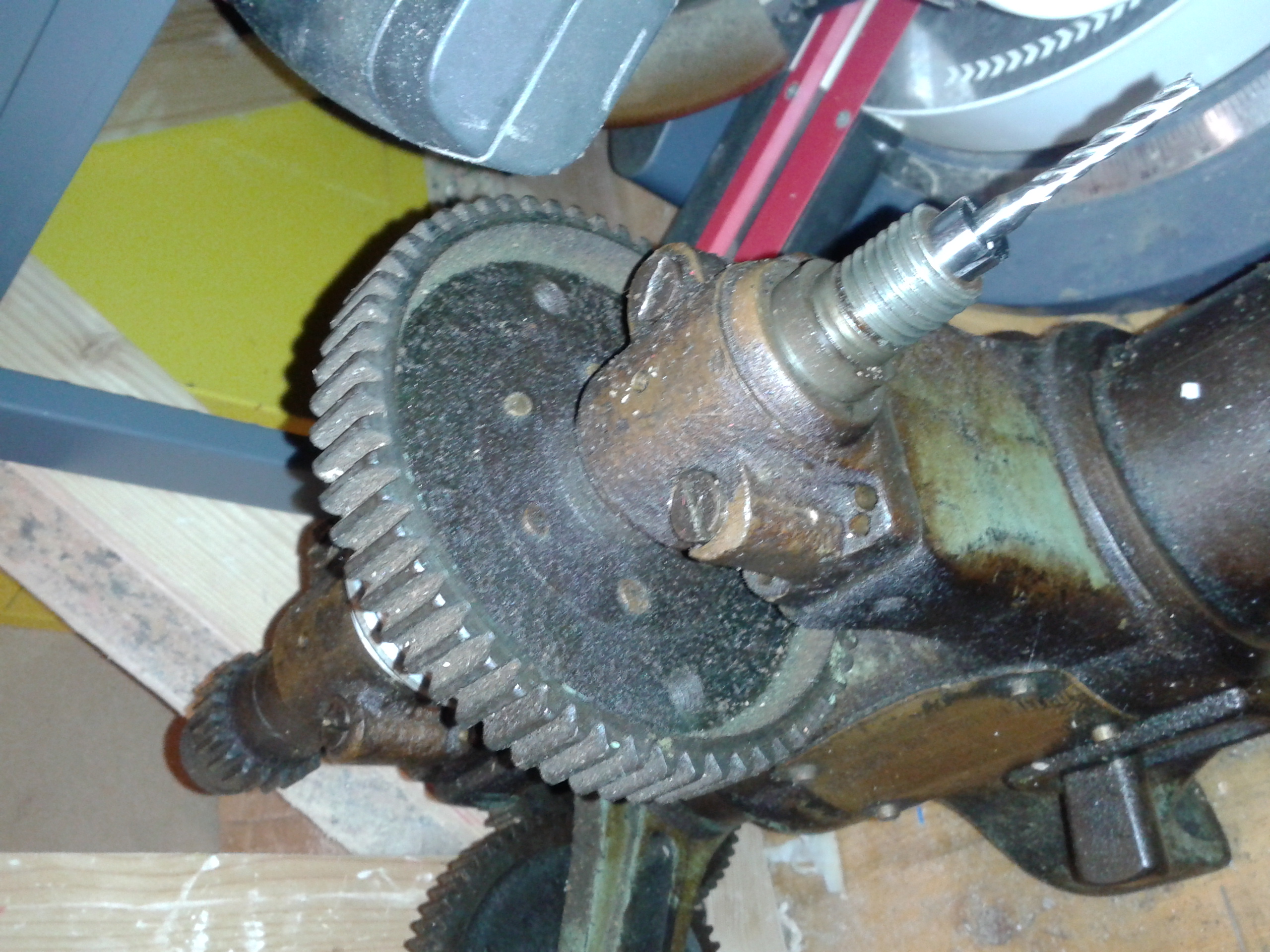

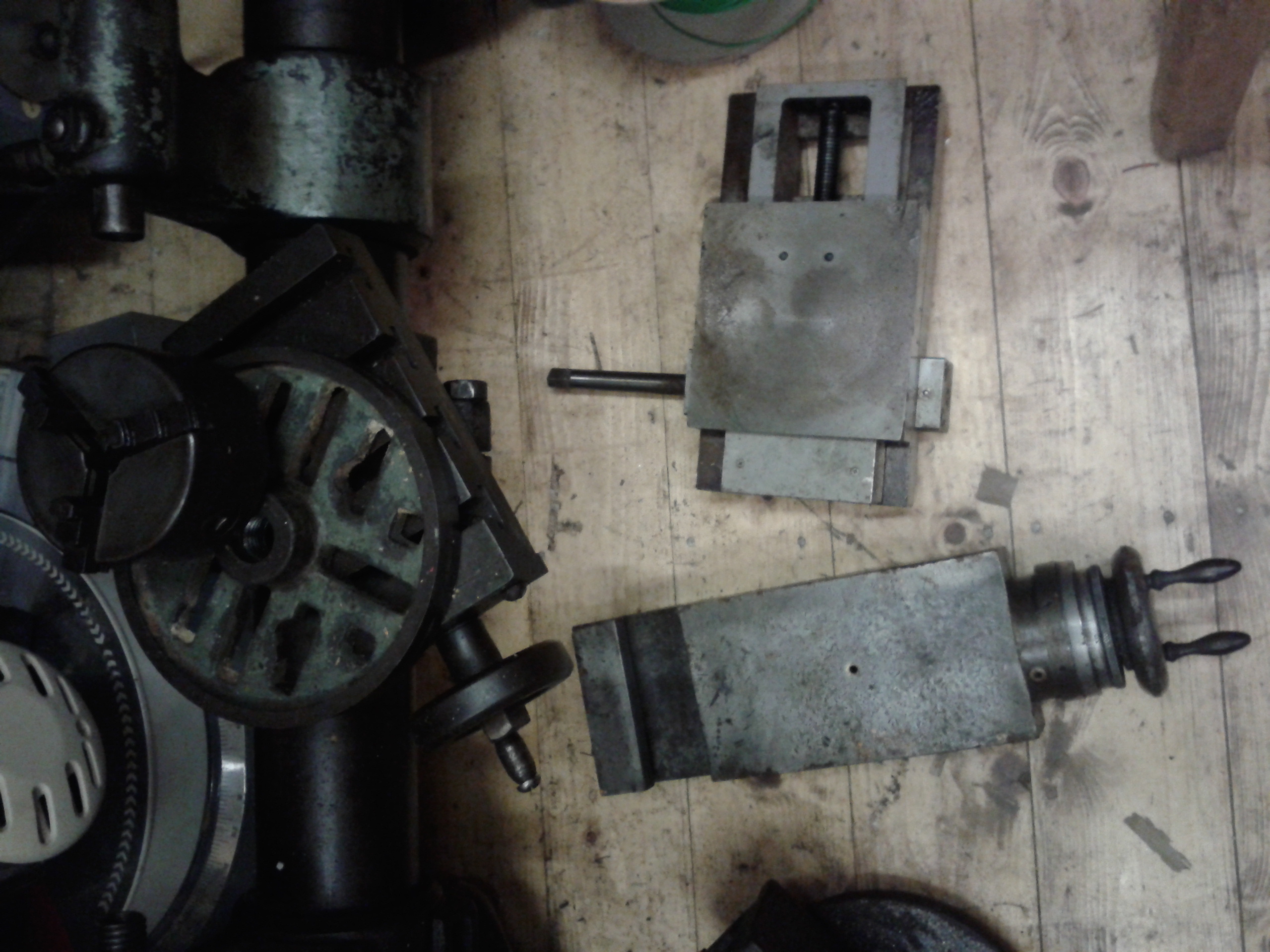

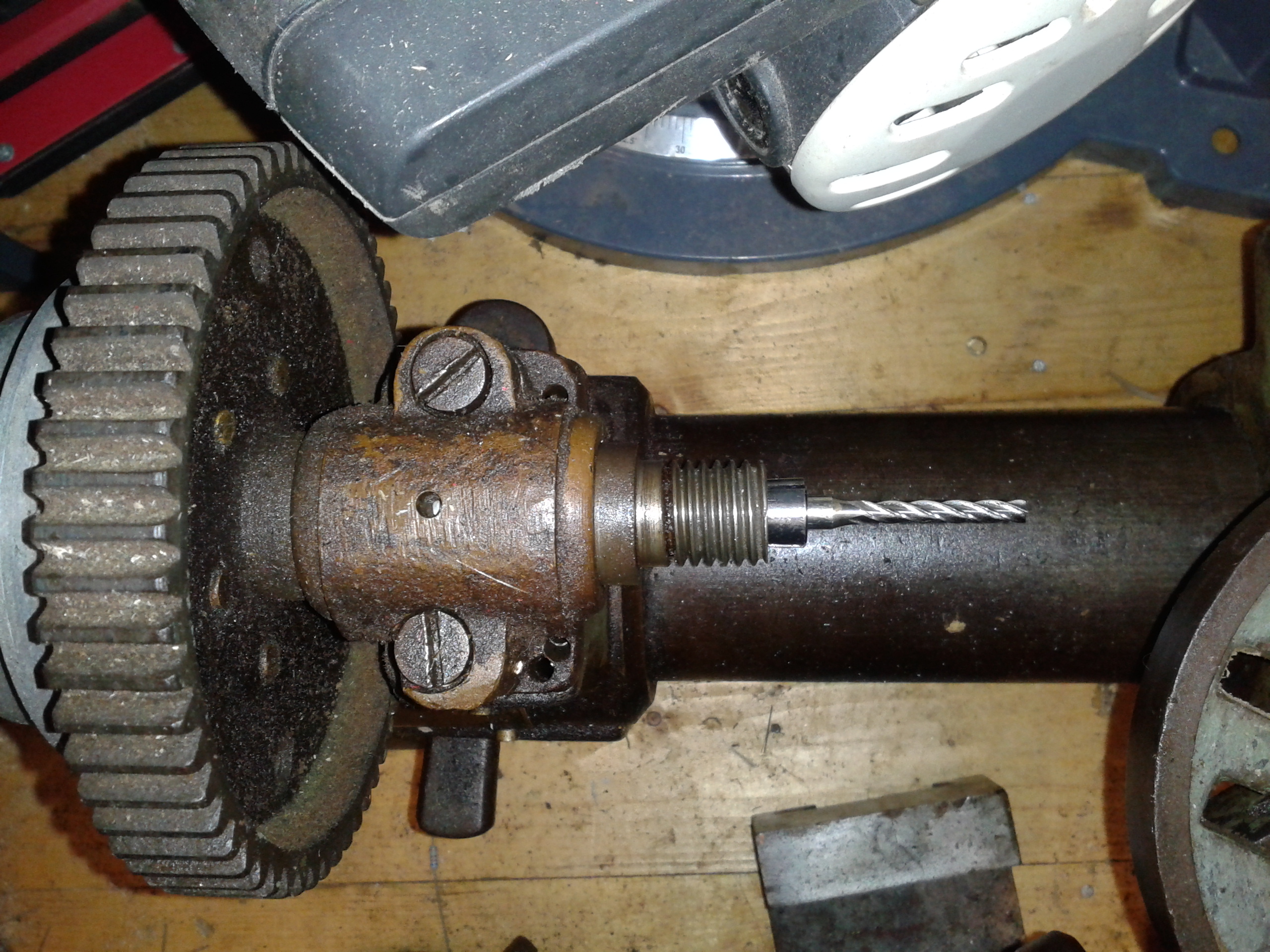

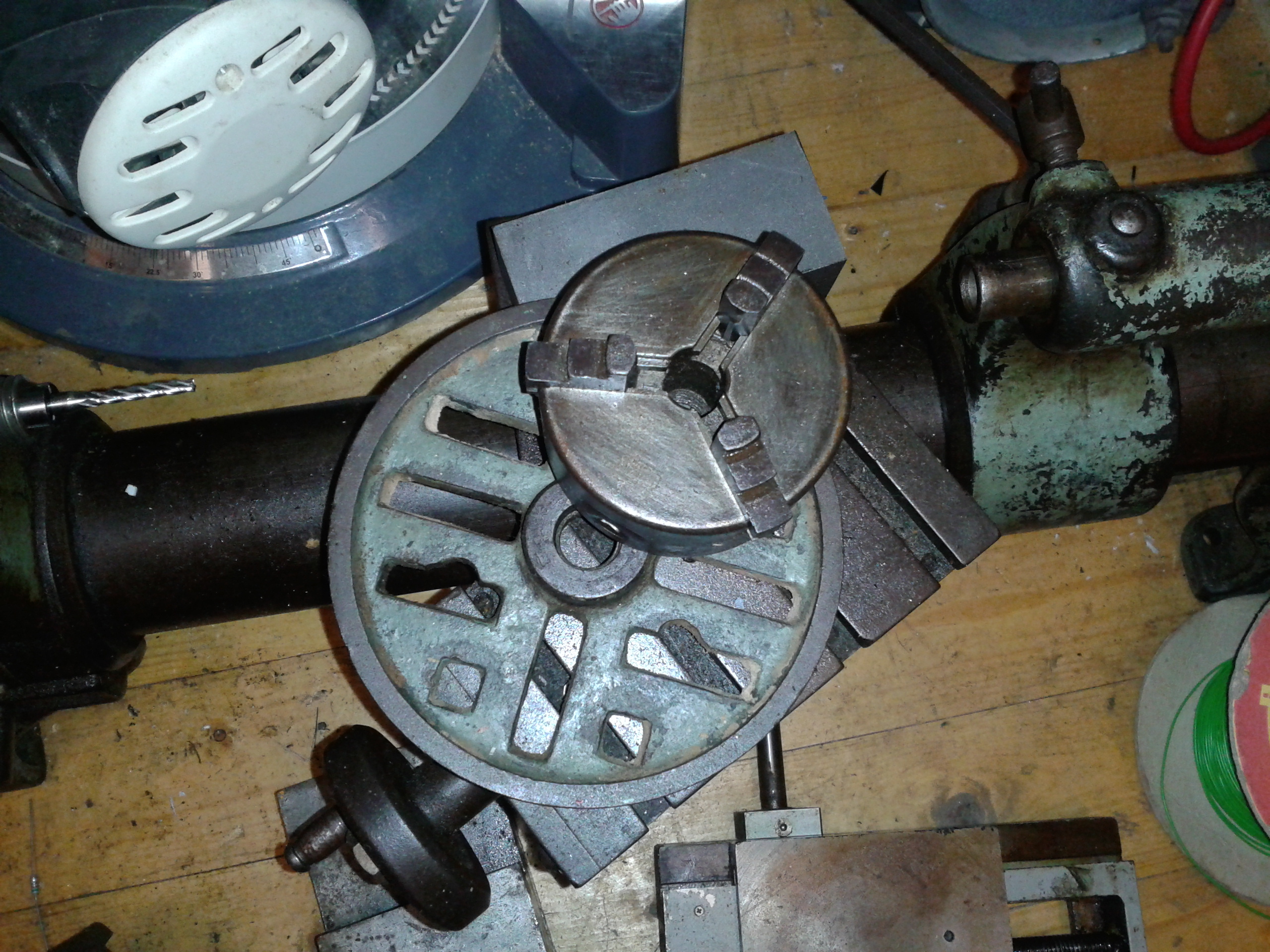

Here are some (poor) images of my machine:
Cross-slides to make X/Y table:
Gear on spindle to be used as Phonic Wheel for spindle speed feedback.
No1 Morse Taper in spindle with 6mm collett (pulled in by M6 Drawbar through spindle)
Faceplate and 3 Jaw chuck with Whitworth thread fit on spindle nose.
Last edit: 15 Mar 2013 10:01 by ScottBouch.
