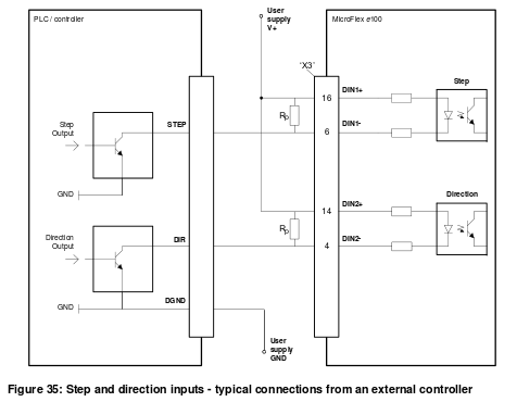

can somebody help me with this i have a baldor microflex drive that ive configured for step an dir input that works as should
the issue is this, i was told that the drive takes 24v inputs so i tried to make a converter with a udn2982, this works somewhat but is making the motor noisy and just doesn't sound good genraly and is also loosing steps i think (running the axis back and forth the same amount) as the drive software shows the positions off only buy a few encoder counts but its off
after a few emails with the drive makers (ABB who have been fantasic with setting the drive up) they have now told me that the drive can respond to a 5 volt signal but im having trouble of how to wire this of if i can im using the mesa 5i25 with 7i76
the suggested wiring is on page 68 of the drive manual

I assume you mean fig 35 which is on page 69. It is a pretty standard DIR / STEP opto isolated connection
It will be whichever connections go to a stepper driver from the on board stepgen.
Unfortunately I don't use the Mesa boards, someone else will have to fill in where the 2 missing wires come from
I think it all depends which firmware you have installed as to which pins are programmed

see page 5-9 of your pdf and connect as per pins 6 for step and 4 for direction , take pins 16 and 14 to 5v supply on 7i76
forget Rp it's not needed ..

just had a go like this and it didnt work ive just noticed this in the manual on page 126 - 8.1.6
active = grater than 12v
inactive = less than 2v
so how can they say it'll work at 5 ?

Looking at the input circuit in the manual and the TLP115A optocoupler data sheet, It looks like it would be marginal with 5V step/dir signals so I can see why its not guaranteed with < 12V signals.
If your level shifters dont work, I would make sure that the pullup resistors are low enough (I would use about 470 Ohm 1W at 12V and 1K 2W at 24V). This is because of the drives input hash filter capacitors and the wiring capacitance
make a RC filter for the high going 12 or 24V pulse
Also since the level shifter inverts the step/dir signals you may want to use the inverted 7I76 outputs (or invert the step/dir pins in HAL)
Because of the slowness of the optocoupler input circuit I would use wide timing margins, certainly no less than 2 usec step times and idle times and similar dir setup and hold times

so im right in thinking i now go +24v via resistor to step input then the step input ground via the 7i76 inverted pin to 24v gnd?
or do the resistors go across the drive terminals ? bettween the 24v in to the step and the step gnd ?

arceyes picture is correct:
+24 to drive 14,16 (DIN+) and one side of pullup resistors
other side of pullup resistors go to drive 4,5 (DIN-)
and level shifter (UDN2982?) outputs
7I76 step/dir outputs go the level shifter inputs
7I76 gnd goes to level shifter gnd

Does this mean the udn2982 is the wrong chip as this is a sourcing driver
Do I now need some thing like a uln2803 an open collector driver ?

Sorry, I had forgotten that the UDN2982 was a sourcing driver. It should work fine but the wiring will be different:
Drive pins 4 and 6 (DIN-) to 24V GND. +24V to UDN 2982 Vs (pin 9)
Drive pins 14,16 (DIN+) connect to UDN2982 outputs and one side
of pulldown resistors. Common side of pulldown resistors goes to
24V GND.
7I76 step/dir outputs to UDN2982 inputs. 7I76 GND to UDN2982 GND
24V GND to UDN2982 GND
