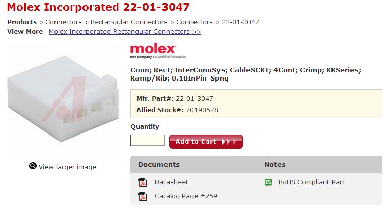

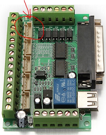

So I bought the chinese board for $14.88 and the C10 board from ATi for $28.04. The Chinese board arrived yesterday and I guess the ATi board should arrive today. Both showed delivery of yesterday from USPS, but the USPS tracking I never trust too much. But measuring on results only, +0.5 extra for expediency for the chinese board. I would have lost a bet that the chinese board arrives first.
Now I need to find the darn connector, -0.5 for the connector issue... I did a little looking and couldn't find the connector and measured the spacing.
My measurements:
Outside pin to outside pin: 8.12mm or .320"
Pin width 0.6mm or .023"
Spacing
Metric (8.12 - 0.6)/3 spaces = 2.687mm
Standard: .106"
Looks like 0.1" spacing or I just can't measure (and add)/subract?? Any help w/ the connector would be wonderful.
I tried attaching picture 2x. Here:

11 Oct 2013 23:07 #39774
by ArcEye
Replied by ArcEye on topic C10 vs KL-DB25 vs Chinese Breakout boards?
Unless I am being stupid, you don't need a special connector, those sockets just mirror the screw terminal blocks in front of them.
A quick check with a multimeter should confirm, there is probably an extra ground pin with the sockets (16 pins versus 15 screw terminals)

11 Oct 2013 23:34 - 12 Oct 2013 00:10 #39776
by FloppyDisk
Replied by FloppyDisk on topic C10 vs KL-DB25 vs Chinese Breakout boards?
Will do later tonight when I get a second.
The issue is that the chinglish on the board doesn't match identically.
On the top by the 5 connectors labeled (X, Y, Z, A, B_), there is +5V, CLK, CW, EN.
On the bottom, it goes like this:
XCLK, XDIR, YCLK, YDIR, ZCLK, ZDIR, ACLK, ADIR, EN, BCLK, BDIR, PWM, PC GND, PC5V, PC5V.
What I take that to be is the the XCLK and XDIR are step and direction and will try that from there.
It's quite the board,
Thanks!
PS I found the connector here from Allied: www.alliedelec.com/search/productdetail.aspx?SKU=70190578
Molex Incorporated 22-01-3047
