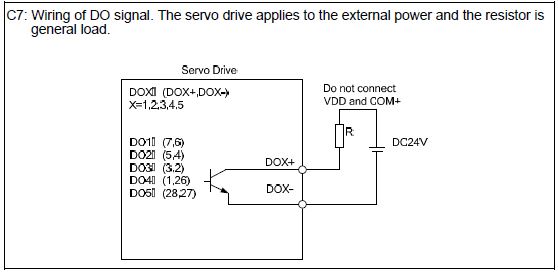

First, the delta drives.
In this example, the Resistor/load would be the 7i77. The field power would connect to DOX+ and 7i77 input pin would connect to DOX-
The "load" (7i77) would be on the ground side of the circuit, opposite of the example. (Not sure if this is correct, but I am guessing it is, as the DMM picture shows it this way, and it uses photocoupler outputs, looks like a transistor on the delta) Please correct me if I am wrong!

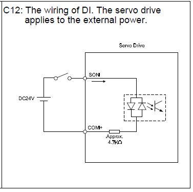

In this example, field ground would connect to COM+ and 7i77 output pin would connect to servo DI pin.

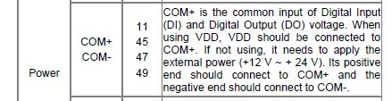

This seems fine, makes sense to me. However when digging further into the delta manual, I find this:
Now I am confused! The example shows COM+ being connected to power supply ground, for "PNP transistor, common emitter (E) mode, (SOURCE mode)"
This is the previous example I just listed (delta diagram2.jpg). However it clearly says that COM+ is to go to external power, and COM- is to go to external ground.
Also, it says that COM+ is common with the digital output voltages, but they have their own + / - terminals. WTF?!

The Delta output to 7I77 input looks right (and its hard to damage the 7I77 inputs outside if putting 120/220VAC on them)
It looks like the Delta inputs use AC OPTOs so are not sensitive to polarity in
which case COM+ goes to field GND (common) and SON etc go to 7I77 outputs

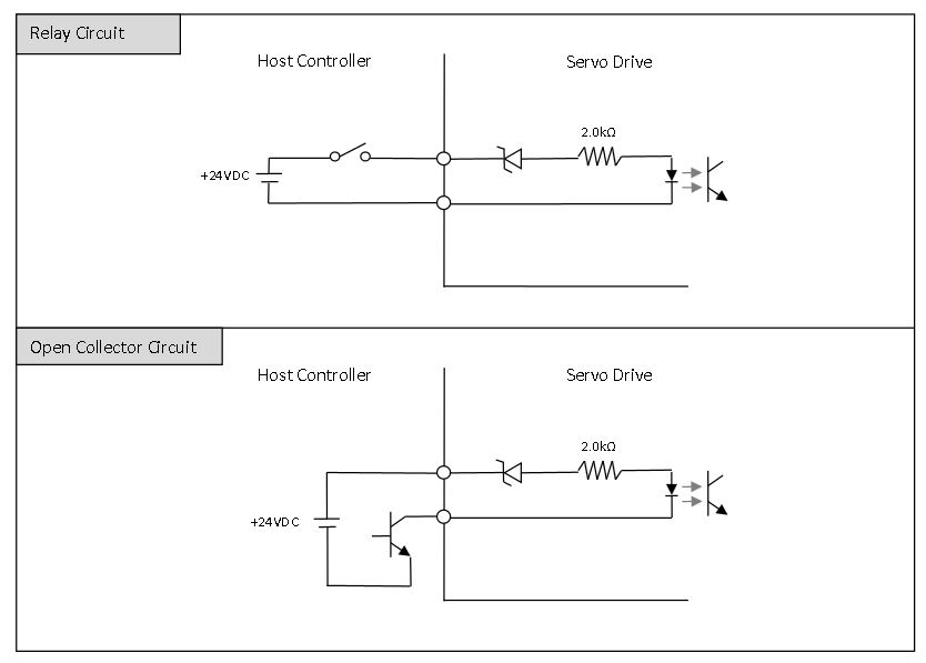

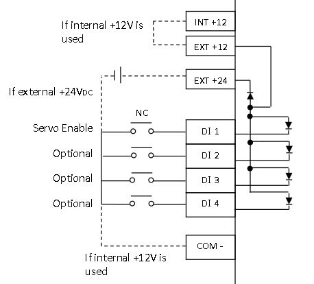

Here is a diagram from the manual showing digital input wiring
I believe the diode shown in the drive connected to EXT +24 is a misprint, should be reversed, and possibly missing a diode on the EXT+12 line.
This would be fine if I had active low 7i77 outputs (I cant do that right?)
Further in the manual there is a diagram showing + voltage being switched, but no Pin assignments shown.

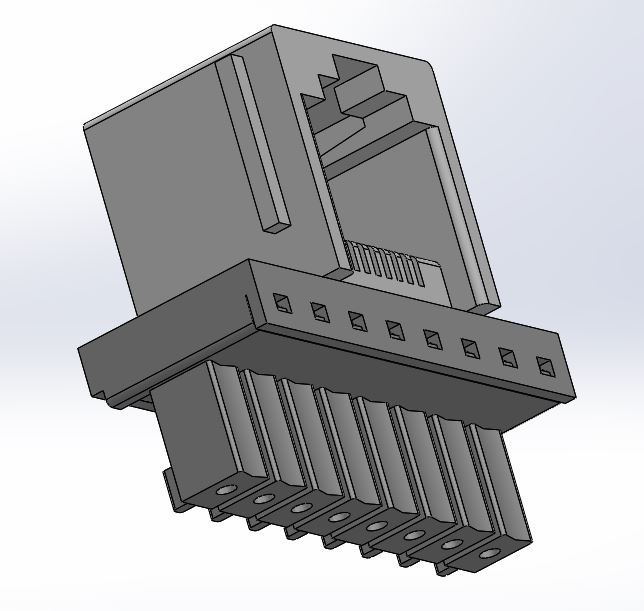

A rj45 breakout board that plugs into the encoder terminals on the 7i77.
I will try to make my own, with jumper wires to the 7i77, and to the servo drive, to simplify wiring, and make less chance of mistakes in case I ever have to remove or change any components in the future.
That is, unless you think that is a bad idea.

Unless you are talking about RJ45 to 3.55mm pluggable, similar devices to this: is 5-15$ on ebay or even cnc4pc. I'm sure you could find something similar at a local electronics hobby/supply store for about the same price.

One that plugged into the smart-serial terminals would also be rather handy.

I was thinking something like this.
I understand it would be a huge job to produce these, but thought I would throw it out there.
