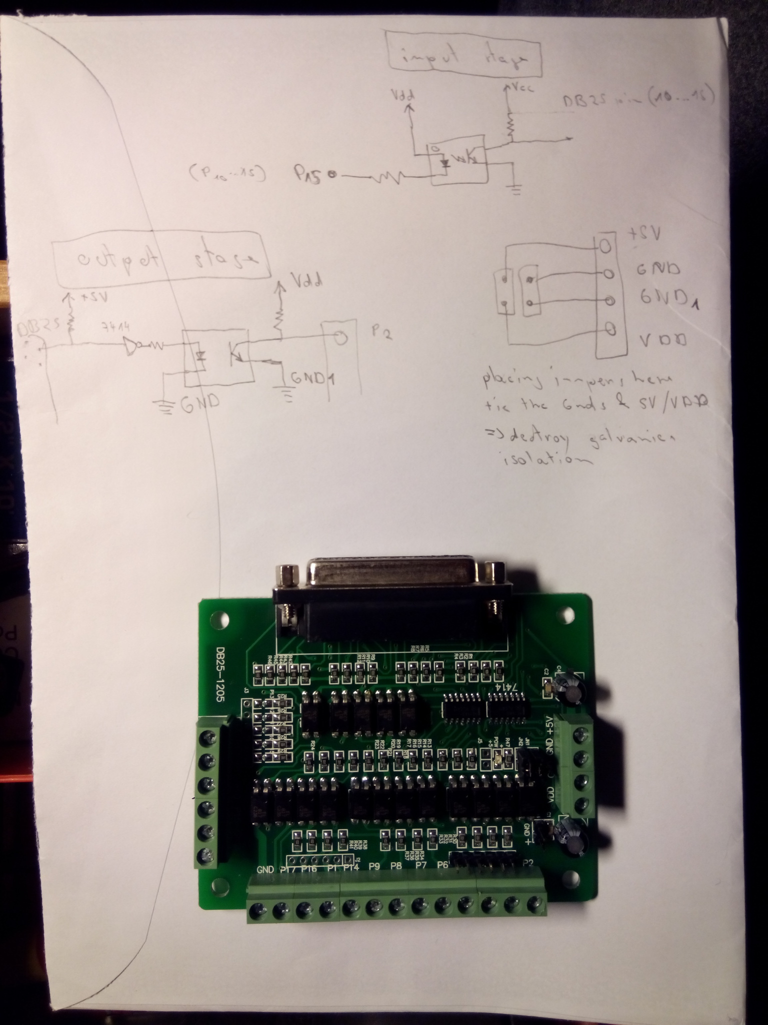

Hi all,
I am placing this really not as a question but because I found many questions about those cheap breakout boards online. So this might help someone.
I had a minimill running with one of the new TB6560 (V4, the fixed boards) and a Mesa 5i25 with Prob_RFX2 firmware (no additional daughterboard needed). Now I a migrating to a bigger mill, thus new stepper drivers, in my case DQ2722M and DQ860. The breakout board of course came with no instructions.
One thing I noticed that I think many people miss, is that the breakout board is supposed to isolate galvanically the computer from the power side, however the breakout board comes configured in a way that ties both sides ground and power supply ! Notice on the photo, the two jumpers close to the +5V, GND, GND, Vdd terminal. Those tie +5V with Vdd and the two GND together. The proper way to use such a board is to remove the jumpers, then provide +5V and ground from a separate PS or the internal PC power supply, then the other GND and Vdd connect to a second power supply (or one of the stepper supplies if it has 5V or more)
Another issue is wether the outputs are inverting or not. In my case, there are 7414 inverters after the parallel port.
The input and output stages are drawn in the photo attached.
I hope this will help somebody !

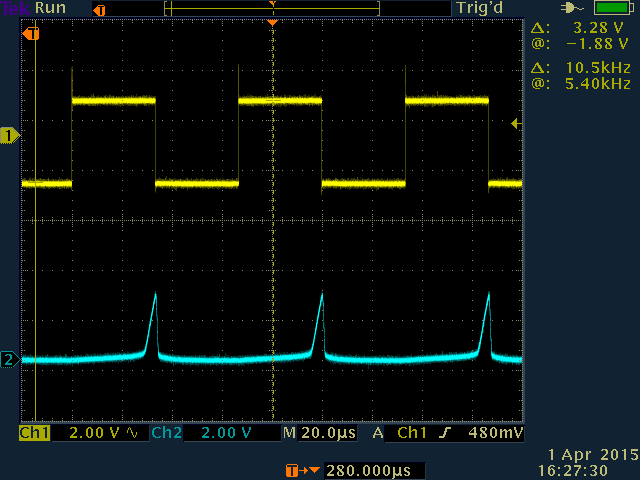

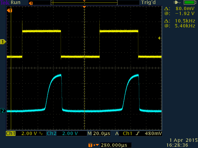

03 Apr 2015 15:40 #57473 by brainwave
Replied by brainwave on topic DB25 breakout board
for my own edification I took some oscilloscope traces of the breakout board signals with the original opto couplers, see below traces at 10kHz and 15kHz... pretty bad huh ? seriously, above 2-4kHz, those boards are unusable !
