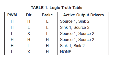

I have a Mesanet 5i20 based system using a small SBC. DC brush motors driven with 3
LMD18200
Using the 2.8-pre vesion with latest updates. In cleaning up the wiring rat's nest, the system has quit!
So, lots of frustration. I think I have a grounding problem but I am not sure (mechanical here, not electrical).
I set up a small single axis (single motor) system on my desk with an a different SBC. Works fine. Disconnect the sytem from the SBC keeping the motor, power supply, breakout board, and LMD18200 drive in one piece. Take it to the shop, attach it to the mill SBC and it does not work!!!!
I have isolated the entire shop system to one SC circuit. no joy yet.
I am using the same configuration files, stripped down to be single axis. no joy.
I am at a loss. Any ideas would be greatly appreciate. I need the mill to run 'cause there is a paying project waiting.
Help please.

11 Mar 2015 06:39 - 11 Mar 2015 06:54 #56651
by Roguish
Replied by Roguish on topic a very odd problem.....
Peter. no Lcnc is fine (as far as I can tell).
the motor does not run.
I have been checking the pins. the 18200 takes a pwm, dir, and 'brake' signal.
pwm and dir are fine (I think) i have put the pwm on my scope and it looks ok.
dir goes up and down as it should for the cw or ccw motion.
I have the brake on the NOT ENABLE pin. it goes up and down also. up to 3.3 down to .01 v measured relative to the 5i20 5v source ground. (i hope that is how it is described)

Ok, I got that. Thanks for the setp parameter. I am running these at 24v and am current limited by my power supplies, though I have just purchased a new PS just for this. How can I make sure the PS (motor power) ground is common to the logic signal coming from the 5i20?
and how can I start up with Low signals?
for the startup, how about setting DIR to the X state? looking at the Logic Truth Table (page 6 of the pdf) if DIR is X (high impedance? right?)
Use the .is_output and/or .is_opendrain ???
start up with PWM low, DIR X and brake HIGH???
PWM Dir Brake Active Output Drivers
H H L Source 1, Sink 2
H L L Sink 1, Source 2
L X L Source 1, Source 2
H H H Source 1, Source 2
H L H Sink 1, Sink 2
L X H NONE
L X H NONE
Last edit: 11 Mar 2015 08:55 by Roguish.
