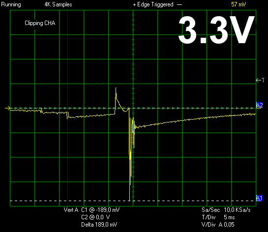

04 Aug 2015 03:17 - 04 Aug 2015 03:19 #61146 by jtc
Replied by jtc on topic Mesa 5i25 not found
Looks like my psu (Corsair Builder CX430 V2 430 W) have bad reputation on 3.3v rail
www.techpowerup.com/reviews/Corsair/CX430_V2/6.html
:sick:
Last edit: 04 Aug 2015 03:19 by jtc.
04 Aug 2015 07:59 #61152 by PCW
Replied by PCW on topic Mesa 5i25 not found
It _is_ possible to make the 5I25 get along with poor 3.3V power supplies by moving the 47 Ohm resistor
from location R6 to location R5 ( so FPGA reset comes from PCI reset instead of the local 3.3V
power good sensor that trips at a nominal 10% low )
The following user(s) said Thank You: harindugamlath

25 Aug 2023 21:21 #278958 by HenrikWJ
Replied by HenrikWJ on topic Mesa 5i25 not found
Had a 5i25 with two constant red leds. Replaced PSU. Works.
Have a virtual beer on me!
