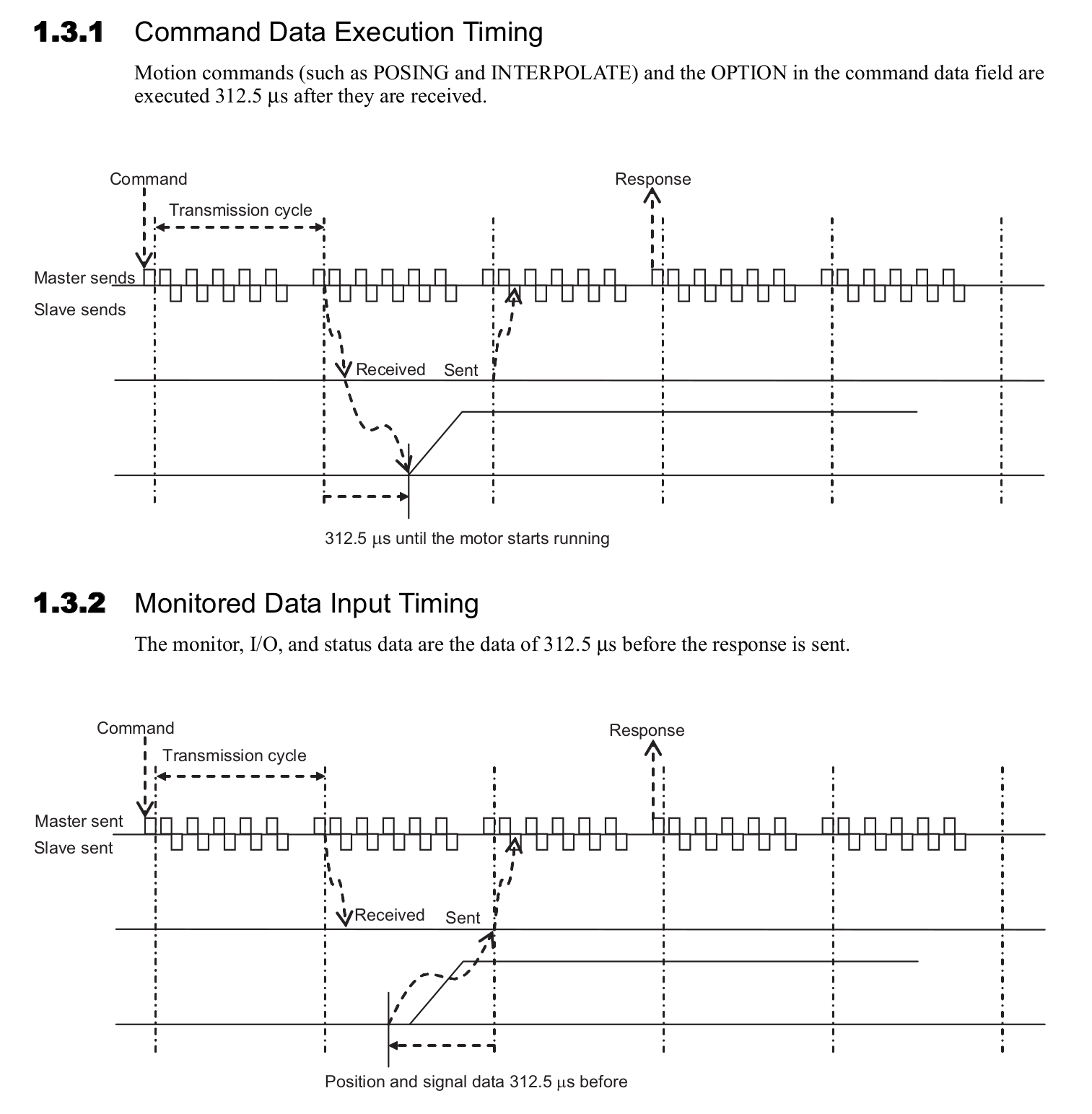

- dm17ry
- Posts: 212
- Thank you received: 91
10 May 2020 16:42 - 10 May 2020 16:45 #167305
by dm17ry
Replied by dm17ry on topic MECHATROLINK-II interface
answered via email, duplicating here for the reference
yes, amps do answer with a 2 cycle delay. picture from the manual attached
my card firmware supports parameter reading/writing while servo is on, i just omitted it for simplicity.
but i doubt SGDM drives support M-II. but i could take on implementing it if there's a reason to do it. i have the hardware on hand for debugging.
