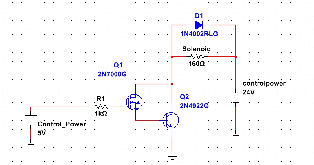

I am getting further on my retrofit,
I need 8 SSR's that will handle a 24vdc 150mA inductive load. Paying $31 a piece for the Crydom SSR's seems overkill
Do you guys have any other solutions ? I have been thinking about finding a MOSFET that will do the trick and build the boards and add the additional circuitry to make it work correctly.
Thanks!
Thanks!

30 Dec 2015 02:42 - 30 Dec 2015 02:42 #67489
by Jake
Replied by Jake on topic Solid state switching
I have a drawing in the attachments, this is what I came up with.
2amp darlington, 60 volts NPN
General purpose diode 100v 4 amp surge current 0.3a forward current
What do yall think?
What do yall think?
Last edit: 30 Dec 2015 02:42 by Jake. Reason: duhhhhhh

30 Dec 2015 04:09 #67493
by jmelson
Jon
Replied by jmelson on topic Solid state switching
That would work, but it is not isolated.I have a drawing in the attachments, this is what I came up with.
What do yall think?
Jon
