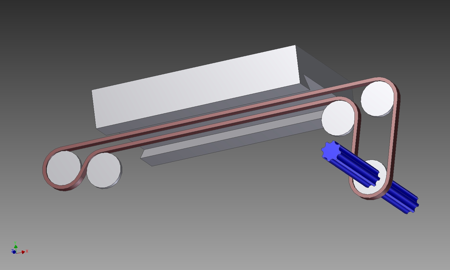

You can't simply put a ballscrew where the leadscrew is without modifying the apron to place a ballnut where the clasp-nut would normally be. The power-shaft becomes redundant, though one option that I have considered is to replace the power shaft with a ball-spline and move the tool slide with a belt or chain drive. This might avoid the common difficulty with fitting a ballnut in the tool slide.
The weakness with this design might be that the torsional stiffness of the splined shaft will decrease as the saddle moves further from the drive end.

On further reflection I think that the splined shaft idea is fundamentally flawed, as any departure from exact straightness in the splines would translate to a diameter error.
