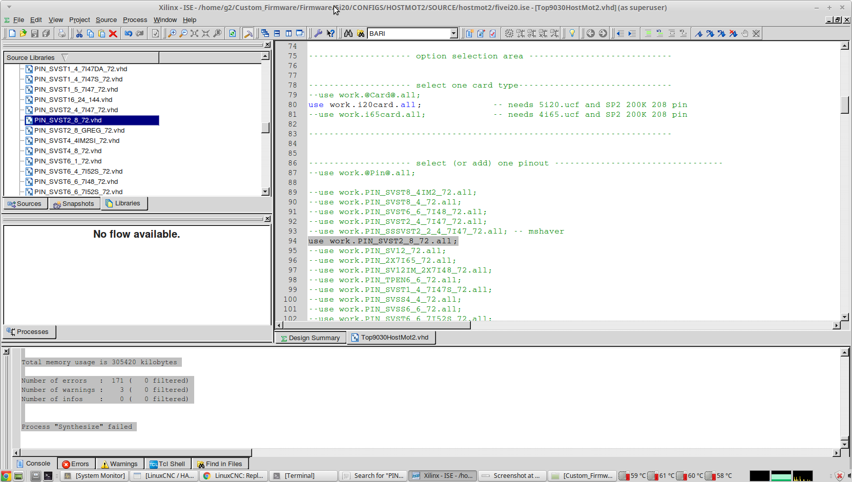

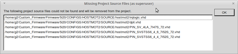

I am trying to make a custom .bit file for my mesa 5i20. I have followed the instructions at
LINK
, which went smoothly. I installed Xilinx-ISE version 9.2.04i (with the service pack 4). When first opening up the project, two files are flagged as missing (see screenshot attached): irqlogic.vhd and dpll.vhd. I found references to this issue searching the web, but the only suggestion I could find was to download the latest firmware from
LINK
, which I did, but the files are still missing. If I ignore the messages and continue: modified the Top9030HostMot2.vhd file to use (uncomment) work.i20card.all and work.PIN_SVST2_8_72.all; (yes, I commented out --use work.@Card@.all; and --use work.@Pin@.all), change synthesis options to speed (instead of area) and try to generate a programming file I get many errors... the log is attached. Eventually I want to make a customized version of PIN_SVST2_8_72.vhd, but I want to at least get the original working first! Any help you can provide would be really appreciated.

12 Mar 2016 16:41 #71519
Replied by PCW on topic Need Help Making a Custom .bit File for 5i20
Do you have a pin and card file defined in the top level file?

Replied by BartyBorris on topic Need Help Making a Custom .bit File for 5i20
Yes. I believe so: use work.i20card.all; and use work.PIN_SVST2_8_72.all;
I am very new to this, so please be patient if this is not the answer to your question.
Yes thats what I was asking
You may need to add PIN_SVST2_8_72 to the project
Just checked, it appears to be there. See attached screen shot.
