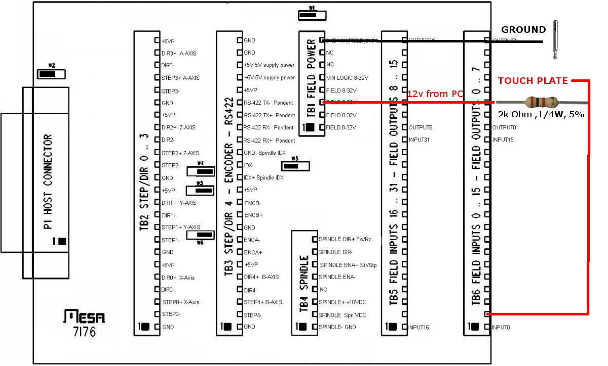

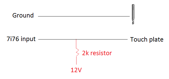

I've got a 7i43 and 7i76.
I want to implement a Z axis touch plate - for tool / workpiece touch off. I've previously done this successfully with a G540 (7xcnc.com/software/probing/z-touch-plate/). I just use a piece of copper PCB with a wire soldered to it. Then I have another wire with a clip on the end, clipped to the tool/spindle. The tool probes down and when it touches the PCB, closes the circuit / triggers the input.
The problem I'm having is the 7i76 has sinking inputs. I'm using 12V field power. My tool is grounded through the spindle back to the VFD. In the current state that means 12V gets shorted to ground.
Can I use a circuit from ground to an input pin and have it trigger?
How should I wire this up?
Thanks,
Nick

One way is to add a say 2K pullup resistor on the 7I76 sense input to 12V
so the 7I76 input will read high until shorted to ground

21 Jun 2016 21:08 - 21 Jun 2016 21:09 #76383
by pippin88
Replied by pippin88 on topic 7i76 and Z axis touch plate (short to ground)
Last edit: 21 Jun 2016 21:09 by pippin88.
- Posts: 18118
- Thank you received: 5336
21 Jun 2016 21:48 #76387
Replied by PCW on topic 7i76 and Z axis touch plate (short to ground)
Yep
- pippin88
- Posts: 263
- Thank you received: 51
22 Jun 2016 06:19 #76411
by pippin88
Works great, thanks.

15 Mar 2018 05:44 #107366
by draganius
Replied by draganius on topic 7i76 and Z axis touch plate (short to ground)
- Posts: 19904
15 Mar 2018 08:53 #107373
Replied by andypugh on topic 7i76 and Z axis touch plate (short to ground)
That should work.
