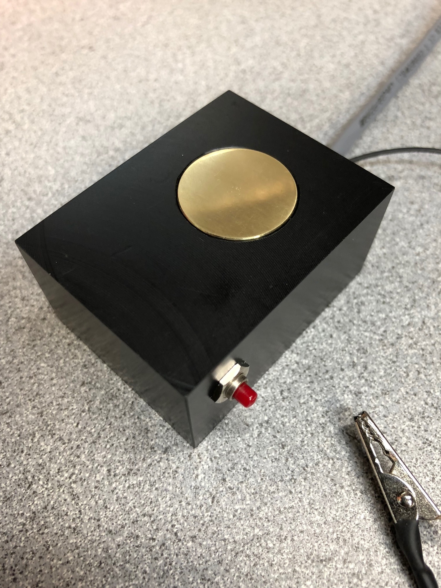

I thought about using a magnet but didn't like the idea of magnetizing my drill bits. I also thought about a wiper that would stick up and I could push it against the bit while it moves down and makes contact. My only fear would be that the sliding contact might cause and inaccurate detection if the connection is broken just at the split second the tool touches down. I do want to put a button on the touch plate to start the probing process.
John
John

20 Mar 2018 21:22 #107650
by JohnnyCNC
Replied by JohnnyCNC on topic 7i76 and Z axis touch plate (short to ground)
- pippin88
- Posts: 263
- Thank you received: 51
21 Mar 2018 05:38 #107653
by pippin88
Replied by pippin88 on topic 7i76 and Z axis touch plate (short to ground)
Nice work JohnnyCNC.
