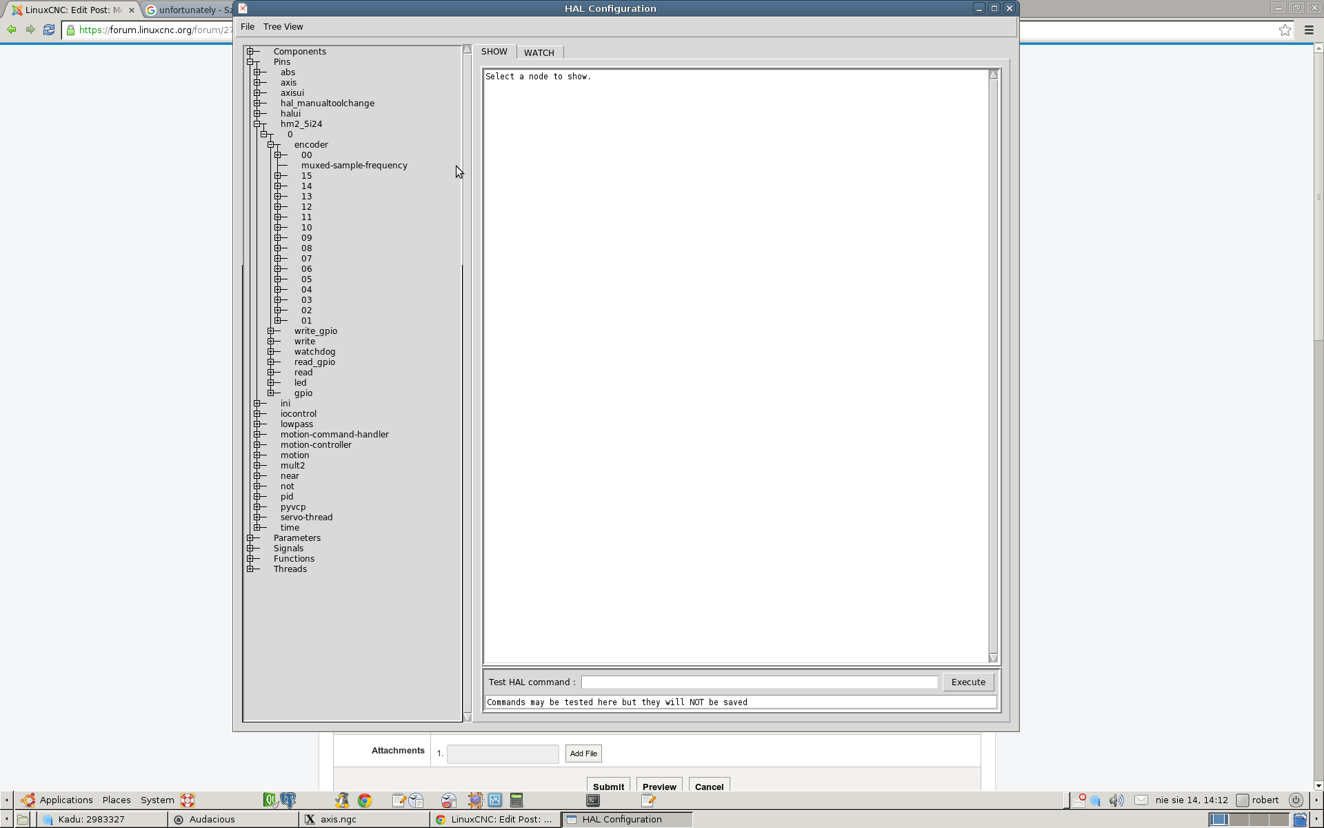

Unfortunately 5i24_16_2x7i65_ss8.bit doesnt work,
encoders dont work, 7i44 doesnt work either,
also I cant see mesa-7i64 pins in hal configuration.

14 Aug 2016 13:21 #78737
Replied by PCW on topic Mesa 5i24 mesaflash : No 5I24 board found
Where do you have the daughterboards connected?

14 Aug 2016 14:38 - 14 Aug 2016 14:39 #78742
by erasmo
Replied by erasmo on topic Mesa 5i24 mesaflash : No 5I24 board found
P2 7i65
P4 7i44
sudo ./mesaflash --device 5i24 --readhmid

- Posts: 18063
- Thank you received: 5308
14 Aug 2016 14:45 #78744
It looks like Mesaflash or the manual is wrong about connector numbers
I would try swapping P2 and P4

14 Aug 2016 15:15 - 14 Aug 2016 15:35 #78752
by erasmo
Yes that was it, after swapping P2 & P4
7i44 - all works fine
7i65 - encoder works fine
After
loadrt mesa_7i65 bspi_chans=hm2_5i24.0.bspi.0
there is still no voltage on phisical pins after setting signal on mesa-7i65.0.analogue.1.out
After
Last edit: 14 Aug 2016 15:35 by erasmo.
- erasmo
- Posts: 20
14 Aug 2016 16:50 #78756
by erasmo
I can't get analog voltages working.

14 Aug 2016 19:53 #78762
Do you have the 7I65 component loaded?

Yes I loaded component using
component loaded succesfully but that did not change anything
still no voltage on AOUT0, AOUT1... etc, pins
