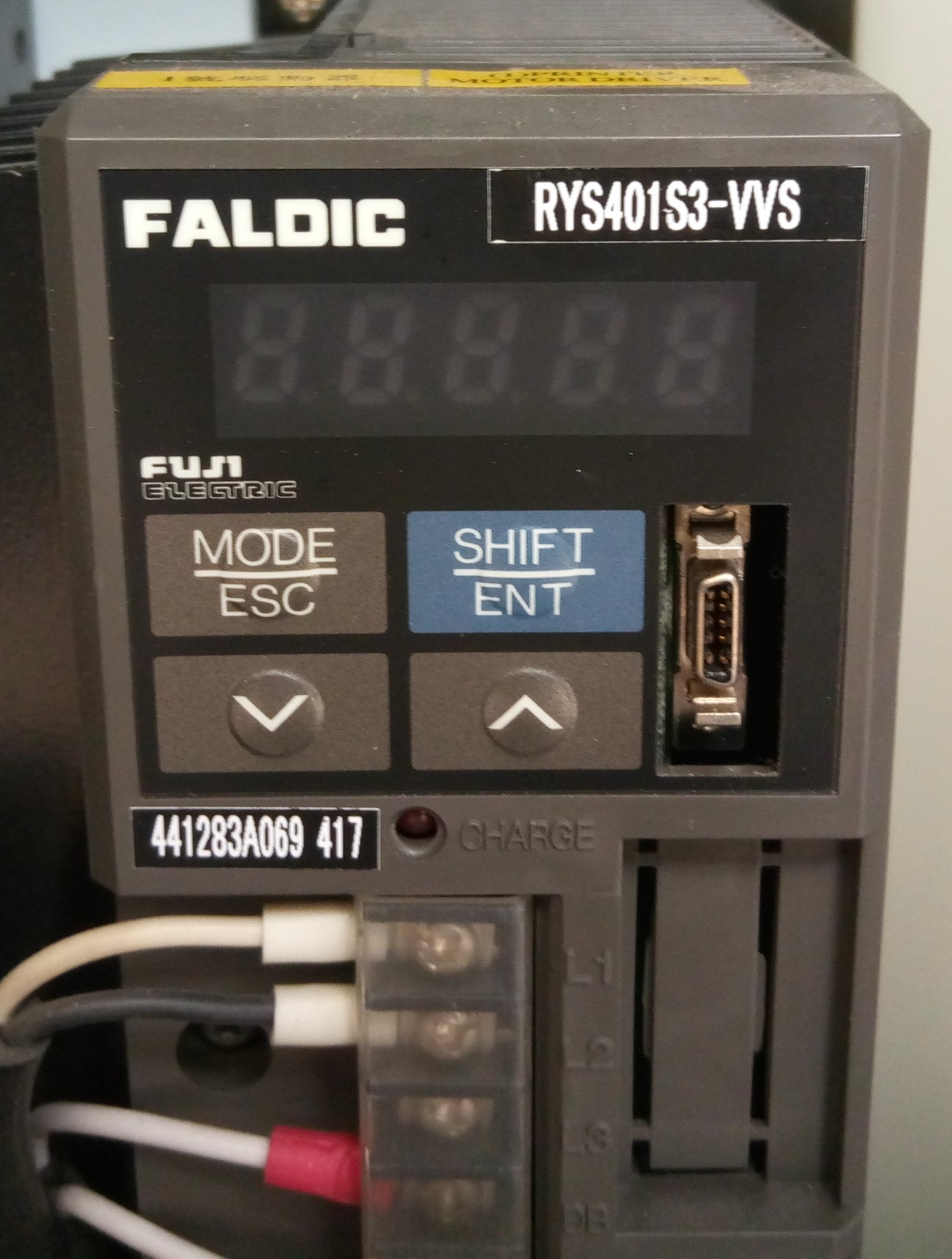

by Vladimir
Faldic RYS401S3-VVS and LinuxCNC was created by Vladimir

Replied by PCW on topic Faldic RYS401S3-VVS and LinuxCNC
That looks like a standard AC servo (400W) that will work with analog or step/dir commands
so will work with General Mechatronics, Mesa Electronics or Pico Systems LinuxCNC drive interfaces

Replied by andypugh on topic Faldic RYS401S3-VVS and LinuxCNC
Or, I would assume, in step-dir mode from the parallel port, but at limited step rate.

Replied by Vladimir on topic Faldic RYS401S3-VVS and LinuxCNC
There is no step/dir support on this driver, only cw/ccw signals, speed control or torque control.
If it will work with CW/CCW pulses then that is an option with the parallel port and software step-generator.
[Edit] I am not advocating this over the hardware solutions. Just pointing out the possibility.
