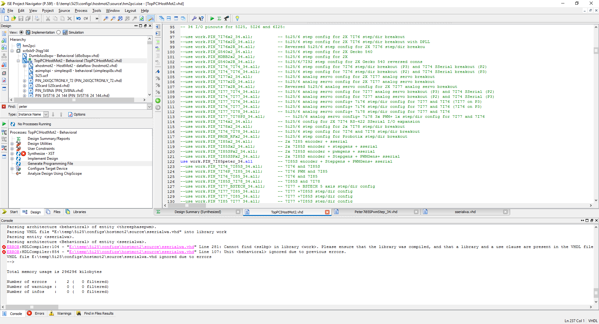

Hello,
I have been trying to make my own version of PIN_7I85SPx2_34.vhd using ISE Design Suite 14.5 and have run in to a snag.
I'm following the guide here: wiki.linuxcnc.org/cgi-bin/wiki.pl?Editing_MESA_Bitfiles .
So far i have changed the original file so it accepts 2xPWM/DIR and 2xstepgens and Sserial.
I managed to add it to the project and it passes syntax check.
When trying to "Generate Programming File" it runs for a while, and then stopped with errors regarding the sserialwa.vhd file (see attached picture).
I'm really at a loss at this (First try at even looking at a FPGA)
Is there something obvious I have messed up? Any help would be very appreciated.
Screenshot of the error and the .vhd file attached (which is renamed to.txt to be able to upload) .
/Peter

- Posts: 18104
- Thank you received: 5328
10 Sep 2016 17:39 #80302
Replied by PCW on topic Problem modifing .bit file
Try adding sslbprom43.vhd to the project sources

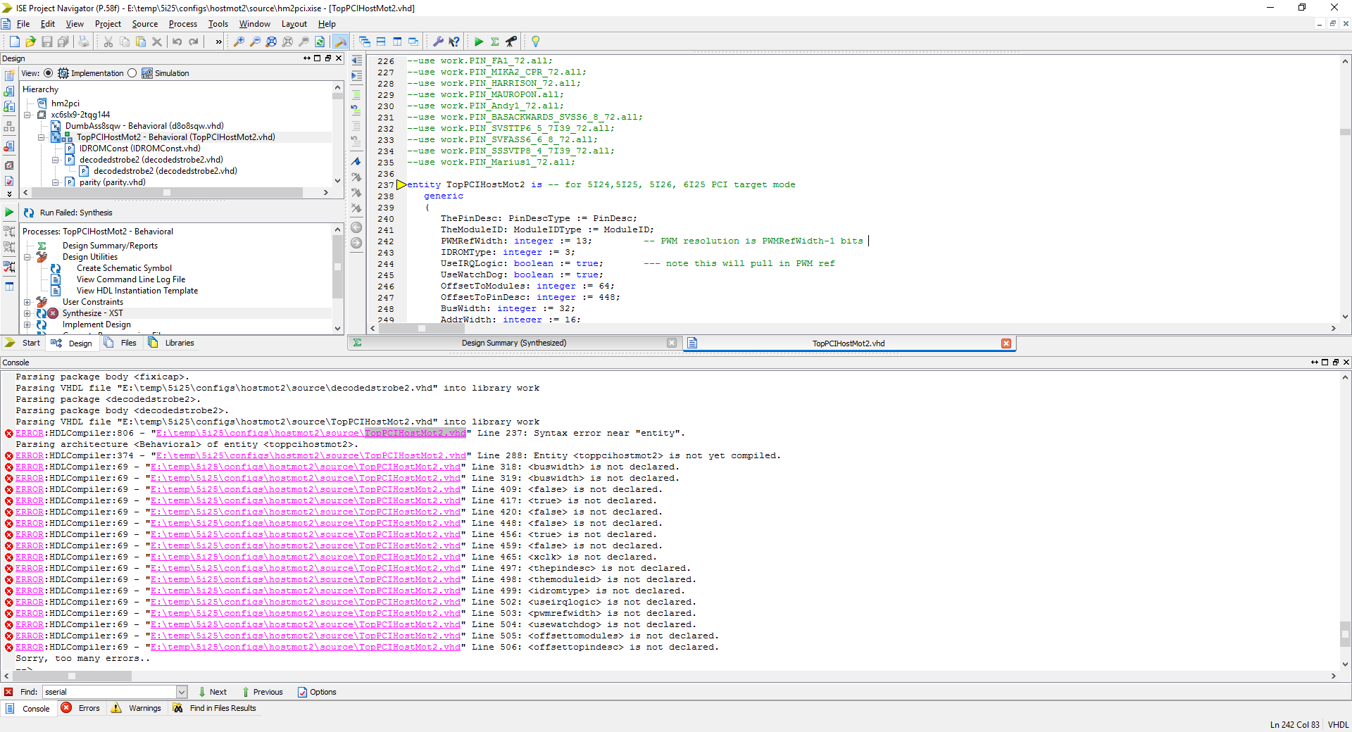

10 Sep 2016 18:05 #80304
by pommen
Replied by pommen on topic Problem modifing .bit file
Thank you for that tip, it got me further.
I ran in another similar issue with FixICap. after I added that one aswell i got a new error (attached). It says something(I think) about Syntax error in TopPCIHostMot2.vhd. Any idea where I should start looking?

- Posts: 18104
10 Sep 2016 18:27 #80308
do you have a card type declared?

10 Sep 2016 18:37 #80310
by pommen
I have uncommented:
use work.i25_x9card.all; -- needs 5i25.ucf and SP6 x9 144 pin
at the top of TopPCIHostMot2.vhd
in trying to use another PIN file it seems to be working, so I'm guessing that its my modified file that's the problem. I did run a syntax check on it that passed. So I probably bummed something up in editing the file(attached and renamed to .txt).
