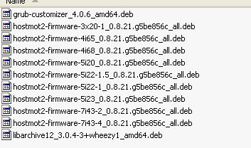

I am trying to get mesa 5i25 board working but it does not. After much work I got feeling that maybe I was missing a driver. I installed mesaflash to check board and it says "no hostmot2 firmware found". I kind of expected that.
I am running lmde2 on a amd64. I found a iso on this forum that installed 3.18.13-rt10mah preempt-rt and linuxcnc. after update I am at linuxcnc 2.7.7-21. I looked in the iso and under deb folder it installed these files.
I notice that no file for 5i25 and when I search synaptic also no 5i25 hostmot file found . I have searched internet and can not find firmware deb file for 5i25. Can someone tell me where 5i25 firmware file can be found or how to load it?
My linux is very poor, so if it is a big task to find firmware file I would need very simple instructions. Thank you.
