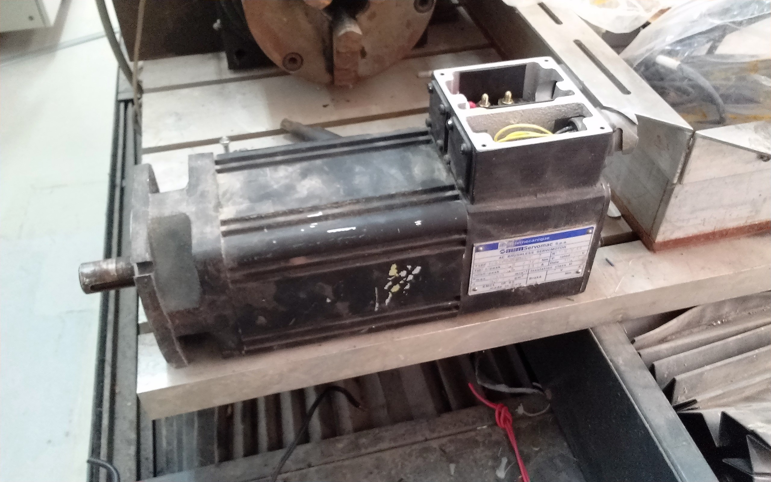

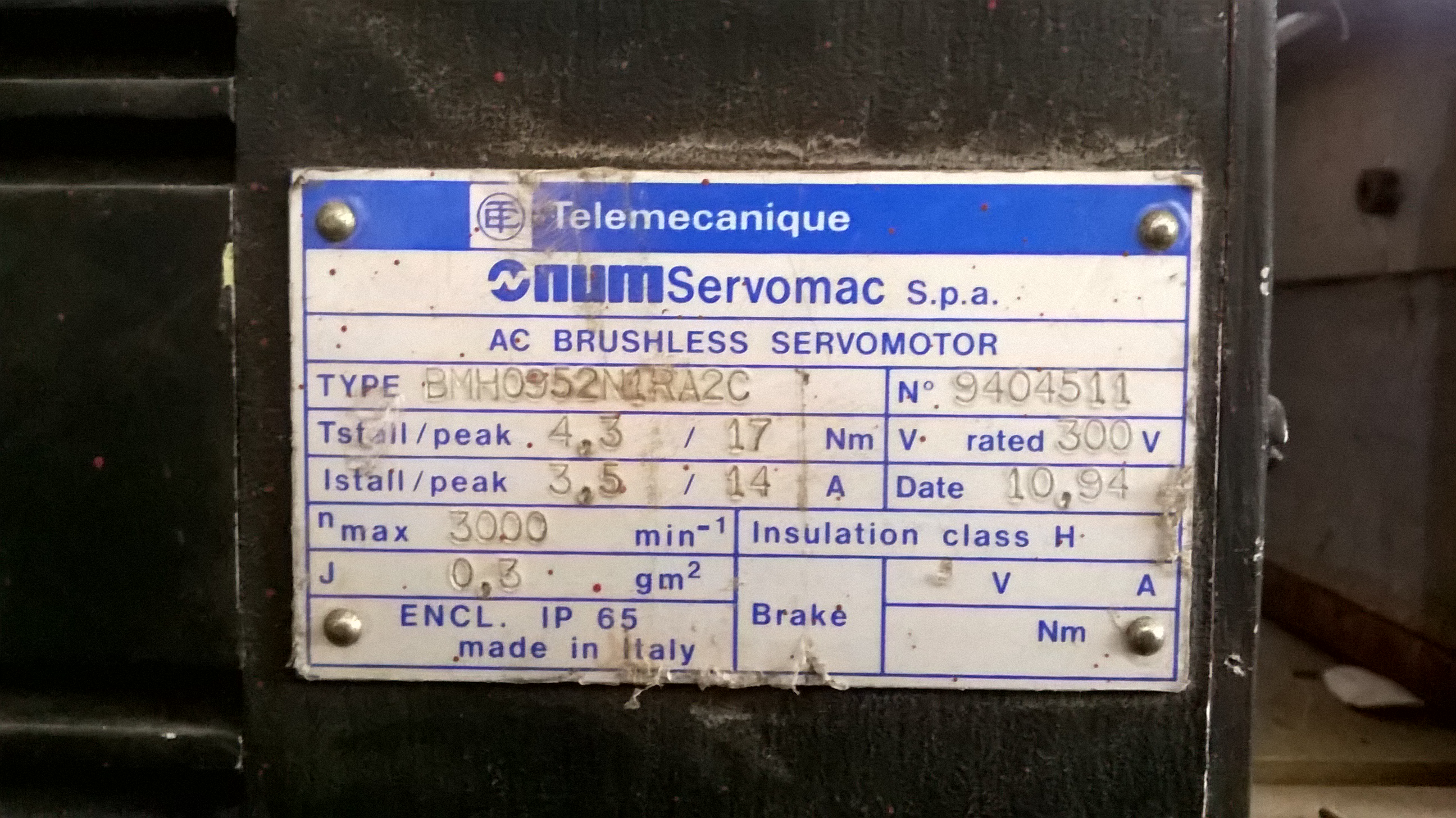

The machine i m working on is an old 4-axis laser cutter that uses NUM 3-phase AC BMH Servos, driven by NUM servomac Monodrives. The original system was controlled via plc which is no longer available. My project is about controlling the motion (just the motion of the 3 axes, XYZ and maybe the 4th one if possible, the laser system is a whole other story) with linuxcnc.
The servo drives use +-10V analog control (no step/dir), so I am thinking of ordering the plug n' go kit 5i25 & 7i77 from mesa electronics to interface to a pc that runs linuxcnc.
