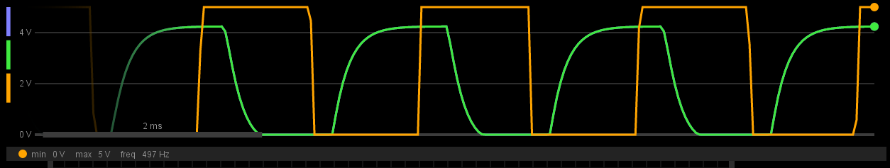

27 Dec 2016 09:01 - 27 Dec 2016 09:03 #84748
by LS
Replied by LS on topic Need help with TB6560
After some further analysis, it appears they are trying to control torque by the CLK (STEP) input.
[Refer to attachment]
Orange = CLK
Green = TQ1 & TQ2
TQ1/TQ2 HIGH = 20% torque
TQ1/TQ2 LOW = 100% torque
For the TB6560, stepping occurs on the rising-edge of CLK. The confusing part of all this is that every CLK rising-edge, the torque is at 20%...
Maybe there a fault in their circuit?
Orange = CLK
Green = TQ1 & TQ2
Last edit: 27 Dec 2016 09:03 by LS.

27 Dec 2016 10:59 #84755
It's not impossible. Though they seem to have a lot more of the circuit than is normal, and this might be a sign that they are trying to do a good job.
There is an RC network with an 8µS time constant on the TQ inputs, but that seems too short for a current-lowering circuit (which many drivers use).
Replied by andypugh on topic Need help with TB6560

27 Dec 2016 22:11 #84785
by LS
Today I used the DMM to perform some basic logic checks on the circuit board. The circuit logic appears to be correct, so it's more likely there's a bug in the schematic diagram instead.
The torque is minimised while idle (CLK=HIGH; TQ=HIGH. When a step command is issued, the CLK goes LOW, which brings TQ LOW (increasing torque), then on the rising edge of CLK a step occurs. I'd say the 8µS time constant holds the torque pin LOW (100% torque) after the rising-edge clock to ensure there is full torque throughout the step action. I'd need to borrow a logic analyser to watch whats going on during operation .. a job for another day.
To answer the original question .. the step pins are active-high.
Cheers
Luke
Cheers
Luke
