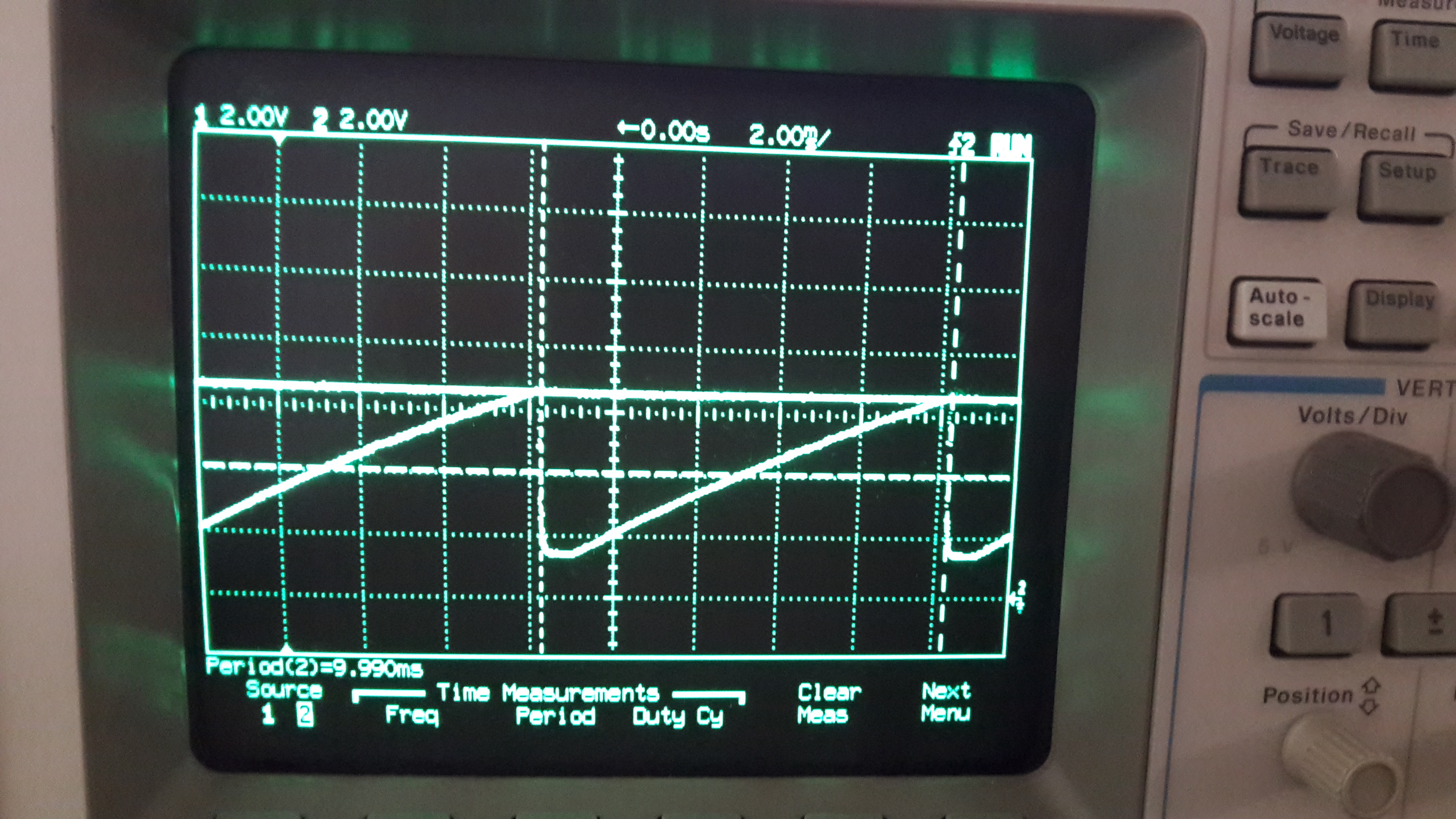

I am heaving problem with my Indramat 3TRM2 driver ( manual ).
The Axis2 dc motor oscillates back and forward rapidly when 0V dc control voltage is applied. If I apply some DC voltage, the motor rotates, but still oscillates (changes its velocity). Please see tacho signal at 0V control signal (attachment1)
The Axis1 has the same dc motor, which runs fine and smooth. I exchanged the motors of axis 1 and 2, and the problem moved to motor1 and the motor2 ran smooth. So I assume the problem lies in the controller, not the motor/tacho.

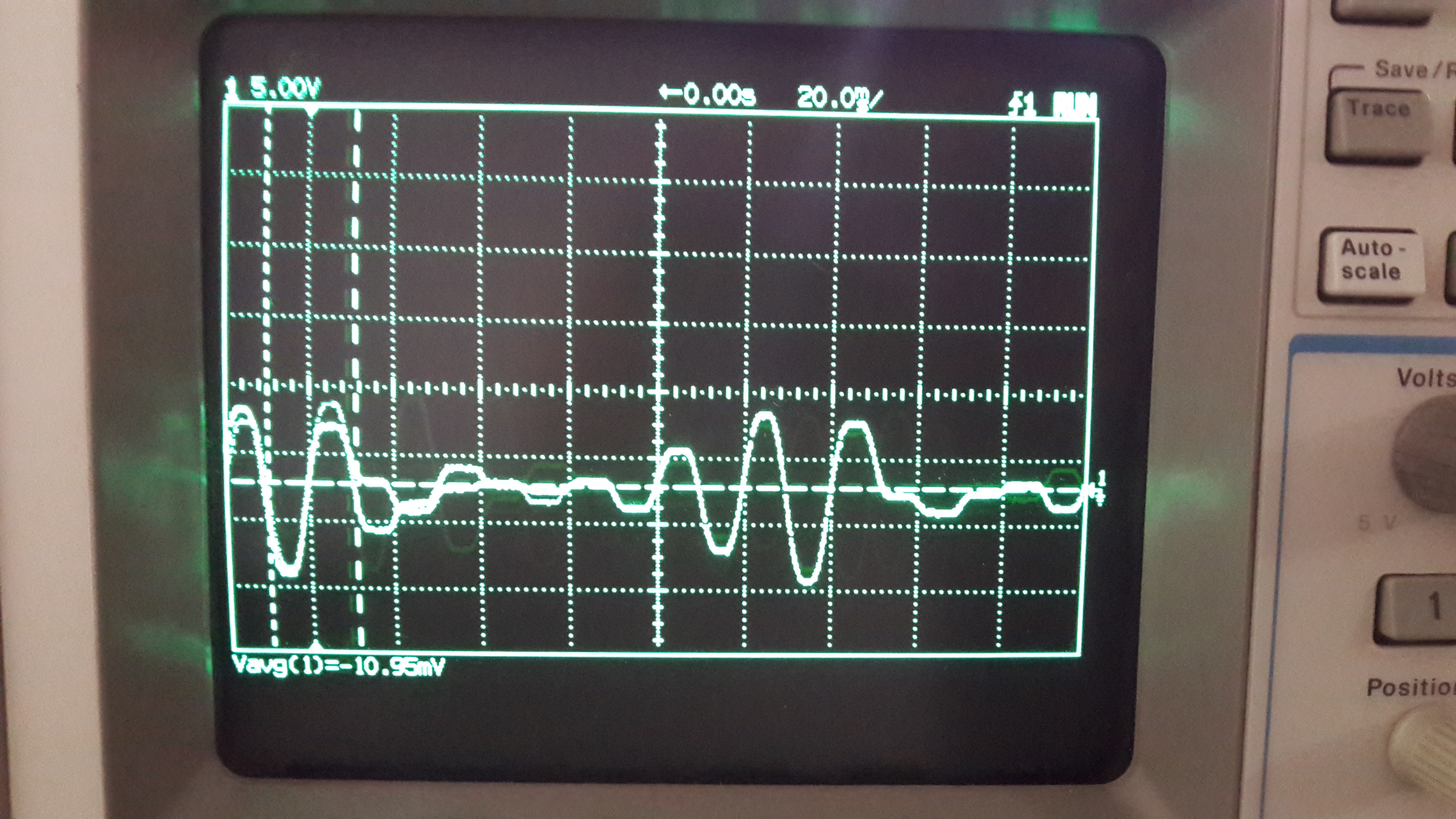

Than i noticed the chapter 3.7 (in the manual), that is describing the exactly the same behaviour - the problem seems to be the pre-current setting. I did as described - I short the TP103 and measure TP114:
- on Axis1 (which runs fine) i get a constant -0,7V.
- on Axis2 (which oscillates) i get the signal which seems just fine and which i was expecting to see on axis1 (attachment2).
Does anybody have an idea what could cause the motor oscillation?
Does anybody have an idea why am i getting such signals form TP114 and TP214.

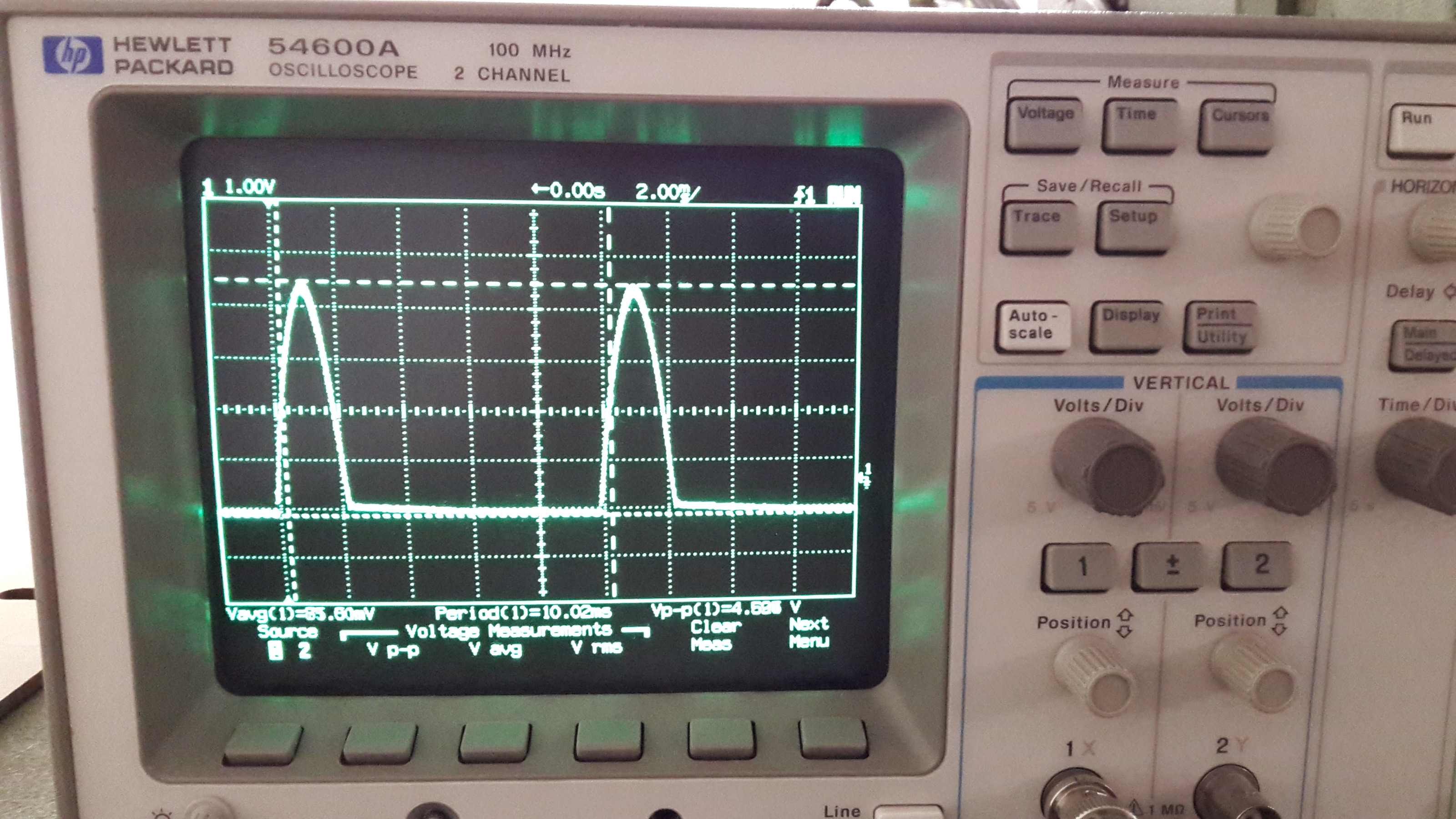

Heh, I found the solution, it is described in paragraph 2.9. I don't know why they split this section to two parts.

Ok, a attached the before and after oscilloscope image, maybe someone will find it useful.
