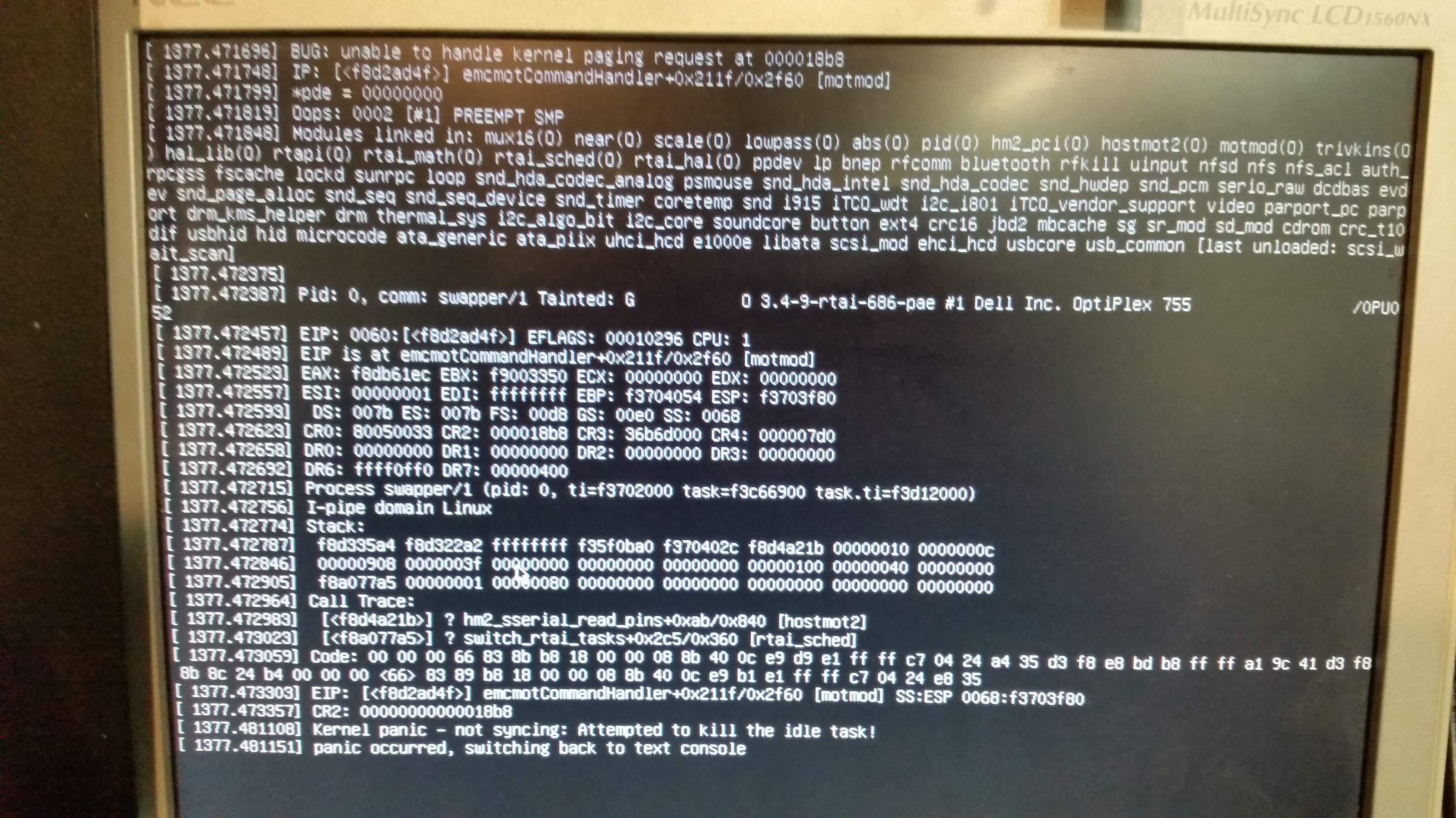

I'm in the process of wiring/configuring my 7i77 and experienced a shut down of linuxcnc. See the attached screen notification.
I did a memory test for over an hour and all checked out okay. I was able to replicate the shut down 3 times when using the up/down keyboard keys to rapidly change direction then hitting home and end key. I think it was the end key that triggered the black screen and or a combination of page down and end. I noticed this when testing the Z axis.
Can anyone else replicate this??

That looks like hardware problem, so the first thing i would do is change the computer, or at least the power supply on that computer. But that is a Dell optiplex 755 so it is hard to find a working power supply for them.
Open the case and check the capacitors, they tend to go bad, the top starts to swell. They should all be flat topped. In case they are swollen, change the computer.
That might also be a bad pci contact (if using 5i25 or 6i25), as it happened reading the sserial port.

Is it always the same error and same place? (in emcmotCommandHandler)
if so that does suggest software a bit more than hardware.
A simple brute force hardware test would be to use another PC just for a quick verification
(just swap hard drive and FPGA card)

Ohh, a Dell 755, I think it might have the i810 chipset, or descendant. I had occasional problems with a graphics crash on an Optiplex GX260 with the i810. It never happened with the Ubuntu 8.04 LinuxCNC, happened occasionally with the Ubuntu 10.04 LinuxCNC, but became a HUGE problem with the Debian LinuxCNC. Several people recommended hacks to the X11 config files, but they didn't fix it. In all these cases, the kernel would stay up, but the graphics would go haywire and X would shut down. (That doesn't exactly match your result, you seem to have a kernel panic.)
Anyway, the fix I finally had to go with was to get an Nvidia graphics card and disable the on-board graphics. Have not had any problems with the system since. There is quite a bit of documented problems with the Intel graphics chips with later kernels, if you look around. This not only applies to the i810, but several later integrated graphics chips.

Just tested on my laptop (dell e6510, mint17.3, preempt-rt) , no crash no matter what i do with up/down/home/end buttons. Will try tomorrow on the actual machine and report back.
In the mean time, did you have a look at the capacitors? If they are swollen, no advice will help. If they are all nice and flat, see bellow.
Since it is a recurring error, do open the case and remove all but one memory cards, start the computer and try to induce the error, try this with all the memory cards you have separately. Always put the memory on the slot nearest to processor. If they all fail, try the next slot and so forth.
If you get the same result with more that 2 memory cards, chances are the memory controller on the north bridge is gone the way of the do do.
