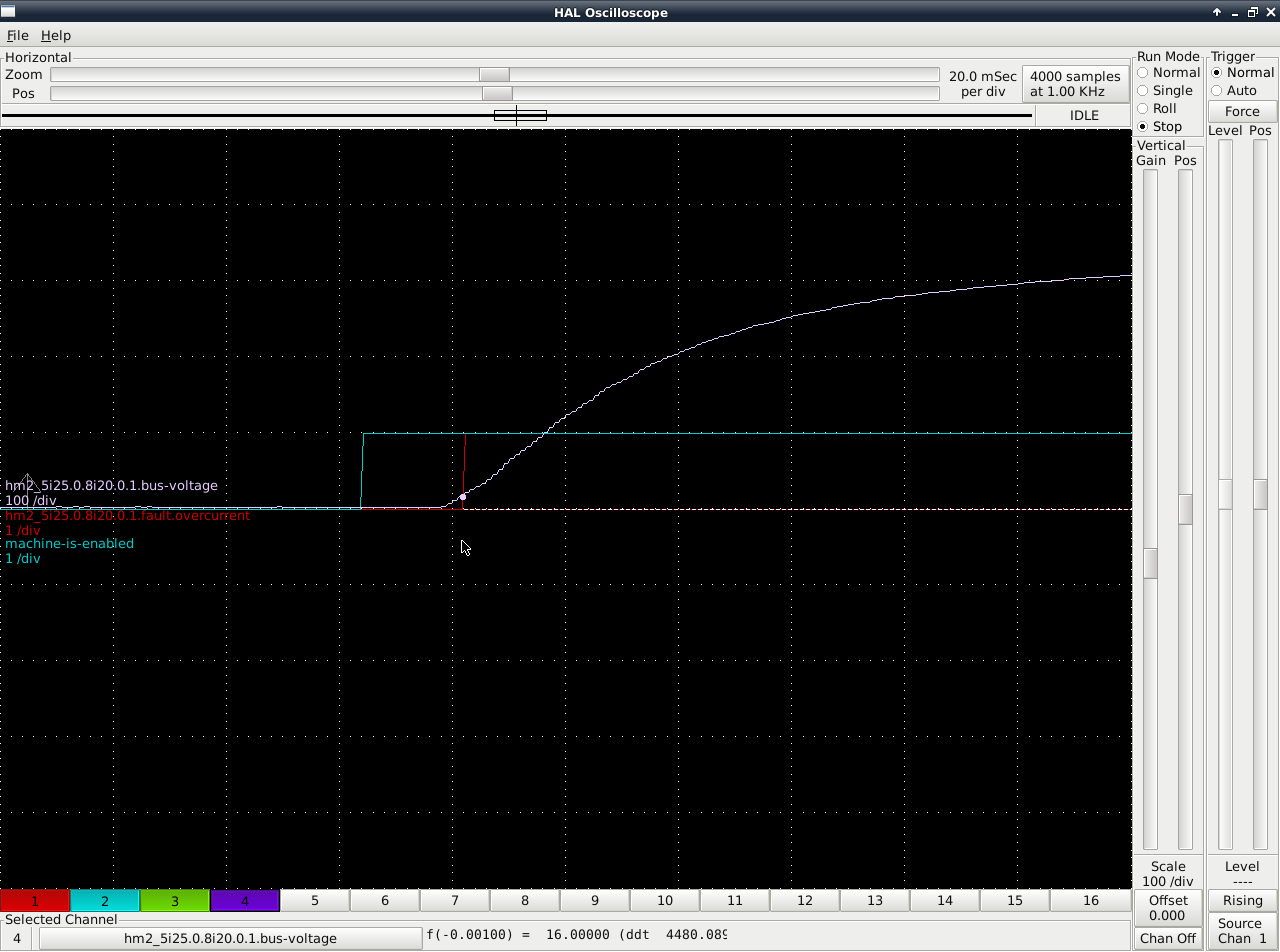

18 Jan 2017 02:02 #86022
by ZincBoy
I have attached a screen shot of the halscope showing how the error occurs. This is using a test hal file I am using to tune the drive. The machine-is-enabled signal turns on the contactor that connects power to the drive through the soft start PTC device.
It looks like the hm2_5i25.0.8i20.0.1.fault.overcurrent triggers when the bus voltage hits about 16V. The same sequence when the bus voltage is charged does not trigger the overcurrent flag.
The firmware revision as reported by hm2_5i25.0.8i20.0.1.swrevision is 139 (0x8B).

- Posts: 18117
- Thank you received: 5335
18 Jan 2017 14:37 #86053
Replied by PCW on topic 8i20 cold start over current error
in enable false when you start?

19 Jan 2017 02:26 #86121
by ZincBoy
I double checked and the enable input on the connector is low when halrun is started and the script is loaded. It is enabled 2 seconds after bus power is connected. I checked both with a multimeter and halscope and the enable input was low until commanded. I also checked for glitches during init and saw nothing on the enable pin as well.
Once I run the "addf hm2_5i25.0.write thread1" command the fault light on the drive turns off and the status led starts blinking showing communication. It seems like the drive faults are cleared at this point and inspecting the fault pins on the 8i20 in halmeter show everything as no fault.
When bus power is enabled, the fault light turns on with overcurrent flag and the status led keeps blinking as expected.

19 Jan 2017 02:41 - 19 Jan 2017 03:01 #86122
I mean in a normal linuxcnc startup, when is the 8i20 enable set true (and when do you get the fault)
If I get a chance this week I'll check into the firmware rev and see if i can duplicate the issue
What's expected to happen is that enable being false masks any undervoltage or current faults
Last edit: 19 Jan 2017 03:01 by PCW.
