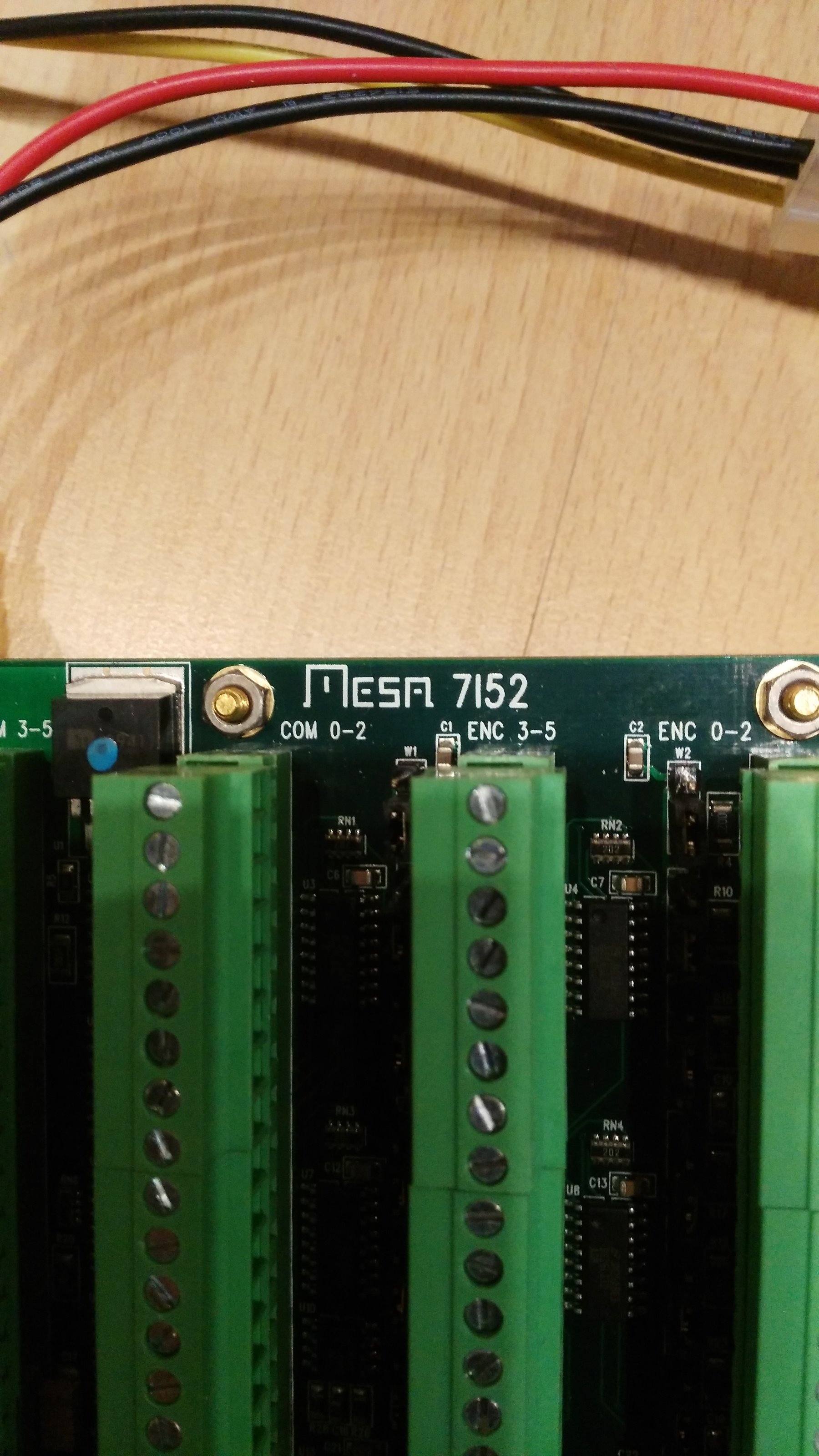

I need your help to find the right bitfile for 5i24_16 to connect to 1 7i52 and 1 7i76.
I have 5 stepper motor, 1 spindle with encoder and 2 encoder for the A- and C-axis.
Thanks in advance.

Replied by PCW on topic 5i24 + 7i52 + 7i76 Bitfile
Are you sure you have a 7I52 (not a 7I52S)?
Its possible to make this configuration but you need to adapt the 7I76 to the 50 pin cable from the 5I24
We have a cable adapter for this, if you make your own, I would suggest you do it the same way
50 HDR DB25
Both the 7I52 and the 7I52S have the same "7I52" on the PCB
There is a sticker on the back of the card with the actual part number
(I would expect you have a 7I52S since a 7I52 is not intended to drive steppers)

22 Jan 2017 17:44 #86414
by Ludwig
Replied by Ludwig on topic 5i24 + 7i52 + 7i76 Bitfile
See the back side of the board.
The stepper are connect to the 7i76 and also the spindle and spindle-encoder.
The 7i52 is only for the axis Encoder.
I try to make by myself the bitfile, but till now I am not able to do this.
